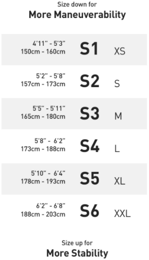

I own a 2022 Levo expert S3. I’m 5’6 with a long torso and short legs. My wingspan is about 5’8.
When I went through the sizing app thing on the specialized site it said I should get an s2. I was mystified by specialized geometry because every other new bike my size has 450 reach and the s2 has 435 reach.
My last bike was a medium 2018 Moustache with 435 reach and it sometimes felt cramped to me. It had what I felt was short reach and super long (460) chain stay and I felt the geometry was out dated.
I felt like I would love longer reach and shorter chain stay. I thought I knew better than specialized and that I needed the S3. I test rode an S3 and it felt big but good. I couldn’t ride an s2 because there were none near me.
After riding my S3 about 200 miles I now think I messed up and should have bought the s2, and that I shouldn’t have been so stuck on the reach measurement. The stand over height on these bikes is pretty tall, and they just feel big.
I rode with a friend who is about 5’8 and has an s3 Levo and he is a much better rider than I am but it just looks like he can maneuver the bike a lot easier than I can.
I’m a life long cyclist having ridden bmx bikes til I basically couldn’t any more due to age and infirmity (I’m 45 and have some nagging old injuries) so it’s not like I lack bike handling skills.
I think I could ride an s2 with much more agility but because I couldn’t actually ride one I’m just left wondering. Should I sell my new bike and get an s2? Should I just ride my S3 and learn to maneuver a bigger bike?
I have put a 40mm stem on and cut my bars down to 770, but the bike still feels tall and long. I like riding up (and down) very steep challenging single track that many people only ride down.
Downhill my bike feels great, but on the challenging uphills I’m finding it difficult to hop my rear end over slippery logs etc because the bike is so big.
It’s possible that I’m just not as good of a rider as I think I am and that my bike fits me fine and that I need to stop whining.
I just don’t know because I’ve only ridden mountain bikes since 2016 and I don’t really know how mountain bikes are supposed to fit.

Yes I think you are over thinking it, (we're all guilty of it when we've spent a lot of money).
At 5'6" I think you can comfortably ride an S3.
You just need to get used to it after your old bike.

I am about 5'7 and similarly sized. A Medium felt cramped, so I went with a Large (2020 Turbo Comp HT). Go with the bigger bike, it will be fine.

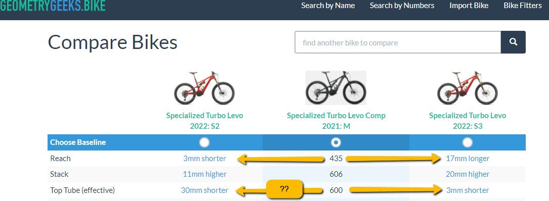

I'm 5'9"/175CM and a couple years back YT convinced me I needed a large (Decoy), 455 reach if I remember right. I kind of fell into this "new" size standard when I sold the Decoy and got a Levo SL in large as well, 455 reach and it seemed great at first. As it happens a buddy of mine was selling a M SL (435 reach) and let me ride it for about a week, it wasn't until this point I really figured out that M suits me better, so I sold the SL in L.
On the medium I bumped up the stem from 45mm to 50mm and put the seat favoring rearward on rails. Result for me is a quicker handling bike but not cramped either. To me no distinguishable performance in decending or climbing on either size, but M standover advantage for my 30" inseam, medium definatley more manuverable.
Now I'm in the market for Gen3 Levo and am very confused by new S sizing because an S2 is now effectively the same as last year's M even though they now consider it size SMALL (S2=432 reach, last year's M = 435mm). By "new" sizing I'm an S3/M 452mm reach (last year's L 455mm reach). My best guess is that an S2 will be my size but I really need to try them out back to back. The last thing I want is a bike that feels big, especially with the added weight on FF Levos but don't want to feel cramped in the cockpit either.
Definately feel skeptical of the new sizing the bike industry is pushing.

At 5 9 you will be a medium.
I'm about your height and rode a 2020 Levo in medium for a few years.
Friend has just bought a 2021 levo in size s3.
I rode it and despite what the numbers say, it didn't feel any bigger.
Go s3.

I'm actually riding/selling my Gen2 Levo comp medium right now (did not mention in previous post).
It is set up mullet with flipchip high, 40mm stem and 30mm rise bars @ 790. It feels good, HTA approx 64 degrees. Selling because I really want shorter chainstays and as close a feel to my Levo SL as possible but with full power. Trying for Sworks frameset to hopefully land around 49lbs with my build.
Still confused by the sizing, both most previous replies are opposite in opinion.
What throws me off is the "effective top tube length", that measurement is a lot shorter on S2 than 2021 M.
Not sure how to interpret this difference, trouble is finding an actual store in my area that has both S2/S3 levos.

I was just comparing reach which is similar between the old medium and the new S2. I’m not really sure how top tube length matters now that seat tubes are steeper and reach is the measurement more commonly used. Please enlighten me if I’m missing something. I’m not an expert on any of this stuff. Maybe the “effective top tube” length is what makes the S3 closer in feeling to the medium than an S2. Another thing to take into account is that, as far as I know, all Gen 3 carbon frames are the same, unlike gen2. So whether you are buying an Expert complete or an s works frame, you are getting the same frame.

The best compare and visualize can be seen at:
Try the S3 size, compare it to S4, but it depends what you will ride. But my suggestion to you is S3.
Sorry for the long rambling incoherent post
I’m 5”6 and ride an S2 Kenevo and it’s perfect because I feel like I’m in control of the bike and can also move it about with ease.
