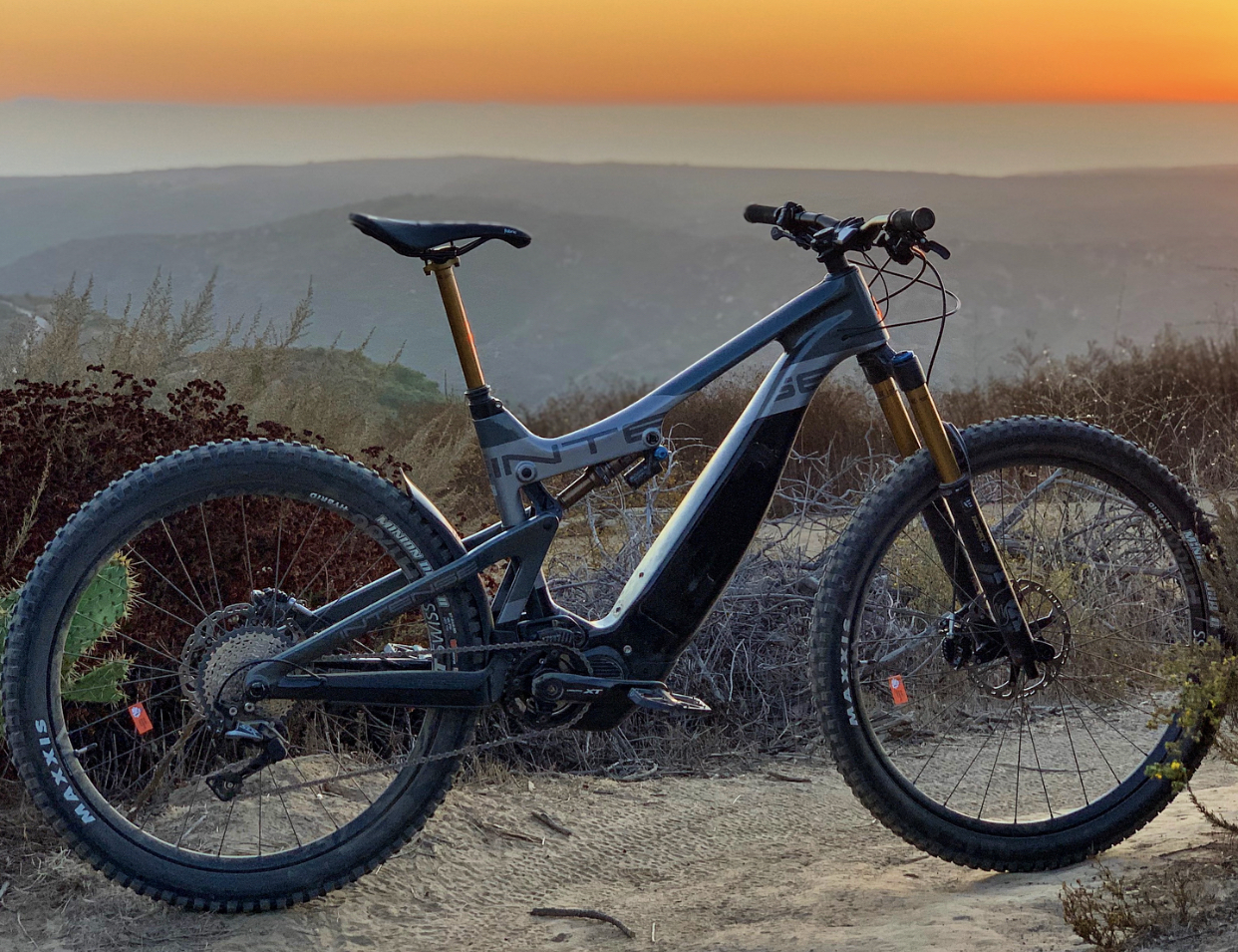

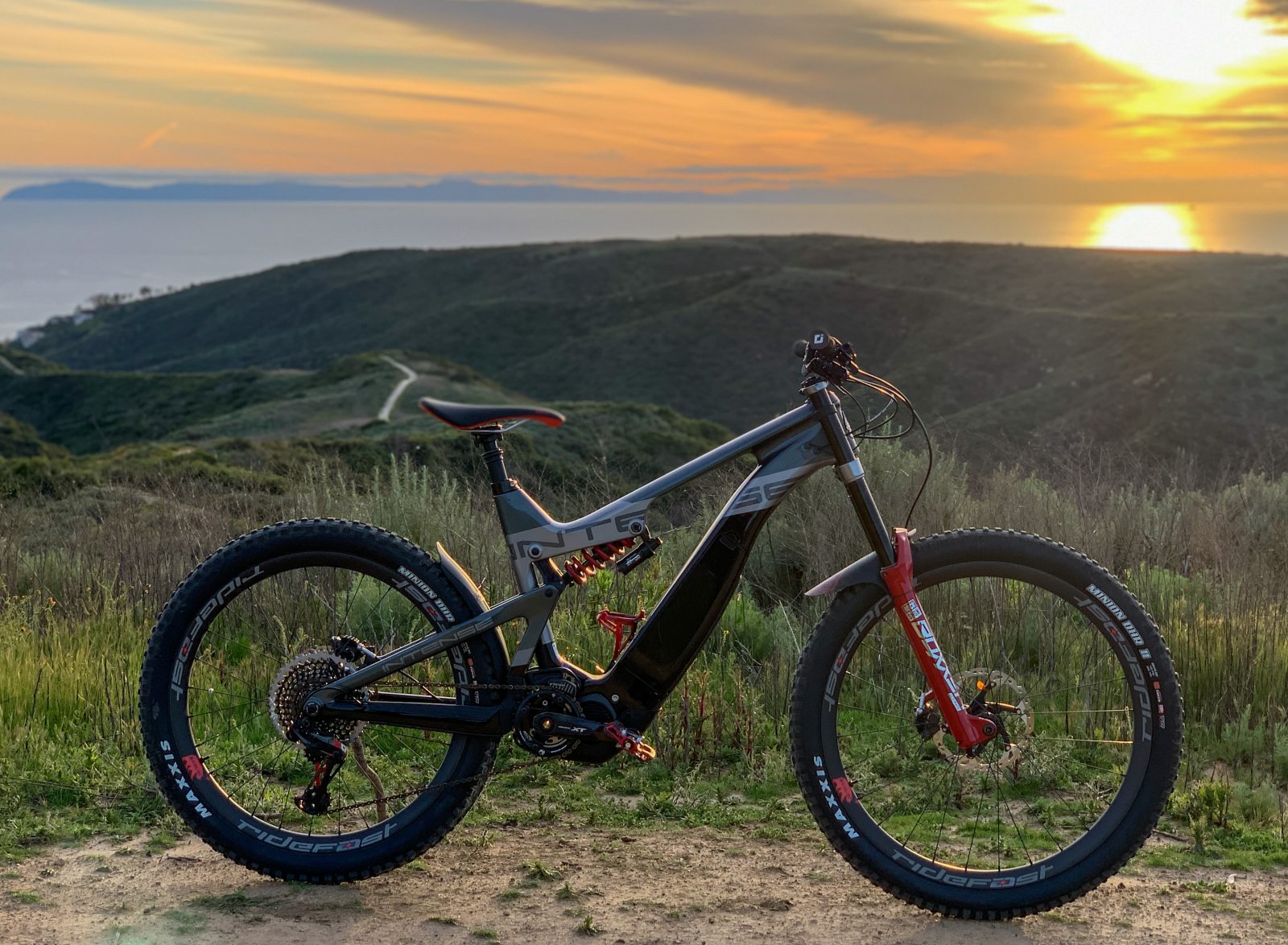

Fast forward a few months to January 2020 when I was finally able to get my hands on an XL and of course being me and loving custom built bikes I immediately stripped it down and completely custom built it back up with carbon wheels, a coil rear shock, and a dual crown fork lowered to 180. The bike set up this way was really rad and definitely a head turner but to be honest it didn't feel as good as the bone stock Large pro build I owned before. I think a big part of this was I couldn't get a heavy enough coil srping for my weight and a fairly short stroke shock, I had a 650 and probably needed a 725.
Fast forward again to May 2020 with the release of the Fox 38 and I rebuilt the bike again and this time it was truly something special. Put the stock Float X2 that came with the bike back on along with a new Fox 38 and some new custom build carbon wheels and this time teh bike was an absolute rocket ship right out of the box. I had purchased the fork at 160 because that was all that was left with the intention of upping it to 170 but I later realized that the bike feels too balanced with the fork at 160 and decided I didn't want to mess with the geometry at all.

you got a side on pic of the dual crown build,, very tasty. I like the Tazer, but in the UK at least they did it in a horrific colour way ! Yours looks much better.
