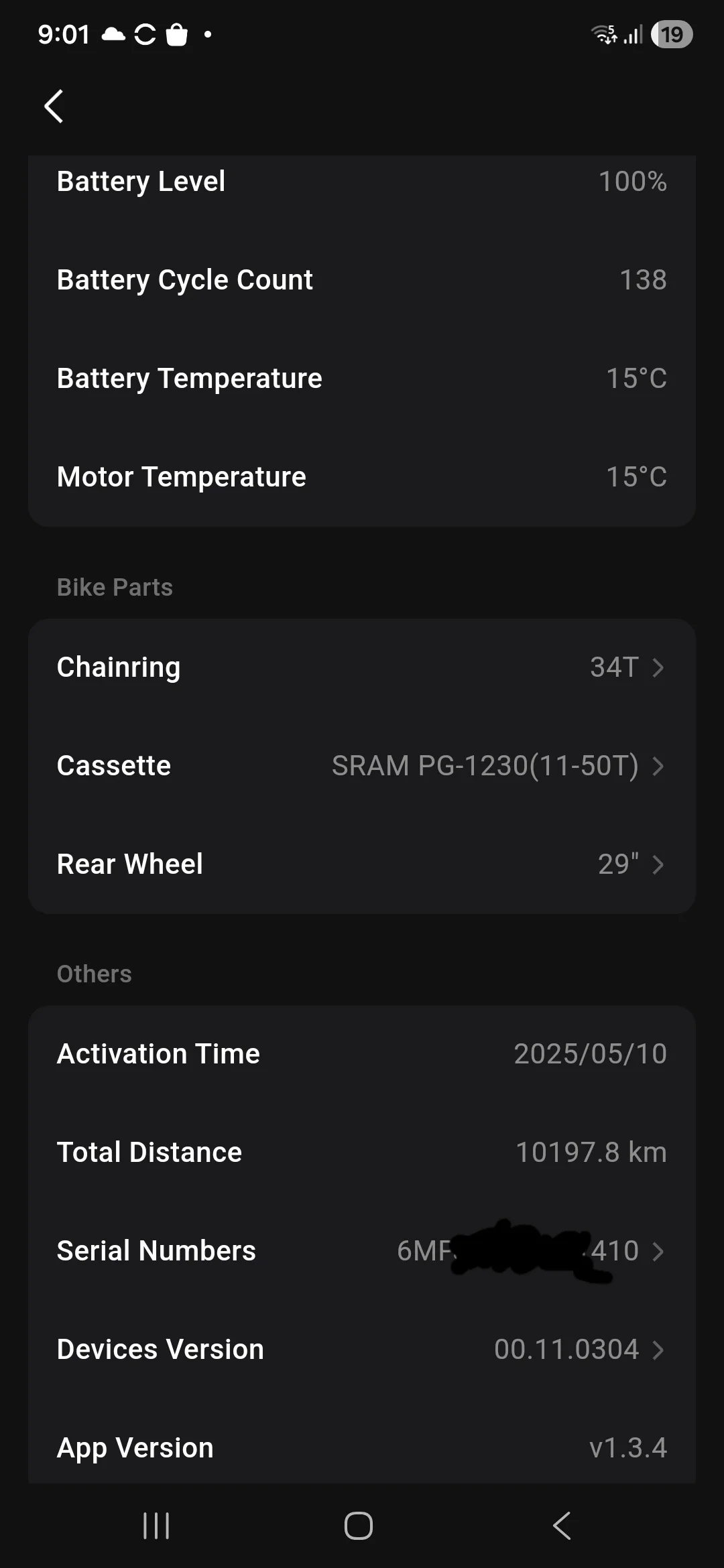

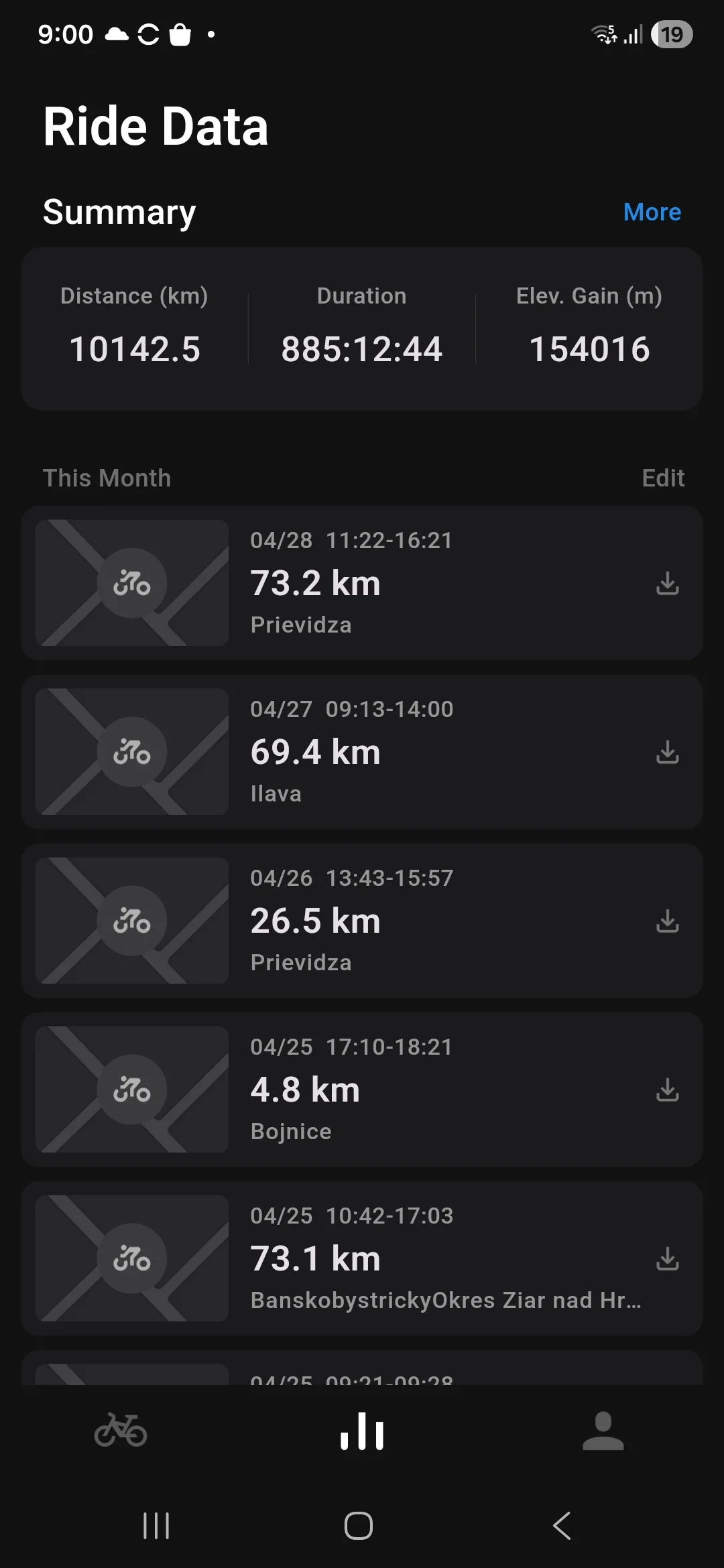

I have a silver PL. May 21st it will be 1 year. The engine is quiet, nothing rattles in it. Without any malfunction. I only change the chains and brake pads.
I have a silver PL. May 21st it will be 1 year. The engine is quiet, nothing rattles in it. Without any malfunction. I only change the chains and brake pads. 183319 183320
Nearly a year, quiet motor, zero mechanical failures, just chains and pads. That's exactly the reliability story that the M1 needed to build.
Given you've also put 9,500km on it with 140,000m of climbing in under 11 months, that's not a casual shakedown either. The motor's been working hard and apparently doesn't mind. A silver PL is a decent looking machine too, if the photos are anything to go by.
The "only chains and brake pads" maintenance record is also worth noting for context: with 32,700km on your previous Scott Genius eRide before motor trouble, you clearly know how to look after a drivetrain. So this isn't luck, but it's still a good result.
May 21st will be worth marking. One year, serious kilometres, no drama.
