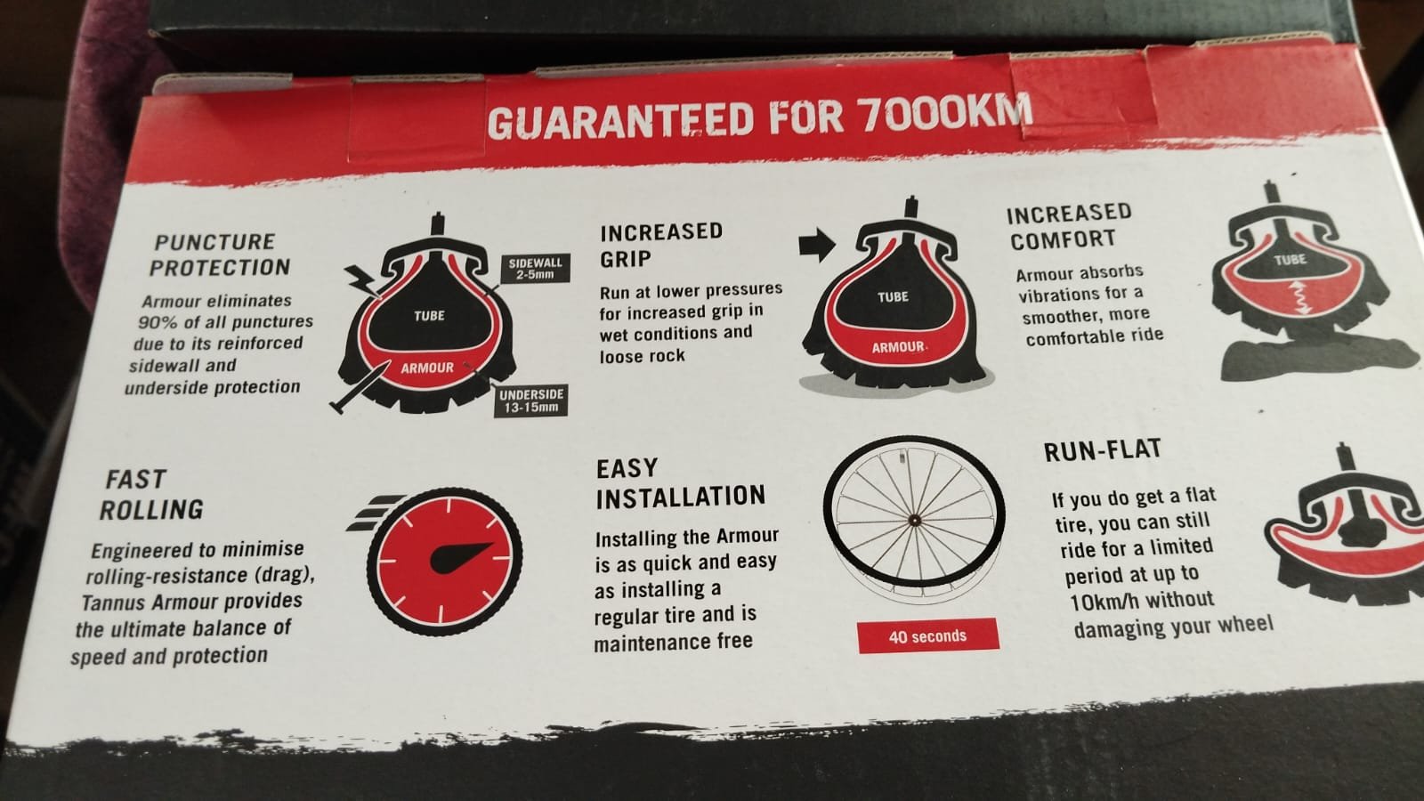

Due to too many punctures, I fitted pair them in 2021 @ 25psi and had no punctures until this week. Removed inserts and found them completely flattened after only a thousand miles, from the original 15mm down to 2mm in centre. Removed them so they could "rebound" but alas they don't.
Tannus warranty is 7,000km
Tannus FAQ misleading in this respect "The Armour will compress some after it’s installed depending on the pressure of the tire. The higher the pressure the more condensed the Armour will become. If you wish to keep the Armour as thick as possible then maintain a lower Bar. You may also deflate your tire if you’re not going to be riding for a longer period. This allows the Armour to rebound back to its original size."
I tried warming the inserts but they shrunk to junk.
They are bloody expensive for a bit of sponge.
Still, 4 years without a puncture is worth the dosh isn't it.

Dave238 Yes I agree 1000 miles is very poor, plus the insert would have been well compressed at 500 miles giving significantly reduced protection. It was a tiny 4mm long shard of flint which caused the puncture, penetrating the tread knobble, the insert and the tube right in the centre where the insert lone should be 15mm deep.
The agent at Tannus UK I spoke to said the inserts have been reformulated to be more durable but when I asked Tannus by email to expand on that, they have gone silent. Goods are supposed to be good for 6 years from manufacturing/design faults, so I believe Tannus should cough up a refund or replacements. Misleading advertising - yes. Not fit for purpose - probably. The retailer is liaising with Tannus UK too.

AF1
Jan 12, 2021
99
64
Good news, Tannus have thus far replaced four of my six armour inserts, 2 were four years old and 2 under 2 years.
Tannus used to warranty for 7000km and more recently 2 years but now I cannot find any mention of warranty on their websites or packaging, apart from the USA = a paltry 3 months: "Tannus Armour comes with a warranty that covers defects in material and workmanship for 3 months without significant compression, meaning greater than or equal to 7.5mm that does not decompress".
This would mean the loss of 50% of the puncture protection before the warranty kicks in! Therefore Tannus are well aware of the degradation in these inserts. At UK ambient temperatures I found no decompression of my completely flattened inserts occurred, even with the inserts removed inside the house airing cupboard.
I asked Tannus UK about their current warranty but got no answer.
I think "Rebound" if it happens at all, is temperature dependant so deflating tyres between rides would make no difference in the UK's colder temperatures.
I checked the pressure in my rear tyre after 10 miles on a brand new insert and found it had dropped from 25 to 20psi, thus proving significant compression of the insert in a very short distance and at very low pressures.
