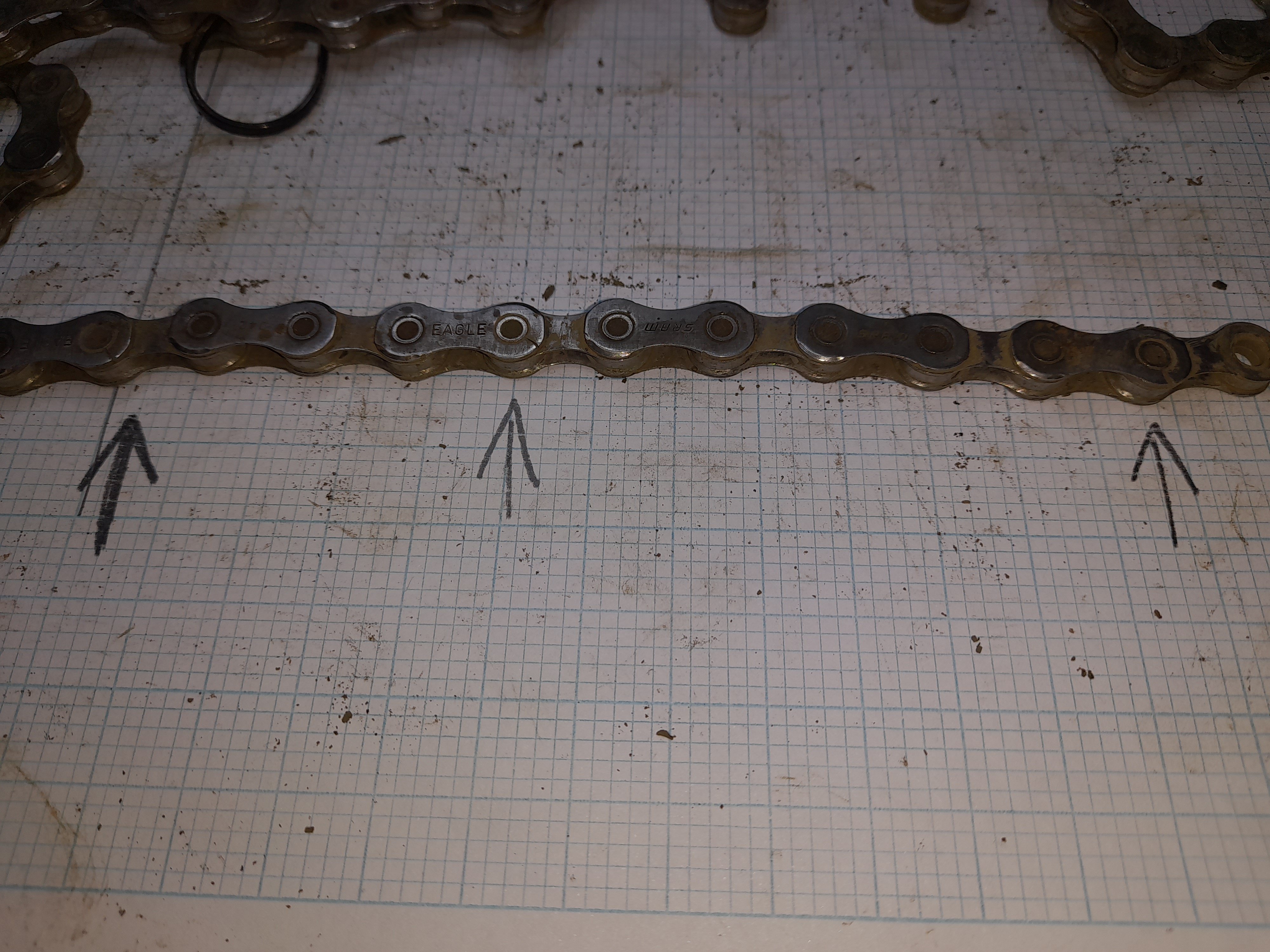

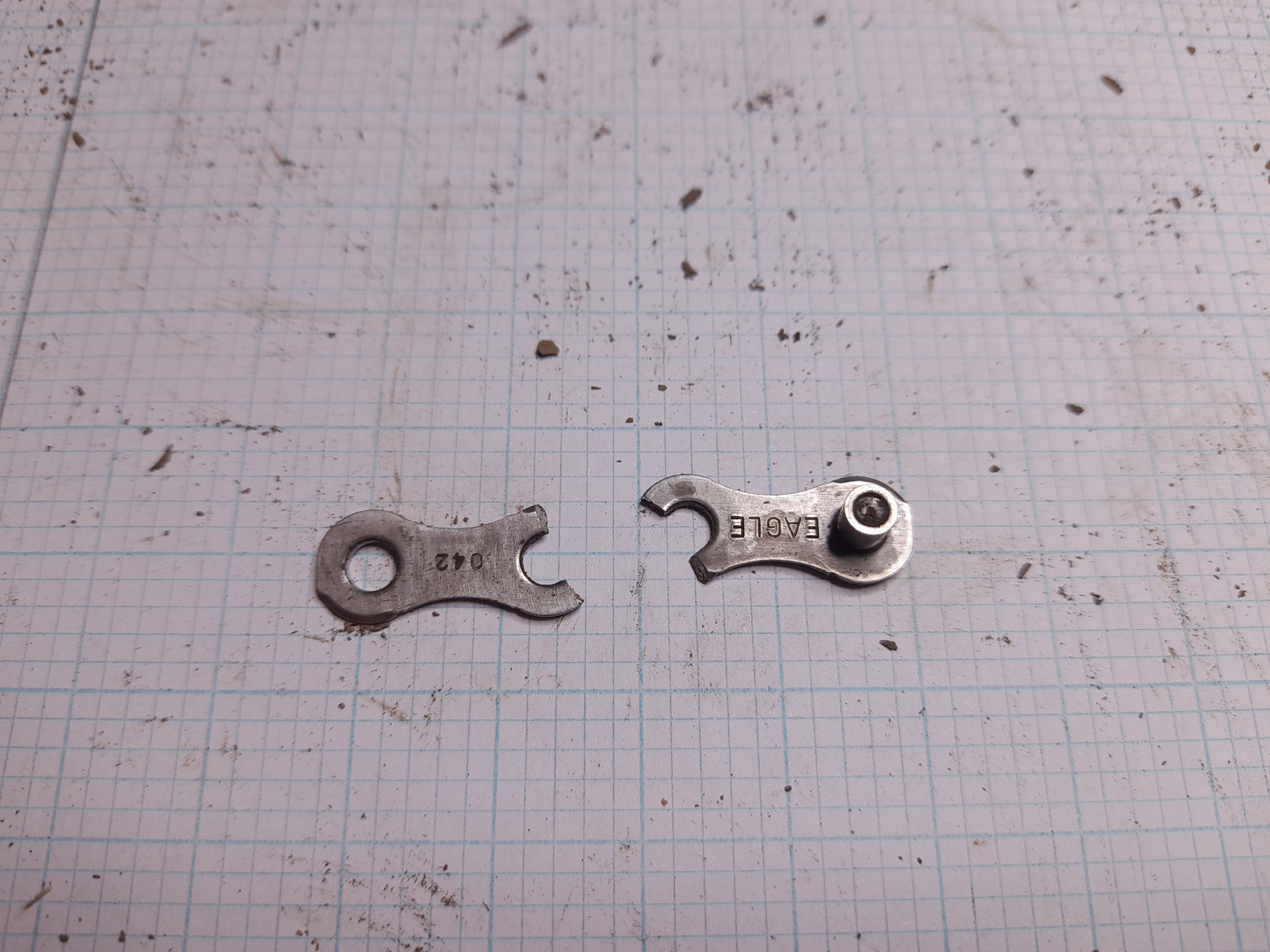

've used many versions of Shimano and SRAM on pedal bikes over the years and a few SRAM 12 speeds more recently especially on the EBike @ 3000kms. Used to have a preference for Shimano but the GX set-up from SRAM has given me fewer headaches. I like the simple functioning clutch from SRAM and have not had to mess with it at all. Suspect there isn't a huge difference either way.
At the risk of hi-jacking the thread I had a vague theory that the high end Shimano groupsets offered weight saving and smoothness benefits, but no impact on reliability.
Though I'd test this out with the SRAM set-up on the Ebike, installing an NX chain at the last swap out.
Chain was 100 miles old when it broke on a ride. Inserted a quick link and it broke in another place. Luckily I had another spare link. Later in the day it started making a noise and I could see another cracked link, so shortened it and headed home. On inspection there were four further links with cracked plates!
The shop refunded the price and I switched back to GX with no problems since.
Is NX seriously inferior to GX or was I unlucky with the chain in question - or I also wonder if the part was genuine SRAM? See pics.
