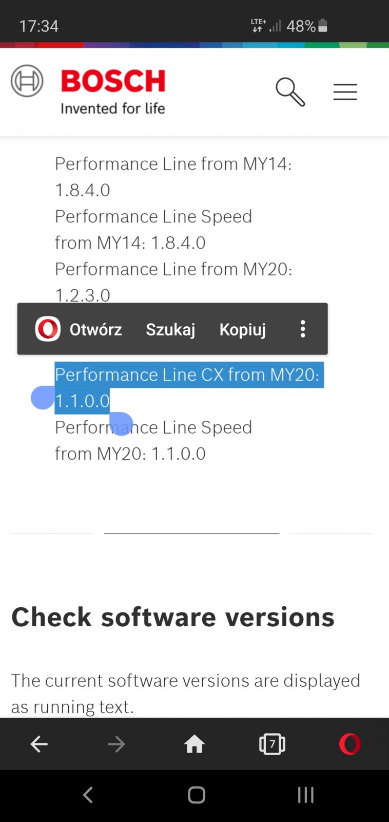

may I ask where do you get this 1.0.4.0 software info from? Bosch does not claim anything on their website regarding this - Software updates
rymas
Jun 14, 2020
Poland
New version 1.1.0.0 is available for 4gen?
