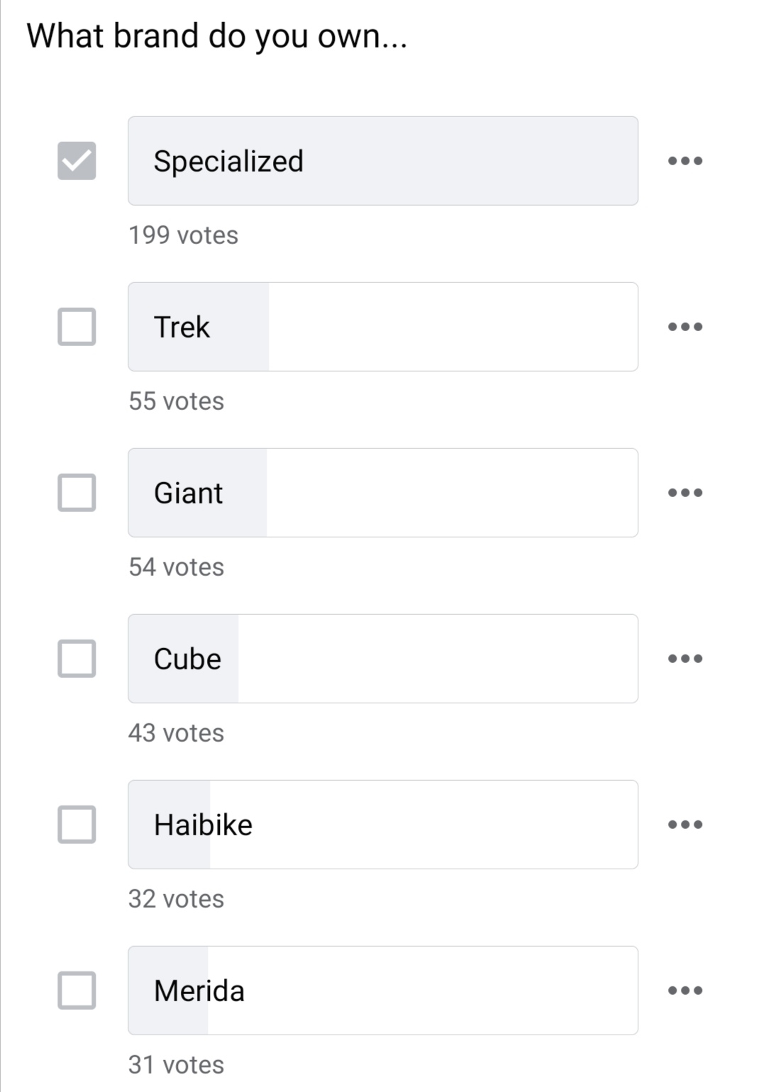

I came across this pool on FB emtb page with 8k+ members. I wasn't aware that Specialized has such a big market share on emtb's, this kinda explains why there seems to be so many threads about problems with Specialized emtbs/brose motors.
Another metric - the number of manufacturer specific posts here:
  1. Specialized 48K Messages
  2. YT Industries 5.5K Messages
  3. Giant 4.9K Messages
  4. Vitus 4.2K Messages
  5. Focus 4K Messages
  6. Cube 2.7K Messages
  7. Trek 2.4K Messages
  8. Merida 2.1K Messages
  9. Commencal 2K Messages
  10. Canyon 1.7K Messages
  11. Haibike 1.1K Messages
  12. Scott 228 Messages
  13. KTM 178 Messages
Other Manufacturers
3.2K Messages
