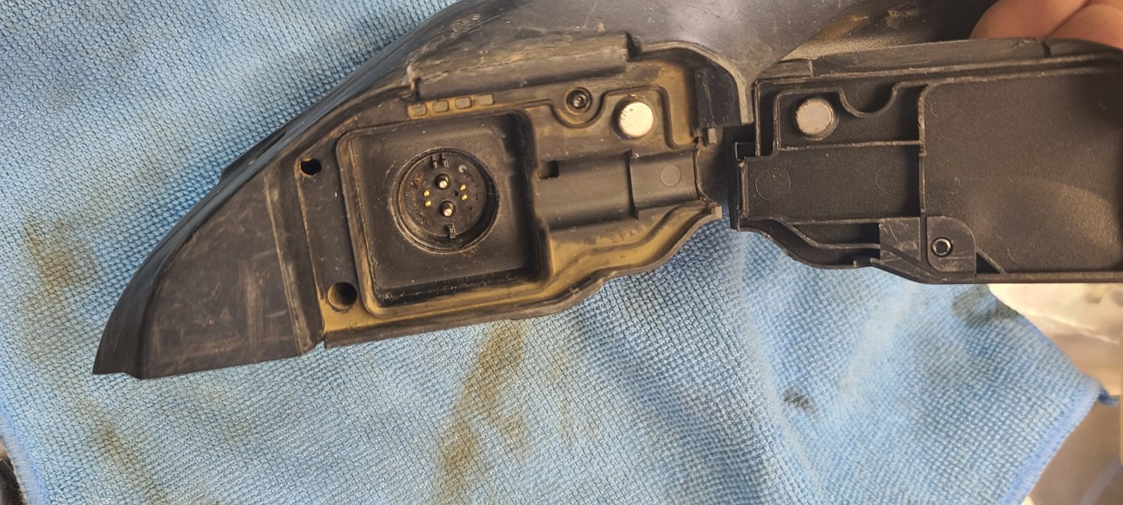

Ive just purchased from that German website as they now have stock, will see how it goes when it arrives :)
I just received 2 off these from BestBike (I have 2 batt).
5 min later the new battery doors were mounted.
The door has a spring that ensures the open door is keept away from the crankarm.
The hinge has a more solid design.
I hope this is the last time I need to change the battery door 😇

Received mine today, quick easy install, lets see if they hold up :)

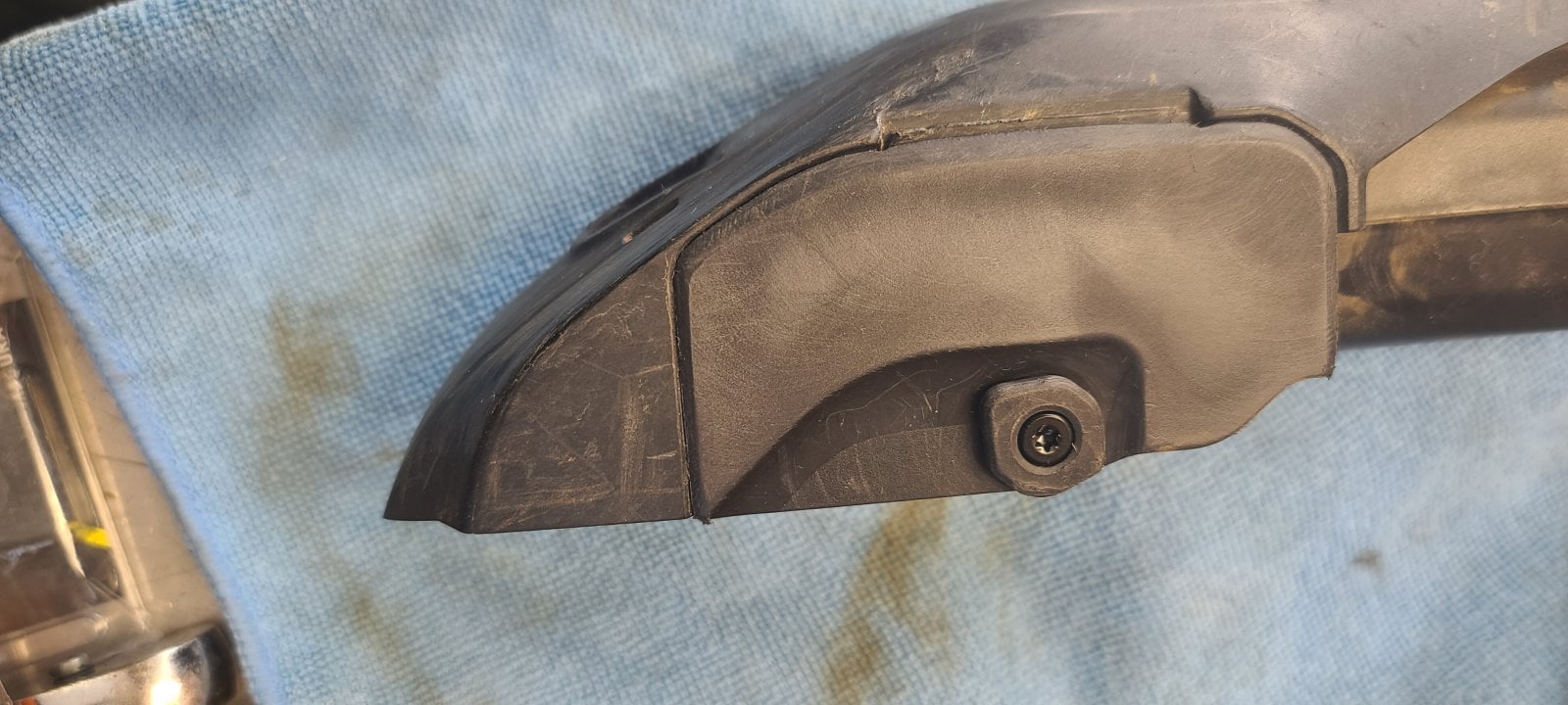

Nice to see they have a potential fix as I am on my third. This should be a recall item.
After the third hinge failed again i was able to locate it on the trail.
I jb welded a strong magnet on the inside in place of the crap hinge. This helped quite a bit but it did come off again.
The issue is the door sits on the edge of the bash guard. Any hit to edge of bash jams the door upward. Eventually the lever works it's way up and door opens.
Absolute joke design, it makes you wonder what kind of pansy riders they had during testing. This should be a recall item, complete utter failure in design and now we have to pay for a fix?
The entire bashguard should be redesigned with a lip that protects the door.
I beveled the edges of my door so edges sit inboard if the bash guard. I also shaved the lever to a knub so it did not get easily opened. This has helped immensly.

I have also received and installed the new generation door kit to replace the old one which broke off after a relatively minor bump on a log hop-over. It is more burly and a better design, because the edge of the door is inset a bit, slightly more away from harm's way. It is still plastic though, and I def wouldn't call it bomb proof...but we'll see if it lasts.
