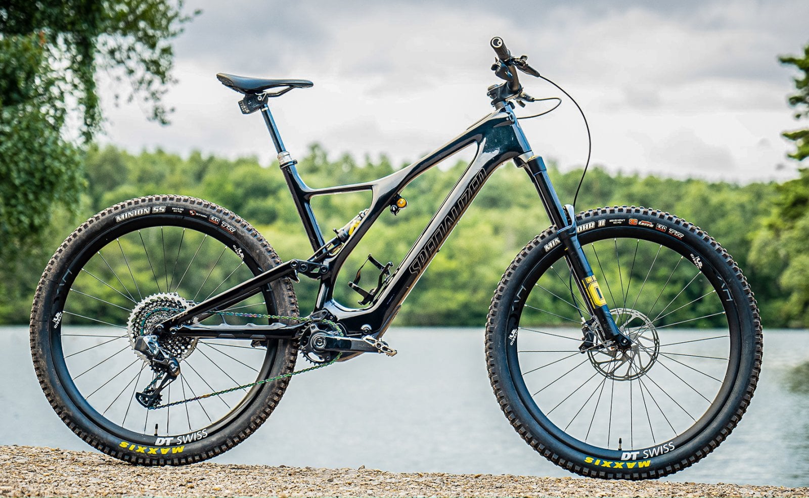

I’m currently riding a 2019 Kenevo Expert, but the dream bike for me would be a lightweight carbon 170mm single crown fork enduro bike with a little bit of assist, similar to that of the Levo SL. I’m seriously contemplating buying a 2021 Levo SL Expert for £7k and then spending a load more money modding it into an ‘enduro’ spec rather than It’s current 150mm travel ‘trail’ bike spec.
The 2021 expert model now comes with upgraded brakes (Guide G2 to Code RS and a 200mm rear rotor) and the stiffer Fox 36 forks, which is a great step in the right direction (pity about losing the carbon wheel set this year though ☹️), but then for my style of riding I would want to increase the travel of the front by 20mm and rear by 10mm, carbon wheels and possibly even go mullet 27.5 on the back.
- Are there many others like me looking for an ‘Enduro SL’ or am I just odd?
- If so, are Specialized aware?
- Are they working on something d’ya recon?
Concerned I’m going to try and fudge something together at significant cost and ultimately the geometry and engineering of the frame is not really cut out for what I’m wanting to use the bike for. P.S. - I know there are other SL bikes with bigger travel from other brands out there, but I still think Specialized have the edge and would prefer to wait if they are working on something... Cheers!

I'd like one. I'm going to play around with mine, add a 170mm Zeb Ultimate and a 27.5" on the rear within the next couple of weeks!

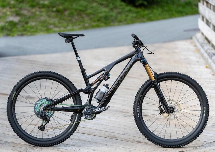

I’d like 1, I’ve rode my mates s works enduro a few times and it’s amazing on rough trails but rather have my SL for everything else. I’ve tried zebs on a diff bike but prefer the lyrics as I find them more responsive. I run 160mm upfront and similar at the rear ?. Hoping to get the new rock show ultimate deluxe soon, been running coil but want a change. To me the bike is near perfect, small seat tube on an xl would of been better, but overall it’s why a lot of enduro racers used to pick the stumpy over the enduro. sometimes too much travel is boring...

Totally. I heard 3rd party that one was coming out later this year : "Enduro" geo, 170mm (?), 29er (?), and a new 45nm SL motor. Super 3rd party information - so who knows if it will happen.
My SL is already at 170mm up front, 64.25ish HTA, EXT Storia w/CC link (22% progressivity). It's the fastest bike I have ridden, but I could see having a bit more reach, steeper STA, longer chainstays, and better rear /progressive kinematics with 160-170mm travel being the bee's knees in terms of bikes for "enduro" riding.

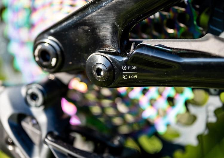

Only had mine at 170 fork (44 offset) and havent had anything but good handling. Its in high mode and STA is slack - so I can see the negatives to going 27.5 rear.

I basically have this. I have an offset bushing in there instead of the headset adapter (raises the stack which I wanted to avoid by plus the bb drop is a bit lower on mine) plus low on the flip chip. I think I am at 64.25 deg. STA is slack, but manageable with a long rail saddle and pushed fwd
I am running the cc link but at 52.5mm stroke. I found that you can get the yoke to touch the seatstay bridge with the cc link and my geo changes. Probably ok if you go your route and are good with the stack changes
