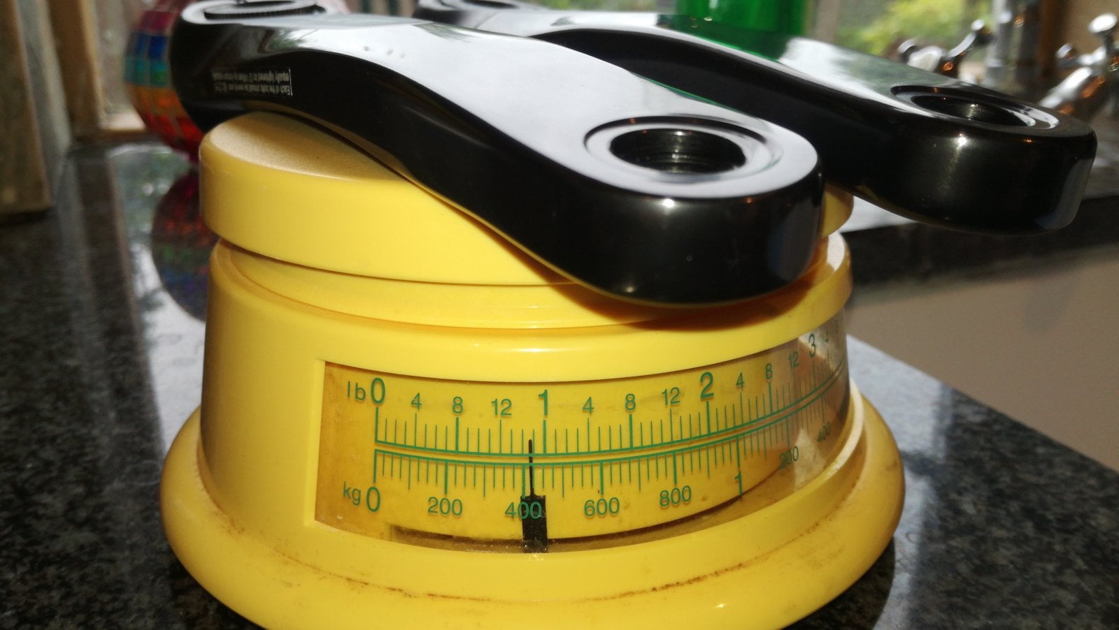

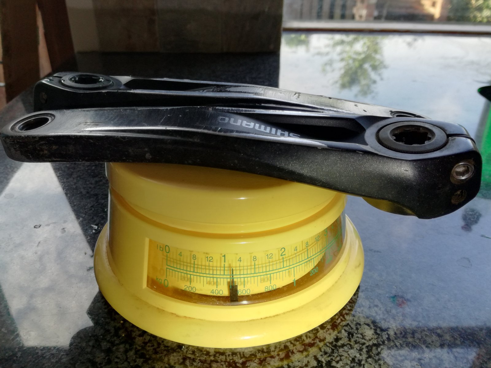

Please excuse the low quality of these scales, but a pair of FC-E8000 175mm cranks weigh approximately 518g.
According to Shimano Steps Kurbelgarnitur FC-M8050 | BIKEIMPORT
FC-E8000:
165mm = 531g
170mm = 535g
175mm = 538g
FC-E8050:
170mm = 451g
175mm = 455g
FC-M8050:
165mm = 447g
170mm = 452g
175mm = 459g
Costs according to bike-discount.de
FC-E8000 = £26.84
FC-E8050 = £67.29
FC-M8050 = £81.72
