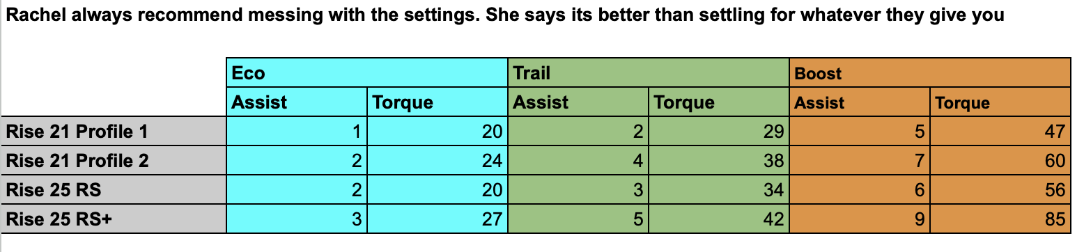

Can anyone put up the standard/default/factory settings for the EP8 and 801? I' intrigued as to the differences between the 'regular' and the profiles that ship with the Orbea Rise
If you want to add the. to the template its here -
I’m also curious what the stock power (watts) levels are for the RS+ profiles.
I’d have to reset my RS to stock to be sure but I believe the e/t/b levels are 150/250/350w, and 350w being the max for fine tune mode.
