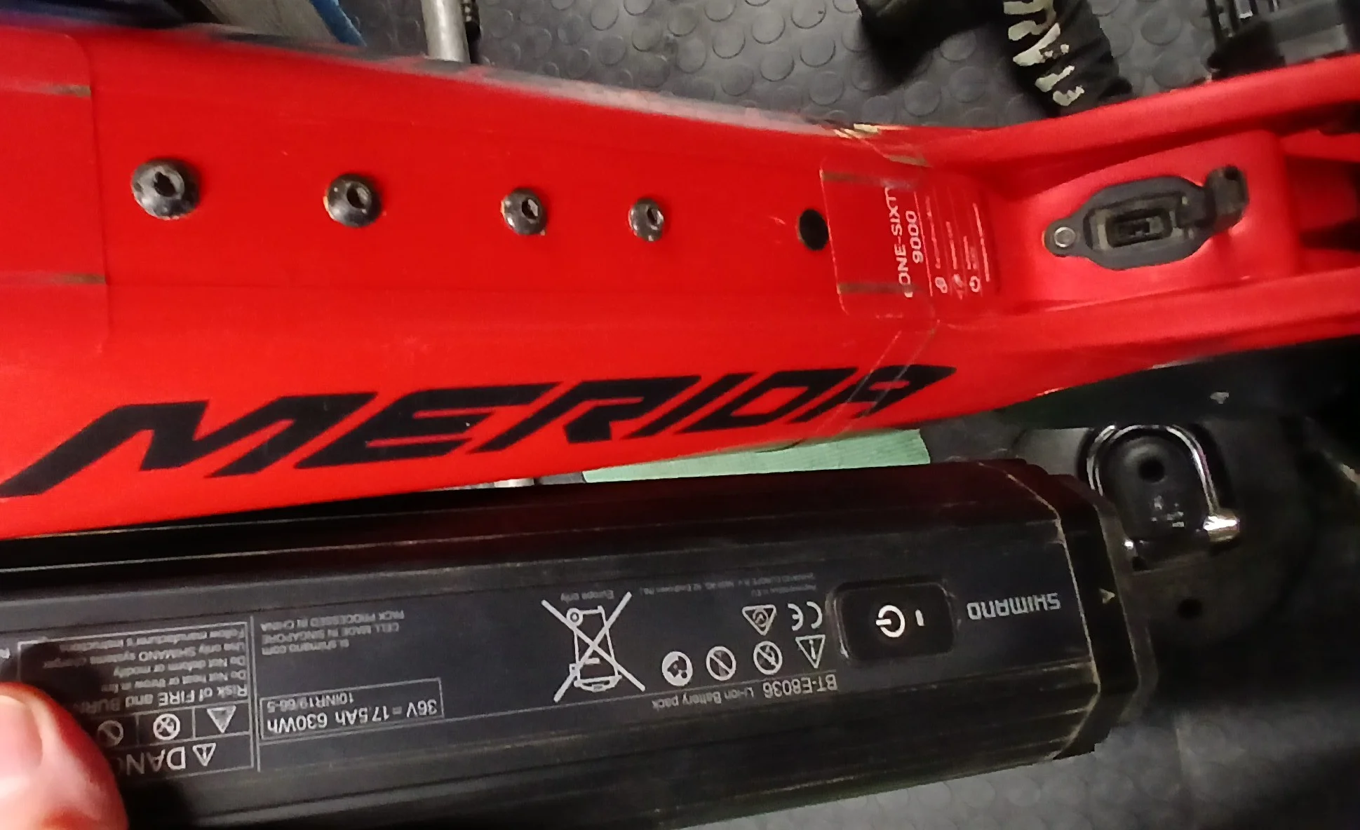

I had a similar problem on my Merida E160 last night. Powering it up for the first time in 8 months.
It was stored in a dry environment, has a relatively new motor and battery, put away working.
I pressed the on button, blinked green and nothing happening, nothing on the display...
After trying everything, here is what worked:
- Pulled a rubber grommet out of the frame and was able to press the on button directly on the battery itself not the frame mounted on button. All powered up fine.
Turns out the frame mounted on button has a small rechargeable battery in it that was too flat to power up the system. Now that I've used it, it has recharged from the main battery and is working.
Hope this helps.
Hope this helps.
Here is the rubber grommet; just above the "D" in Merida.
