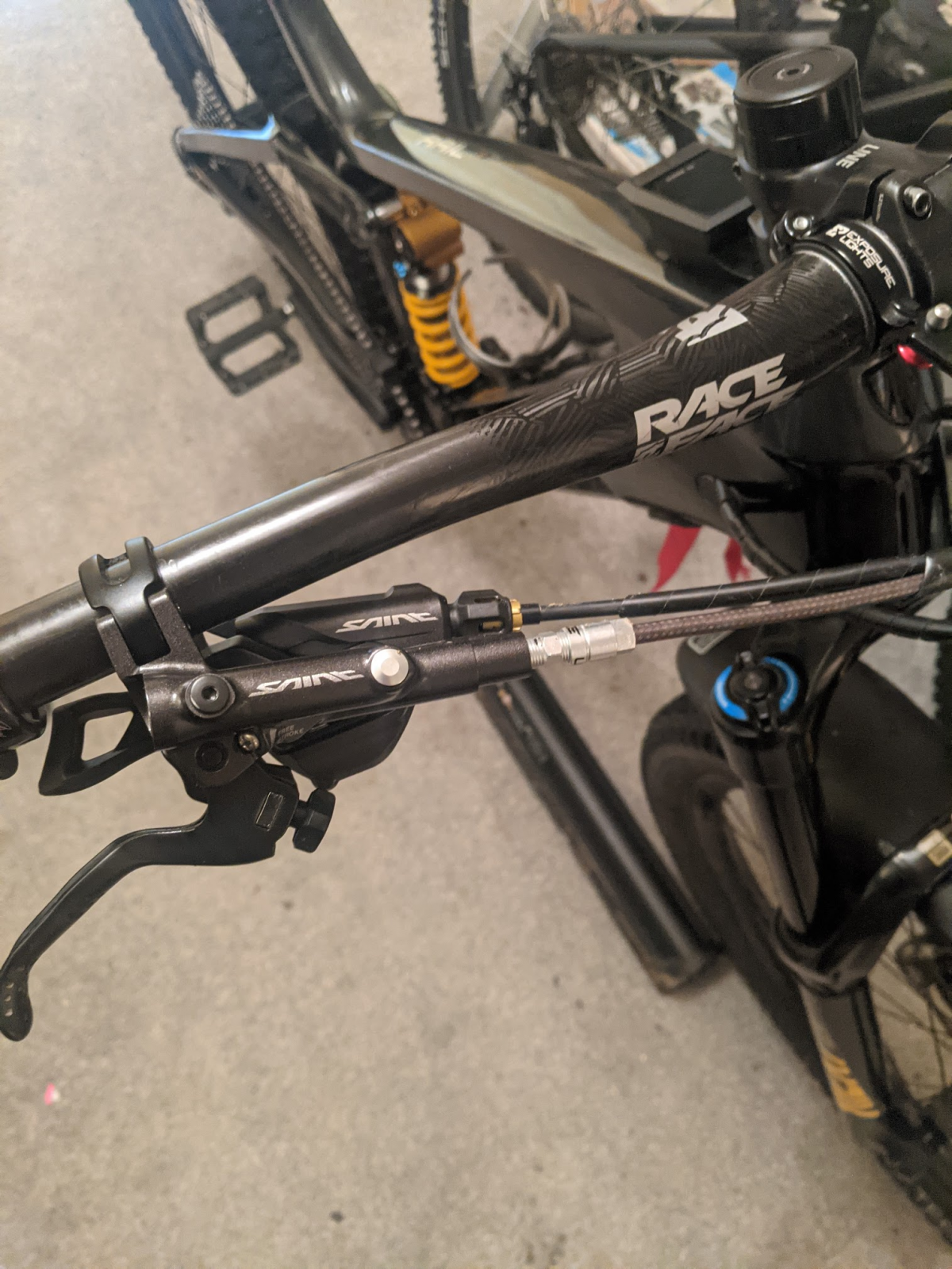

I run mt7 calipers and saint levers on my dh bike, and mt5 estop calipers and saint levers on my trek rail, both with uberbike braided hoses.
Both perform identically, it's really just the colour of the caliper that seems to be the difference, and potentially the compound of the pads.
I run both bikes with disco brakes ceramic pro pads and they are solid. Have tried the stock magura pads and the magura race pads and they are louder (horrid bubbly metallic notice) and perform worse.
The Saint levers have the servo wave action, haven't tried running with a non-servo lever. There is no wandering bite point and I've never personally experienced it in a decade of running Shimano, providing theyre bled correctly.
Am 100% converted to shigura and will convert my acoustic trail bike in the spring too, perfect combo of solid lever feel and overwhelmingly aggressive power.

I run mt7 calipers and saint levers on my dh bike...
I just assembled MT7 calipers with Saint levers on a recently completed bike. I noticed the lever pull is extremely short for initial pad contact; shorter than my full-Magura and full-Shimano setups. Is this your experience? The rotors are Magura Storm HC and for fluid I decided to try Bunnyhop Tribe Gold mineral oil.

I have MT5 on both my bikes ebike & non ebike I did have Saint levers but have gone back to MT5 lever with loic Bruni lever better modulation than shimano which is on off run 220 Magura front & 200 rear MDR-P rotors

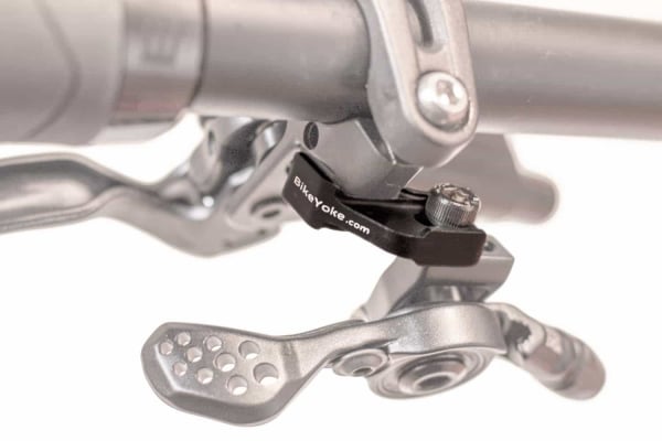

You need to mind yourself about which clamp style you are ordering for your Shimano Brake Levers if you are mounting Sram shifters and/or rear Sram seat post dropper levers directly to your brake levers. I run the Sram/Rockshox AXS Reverb Dropper post and Sram AXS rear mech and needed to order aftermarket adapters to mount them directly to my Shimano Saint levers (ISpec B version). Problems Solvers, Bikeyoke and Wolftooth make aftermarket adapters to complete this task. I ordered all 3 since they each put the shifter/dropper post lever in pretty much a fixed position but slightlydifferent distancs from handlebar. The BikeYoke adapter does give you some ability to adjust left to right.
Thanks mate, appreciate the advice, will grab some with the order ?

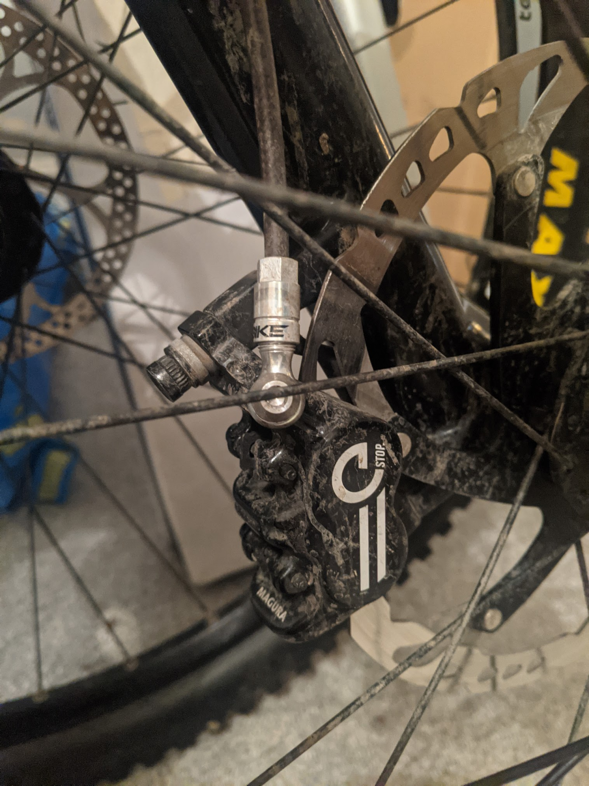

I have the shigura setup with mt7 and xt 8000 levers. Using the mtx red race in front and back and really liking it. May go gold next time just to see.
I did find that on one side the shimano barb and olive in the Magura hose had a slow leak. I swapped to Magura barb and olive and it solved that
Thanks for the input! Happen to have both Magura and Shimano barbs and the part of the barb that goes inside the brake hose is .010" larger on the Magura barb. May explain the reason for the slow leak.
jcmonty
Sep 5, 2018
472
406
California
I ran the risk since I didn’t have a spare Magura barb and olive at the time. It worked fine for a while but eventually gave out. It wasn’t the cleanest cut on the hose (oops) which may have contributed too

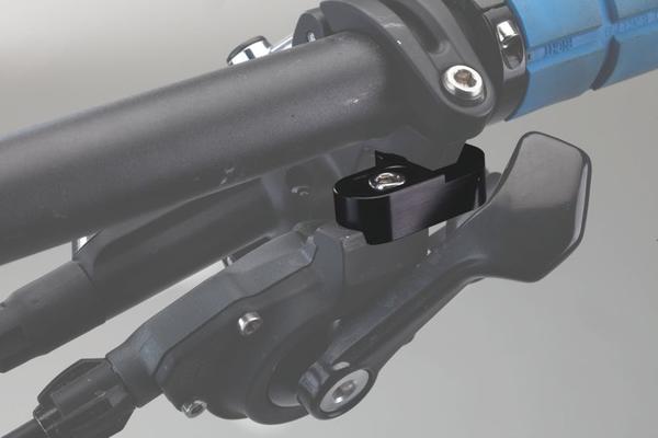

Hi guys,
Just to follow up - I've spoken with BikeYoke & ProblemSolvers; they all make adapters for the shifter but the Specialized Command Post is not supported by ProblemSolvers.
Sacki over at BikeYoke was really helpful and suggested that this adapter will work for my scenario:
- Levo Expert 2020
- Specialized Command Post dropper
- SRAM S700 shifter
- Shimano XT BL-M8100 levers
(If you are going the Saint route, they recommend the i-Spec B adapter)

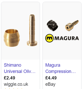

One thing I learnt first of all is you need the thicker brass barbs from Shimano as the magura hose is a little thicker and they can somethimes be a bit of a pain to seat.
However, for the last two shigura sets I've installed I've opted for a fresh uberbike hose kit (30 quid or so) and they come with all the connectors etc you need (just make sure to ask Andy for the new spec magura banjo bolts). I find their system a lot more reliable than the Shimano barb and olive approach, mainly due to the security of the threaded barb, like the SRAM system.
Have a good one ?
Also I got a decent deal on the calipers here https://m.bikester.co.uk/magura-mt5-estop-brake-caliper-incl-brake-pads-from-2020-black-1069979.html

I was going to use the Magura barbs, is it worth using the thicker Shimano ones instead?
Cheers ref calipers - are the estop mt5s the same as the normal m5's?
d7e8wd
May 11, 2020
40
27
As far as I know they are the same caliper body, only with 'e-optimised' pads, this was just the cheapest place for the calipers that i could find on my last build.
As far as the barb compatibility goes, the magura one quite thick (aka sits quite a long way proud of the olive)? Im not sure, but in my setups the lever end of the hose uses all shimano specific parts, and the caliper end uses all magura specific, with no mixing.
Dont look that similar to me, but I dont know exactly what the contact surface is inside the lever body (whether its just the olive diameter that matters, or the barb depth too..)
Are you planning on re-using the barb and olive that come on the MT5 kit? As these are compression fittings they can sometimes be reused, but its a bit of a coin flip..

Setup on my rail below (I went with the smoke braided, black would probs have looked better):
