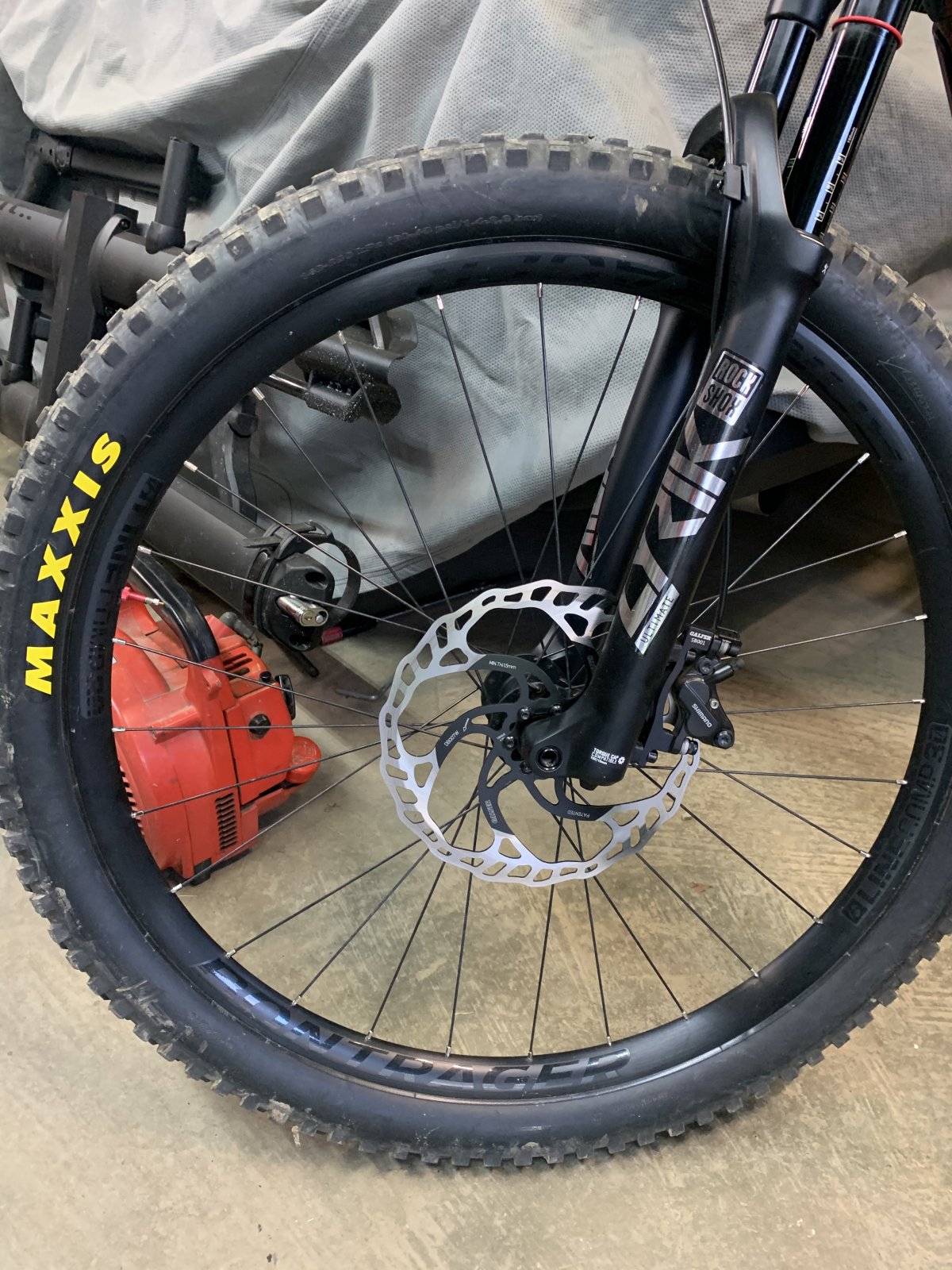

Yes I have it on my E-Sommet with Guide RE's - hell of an upgrade to stopping power, but make sure your fork is rated to take that size disc as you can really notice the fork flexing under full power with them fitted, and I am running a Lyric Ultimate
You also need to be careful when fitting them, as the rotor is 2mm thick rather then 1.8mm, so make sure you spread the pistons right back before fitting the new pads and disc

Yup, once set up correctly you have to be careful until you are used to them as they are so much more powerful
How much more powerful than 203mm, if I can ask please.
Well that's a hard question to answer because it all depends on what brakes etc etc - all I would say is that you will notice more power in upping the disk size than you would in swapping out your brake system to another brand.

Strictly technically, if you are pulling the brake liver with the same force you will get 11,5% more braking torque with 223mm rotor compared to 200mm rotor.
