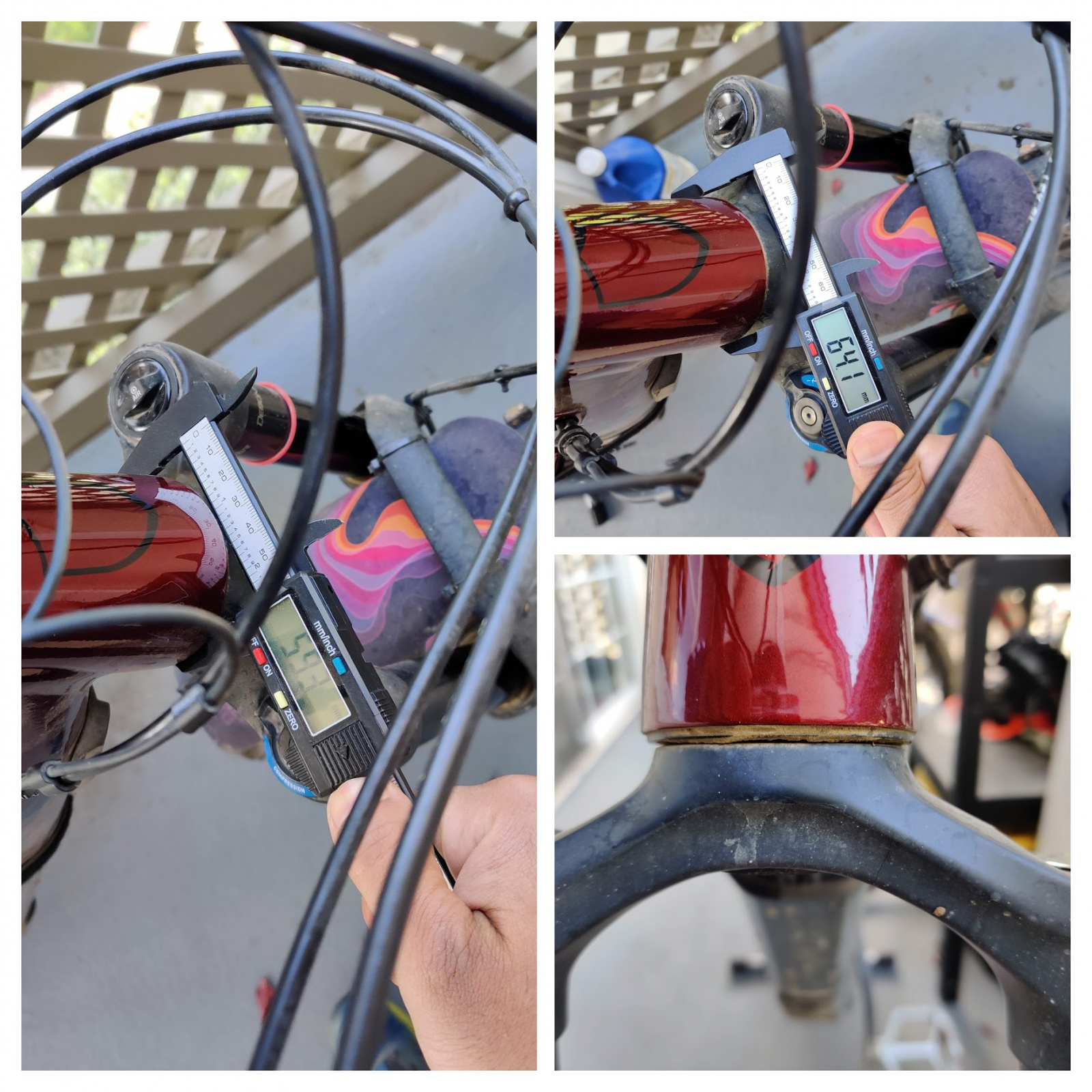

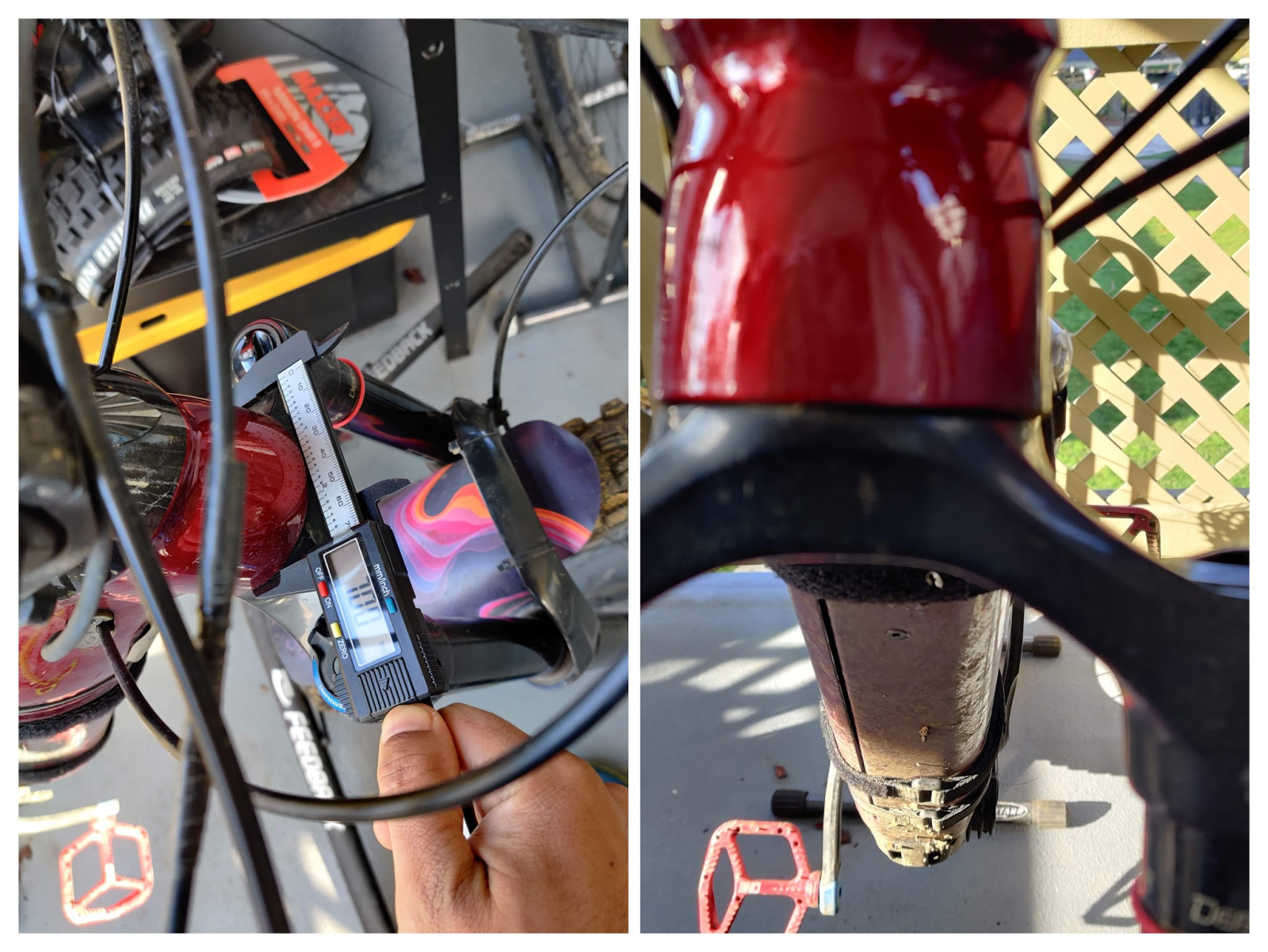

I measured my Trek Rail frame to fork crown joint and compared it to my wife's Norco e-bike (Sight VLT 29) and my new Ripmo frame.
The Trek is ~70mm (~2 3/4 inches) the Norco and Ripmo are ~60mm (2 3/8 inches)
Can someone share their pictures of aftermarket forks on Rails?
