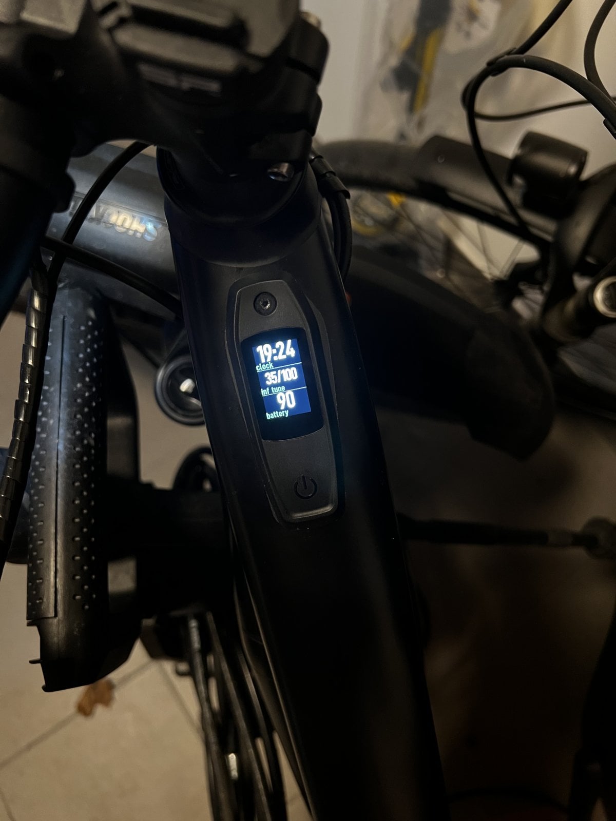

I have the tcu2 in my Levo 2020 comp and love it…
microtune, cadence, watts, pulse, even the radar function works with the Garmin Varia…

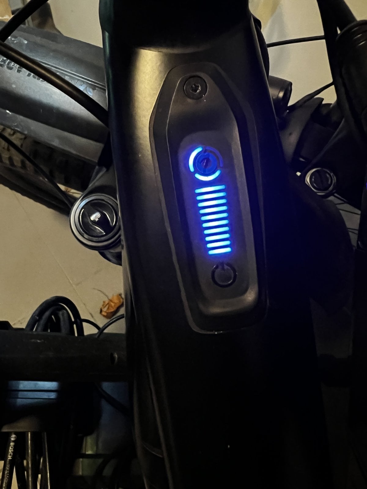

Has anyone else used the MAstermind on a turbo comp alloy? Getting mix reviews that some say it works and some say it doesnt

Let's tell the truth about the new TCU Mastermind. Many words are said, what matters is the practical experience. Let's start by saying that the TCU 2 are all compatible with the previous models and will also be compatible in the future with the new firmware, because Specialized, in the event of a faulty engine, will mount the 2022 engine also on the 2021 models, so this must necessarily be compatible with TCU 1 and vice versa. I have 2 sworks, a 2021 and a 2022, on 2021 I broke the engine, the dealer fitted me a new engine that he had available, to my question, but shouldn't it be a 2021 engine? He answered me now we only mount 2022 engines even on the previous ones. Then I disassembled the TCU 2 from the sworks 2022 and mounted it on the 2021, it works perfectly except as soon as it is turned on it tells me Component Swap, which can be solved by having the dealer insert the 2022 serial on the 2021, if he wants to do it. Having changed the engine and the new TCU2 on 2021 and since there are no other electronic components in between, I can say that these are perfectly compatible. By changing the serial, the Mission Control app will also work, if you don't change the serial it won't work.
