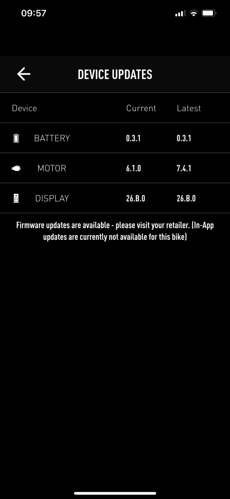

Or working for my Levo says updates available but no Option to do it
salko
Aug 29, 2019
1,237
836
SLO
There is no update in Play Store yet, first post says it will be Tuesday 15th December (PM CET) so in a few hours I guess ...
