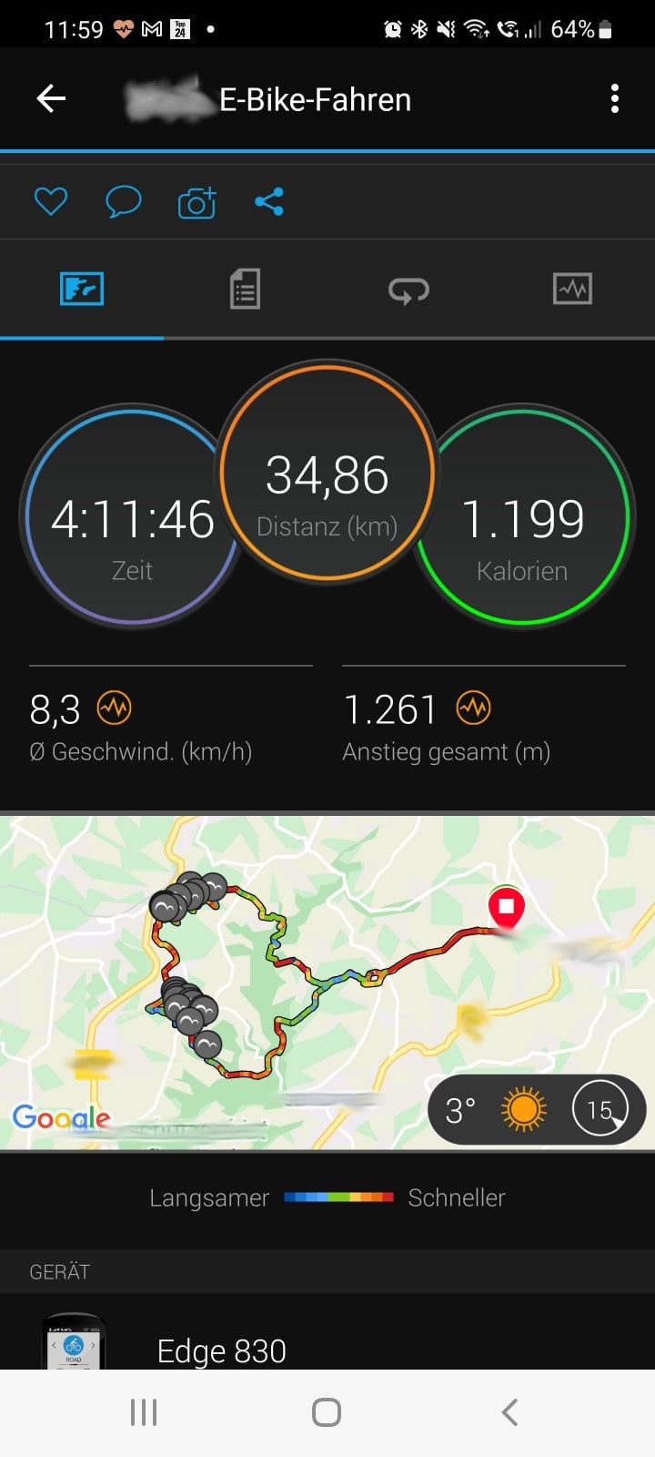

Dominic1212
Oct 31, 2021
25
30
I´am happy so far with my Range (E+ 0):
35km 1260hm and Battery usage 95% with all modes used. All steep climbs with auto mode.
Levo from my friend with 700Wh Battery runs out a little bit earlier . Temperatures from -2 to 3°C and very muddy.
Tires Schwalbe MM front and BB back in supertrail super soft 1.3 and 1.4 bar. Riderweight with gear around 95kg.
