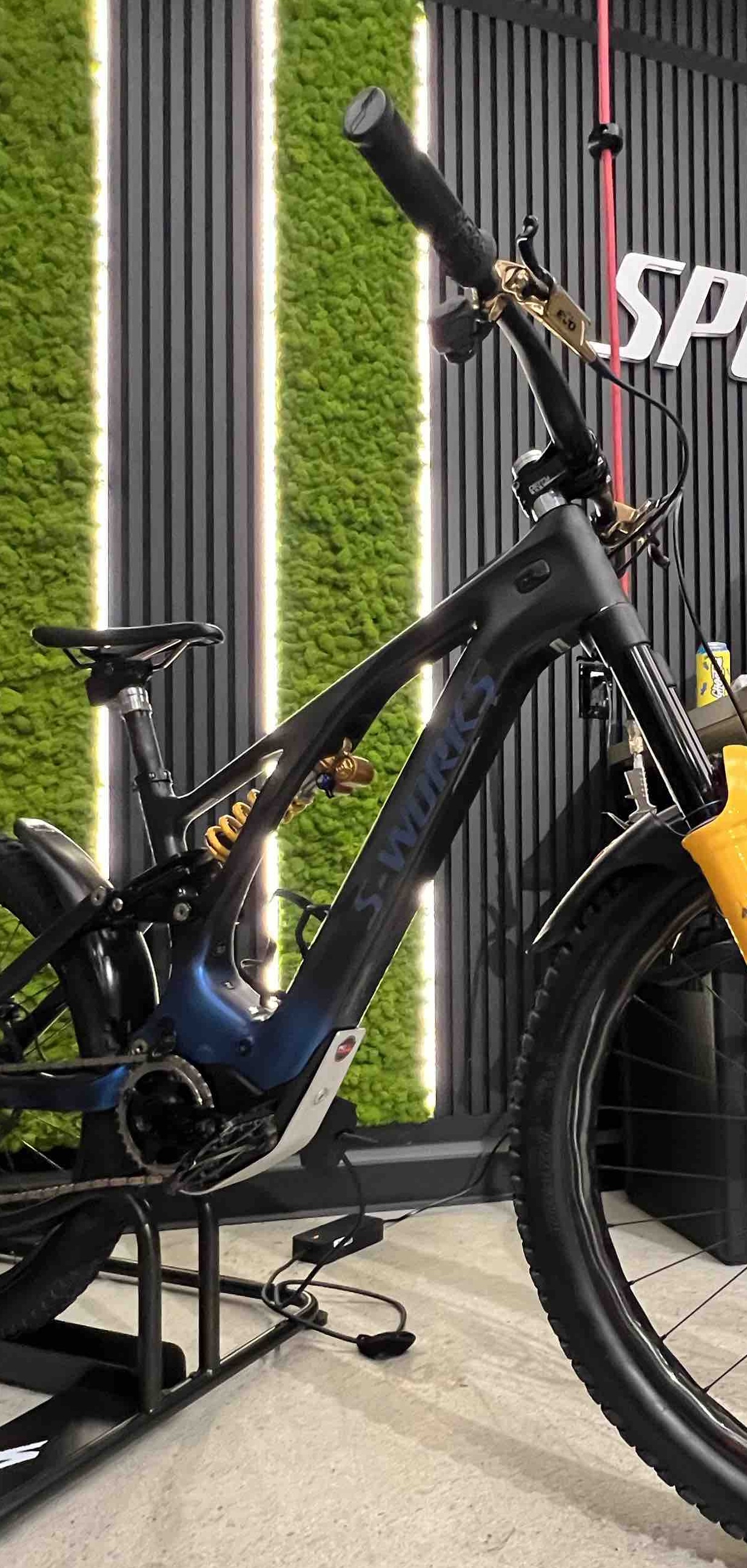

Word for word, exactly what's in yours. I took the whole thing apart, put the foams in, removed the battery, etc. I got in after 3 days of work and heard a clatter coming from the shock. I have a Turbo Levo Expert 2024 (X2). Previously I had an SL on Ohlins and it was absolutely silent. Here the clatter is driving me crazy.

Does Vivid fit well? Does it not rub against the frame? I have an S5. thanks for your help. You have lit a light in a dark tunnel for me.

Vivid fits - larger diameter air shaft than the X2 and dead silent . I’m riding an SWorks S3
I rode with Ohlins 38 and the coil which was better but the Levo always performed better with the air shock .
I also run the Cascade link which lets me run a 230x65 shock with a 170 Rockshox Zeb

Thank you very much for the information. All I have left is the link and Fox X2. I'm almost sure it's the X2 because it also makes sounds when pressing the saddle. I am in the process of ordering a new shock and cascade link. You wouldn't believe it, but I took the whole bike apart, secured all links with foam, all connectors. I rode without the battery and without the dropper and saddle. I thoroughly checked head and motor. I checked the cassette (as you described). There is nothing left except X2 (and maybe the spacers in the fork). If this is confirmed, I think it is a scandal to install shock that are considered top of the line, and the community indicates that they should be replaced after purchase. Simply a shame, but we'll see.
tczubkowski
Apr 21, 2024
10
Poland
I would like to thank everyone for their help. After installing Cascade Link Long and Ohlins TTX Air 2 there was blessed silence. The X2 has gone in for servicing. Supposedly on versions up to 2023 there is a defect that is eliminated with part replacement. After the repair I am unlikely to check if it has improved anything. Thank you.
