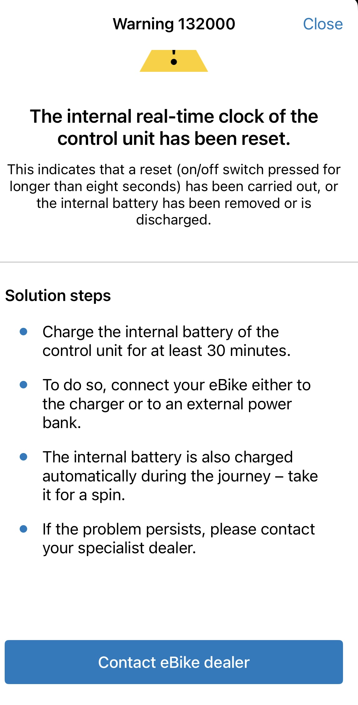

I tried resetting the battery while it was in the bike. The bike then powered on and I was able to change modes with the remote. I didn't try riding it. In the app, I saw this message. Plugged in the charger and it wouldn't charge. Turned it off and now it wont turn on again.

After getting it home, I found that it wasn’t charging. Connecting the charger to the frame port did nothing. No lights, no charging. Connecting it directly to the battery would illuminate the charging lights, but not actually charge. I was going to take it back, but it started charging eventually.
Not sure what is going on, but possibly a faulty charger is the issue. Maybe plugging it in while the bike still had some water in it, caused an issue with both the bike and the charger.

The bike works fine and the issue was a faulty charger. Back and forth between Aus and NZ.

........yep it sounds like the charger was shorted out by plugging it in to the bike.............however, as you previously described, the bike would not switch on either. So there was a bike fault...probably a short circuit......and that also blew up the charger ( probably only a fuse). The most likely area for a short circuit on that bike is the main battery connector plug and the most likely way for water ingress will be the downtube "cover". Glad you got it sorted anyway.
