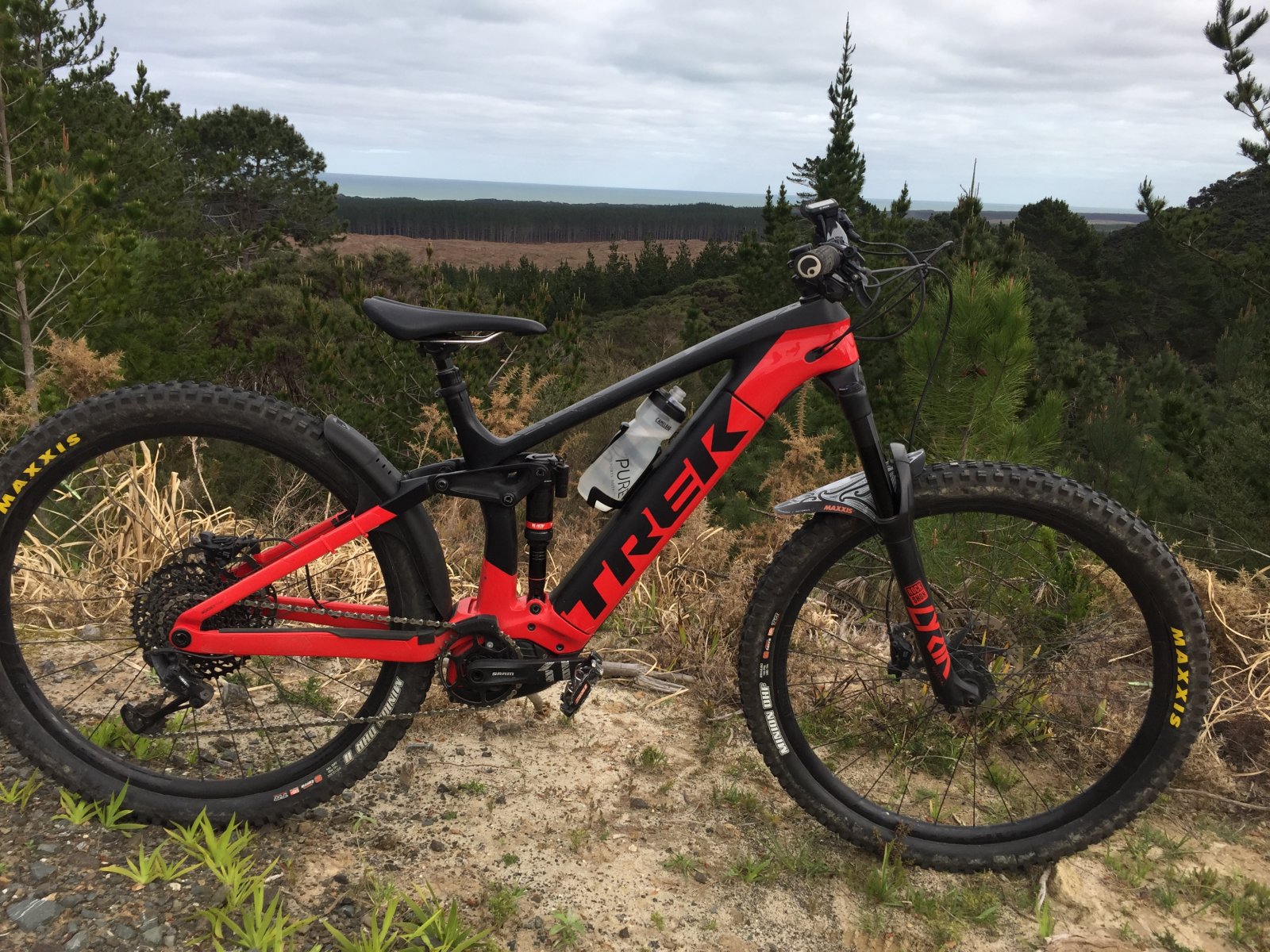

Muckynutz Front short fits like a dream. Just need to drill four holes to mount it to the seat stay bridge.

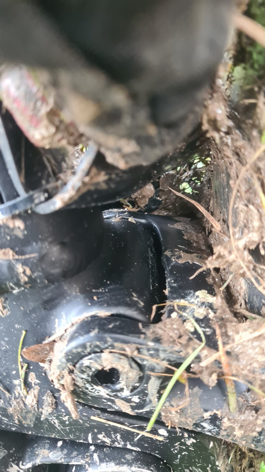

ive got the mudhugger as well , I know what you mean . Mud piles up behind the motor on that lower pivot .
I spent an hour chopping one of those flexy mucky nuts things to fit the lower part , but it looked so crap I decided I would live with without .
problem is there’s not enough clearance under the bridge for using anything that has that kind of fitting so it has to go over the bridge and then just under the mudhugger to . Iam sure some time and more chopping will get something working .

I drilled four holes to mount it using cable ties on the seat stay bridge and used the standard mounting holes on the seat stays with a bit of rubber mastic tape between the guard and the seat stays in case it rubbed the paint off. Don't attach it at the bottom to the chain stays as it moves up as the suspension compresses. Frame is a L but as far as I know the rear triangle is the same on all sizes. @Tony.OK gave me the tip and he has the same mounted on an aluminium Rail 9 so it works on both carbon and aluminium frames.
Edit: Mino link is set in high position for the technical trails I like to ride. Might have to attack it with a heat gun a bit to make it work in the low position.

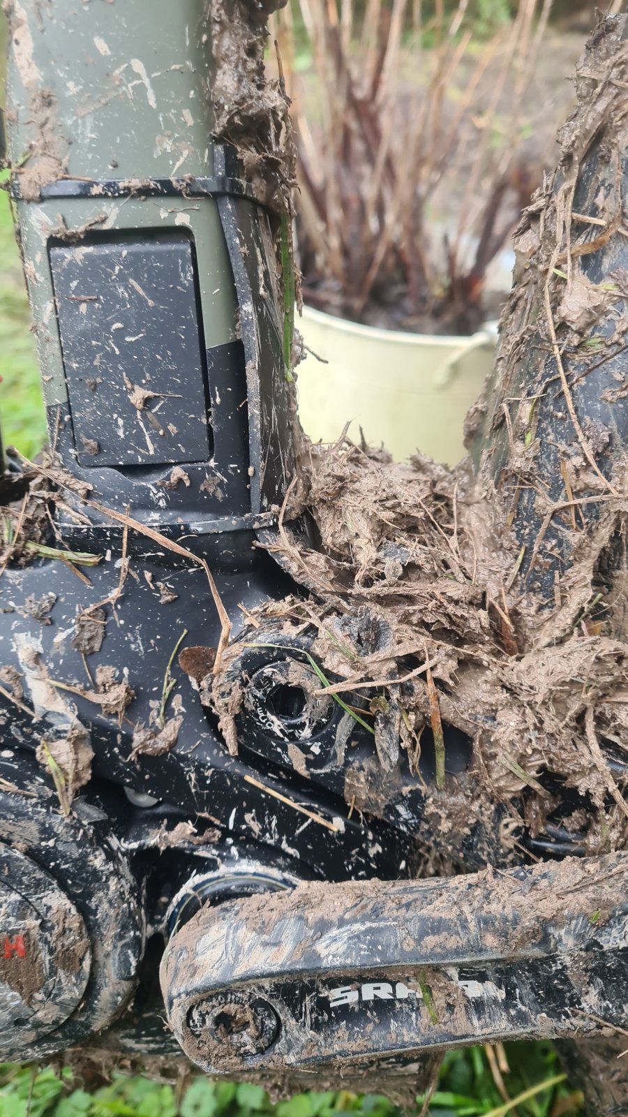

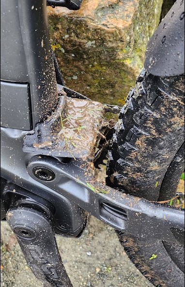

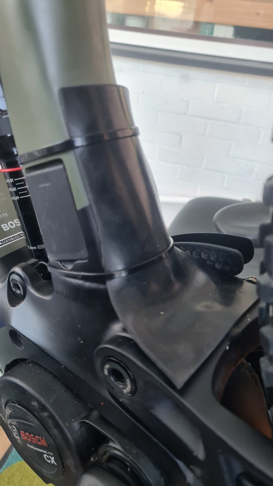

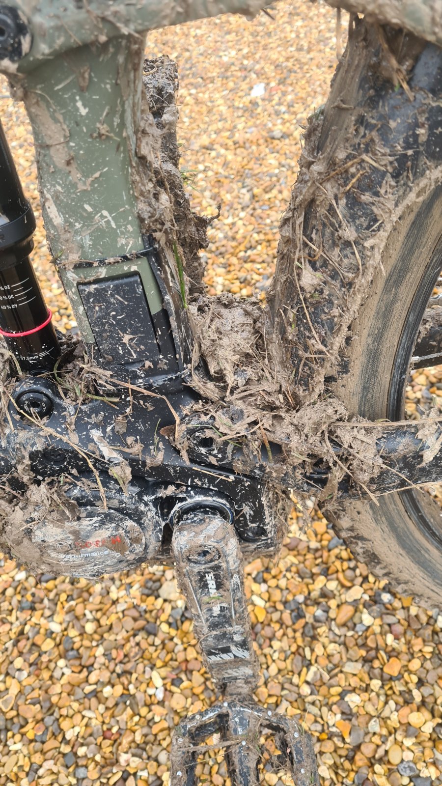

Hi I had the same issue on my rail...so I have designed and made a protection flap for this pivot area ... can purchase on ebay £7.50 works great. I've attached some pics after muddy ride...
OTE]

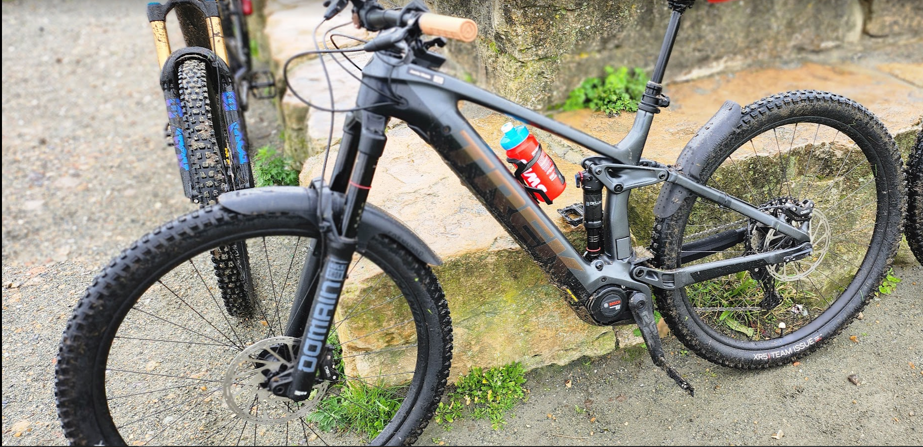

Muckynutz Front short fits like a dream. Just need to drill four holes to mount it to the seat stay bridge. View attachment 50720
I tried a Muckynutz as you suggested, rather than a dream I found it a bit of a mare. Just not enough tyre clearance.
Sicomtb do a Trek specific one but that comes in at £40 with delivery. which I think is a bit rich.

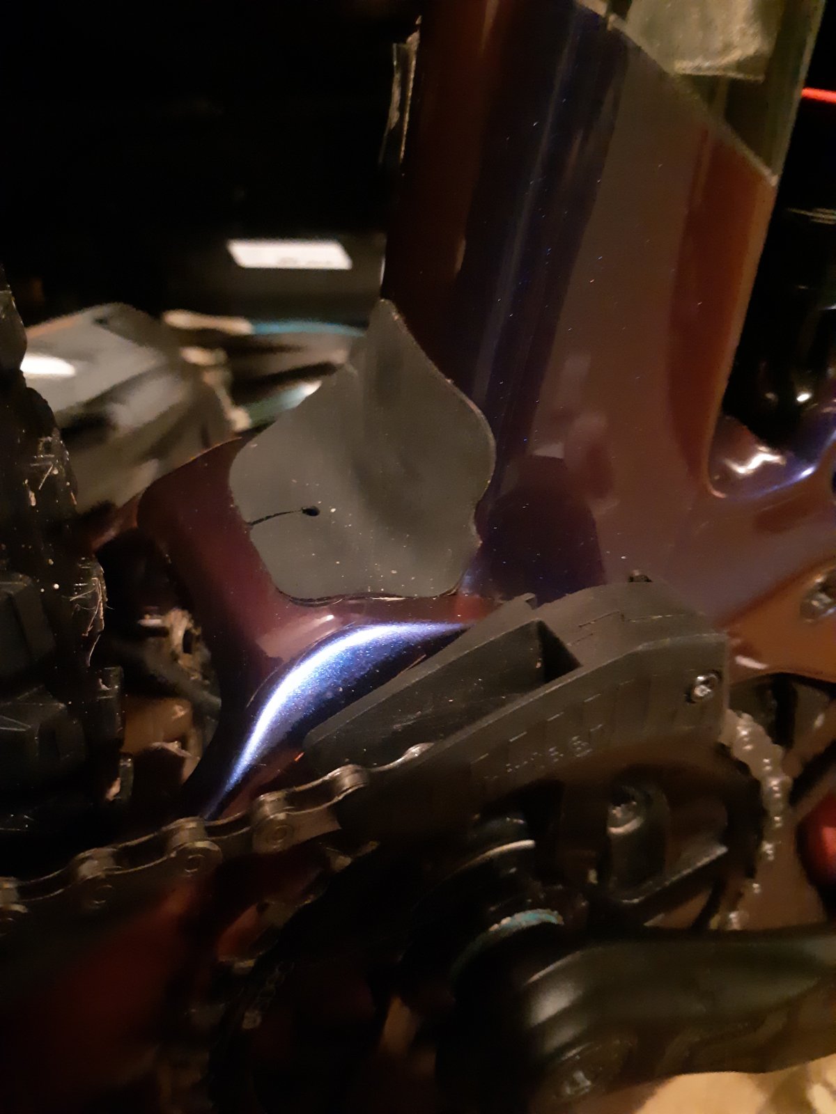

I ended up making a flap out of neoprene, just to cover the gap in the swing arm as others have done. Even made a couple for two mates who also have Rails. Mud still accumulates but is easily knocked off and doesn't collect in the gap.

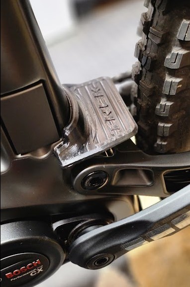

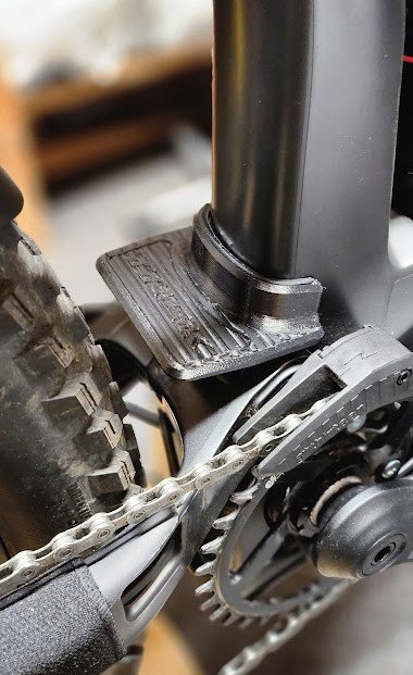

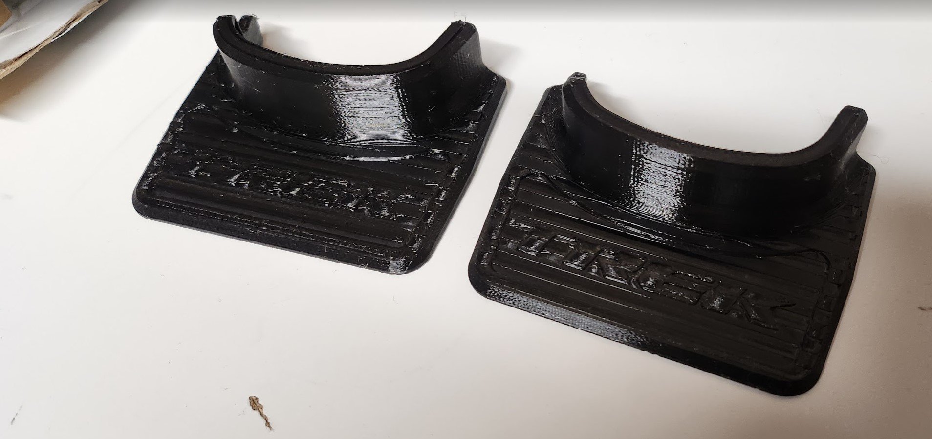

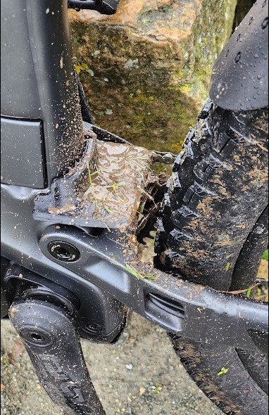

Hi All, Now the proper British weather is upon us I got a mate to print me off some rear pivot guards, see the 3D print file online and they turned out well, some double sided 3m tape and stayed on so far, one sloppy wet ride later proved them well and stayed put, looking at a trip upto Peaks soon so real test up their of it, will see. all works well with my RRP mudguards, with the bike being dark grey and the 3D part black it blends in well.
Screenshot 2022-11-14 103341.jpg Screenshot 2022-11-14 103414.jpg Screenshot 2022-11-14 103438.jpg Screenshot 2022-11-14 103504.jpg image_2022-11-14_104352608.png
