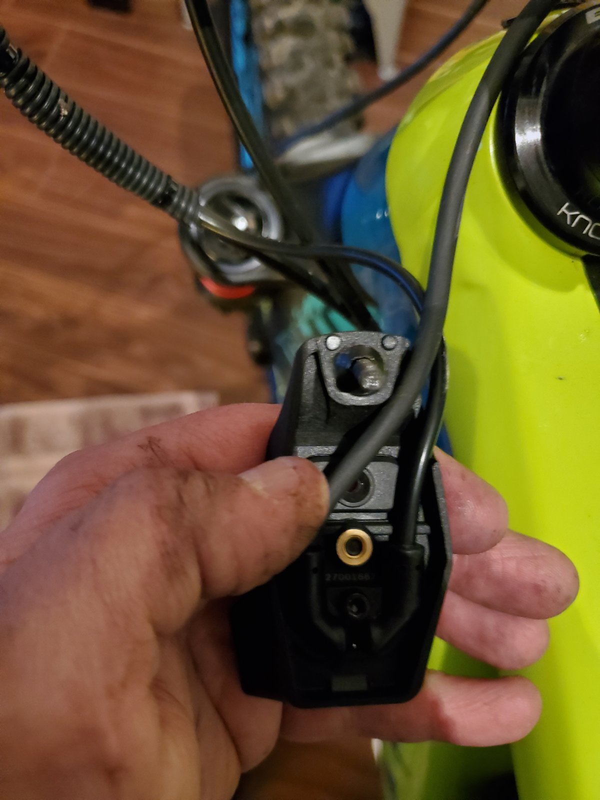

I have highlighted the problem, the two pins are interfering with the knock block chip... Haven't even gotten to the cables i still have the kiox on the stem.

I don't think my mount had those two buttons, it does look like that insert can be taken out by the look of the pic?

Ok that's what I was thinking too, good idea about that but I just tried and it is moulded in there... If you could take a look at yours i would be really grateful ?

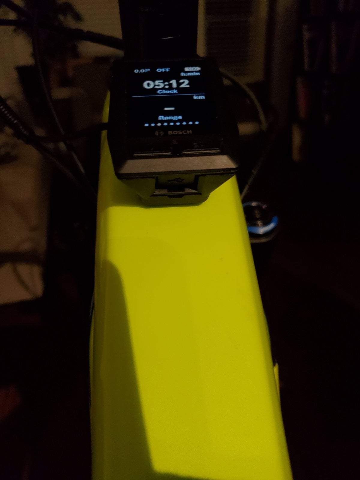

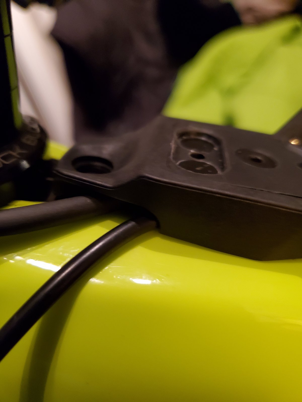

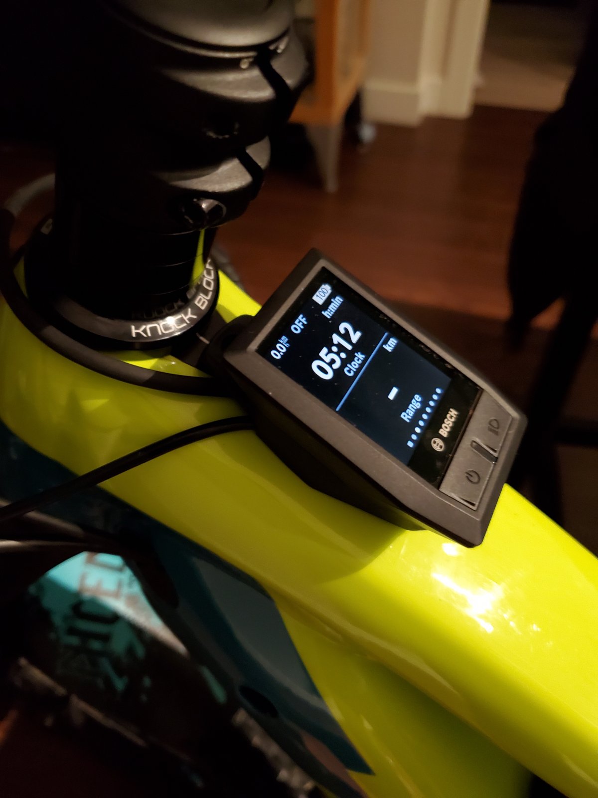

So I took mine off tonight and it has the same two buttons, they should not be causing the mount any seating issues tho as they are recessed and don't touch the frame or knock block. Are both your wires feeding out the left hand side channel. I torqued it back down and it sits pretty flush at 3nm.Goodluck mate!
Hope the pics or reply help.
