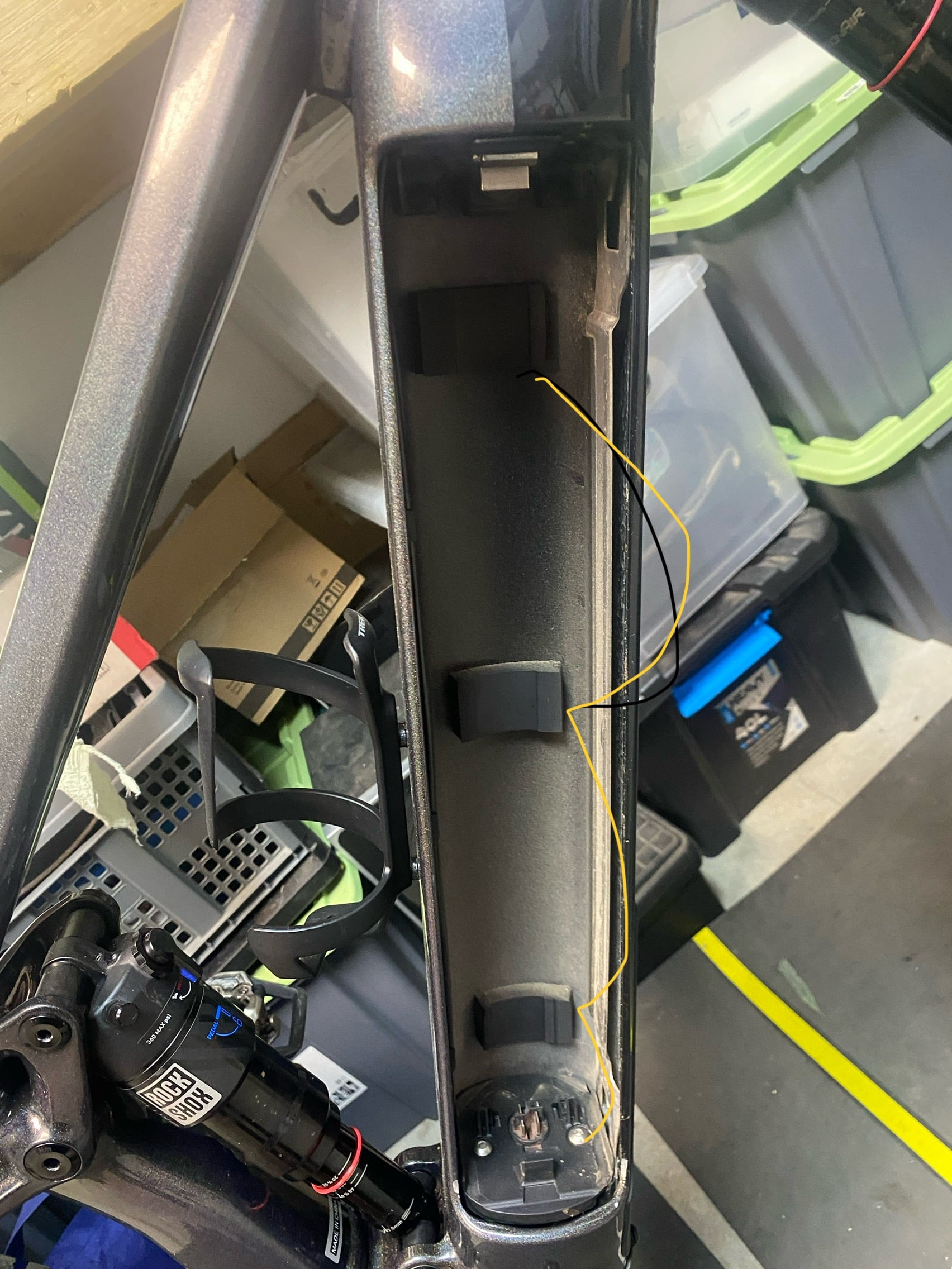

Interesting, did it not have a springy plate in it, before the foam inserts?
Id get a picture but not near my bike currently.

Hi Geedog from NZ,
I own a Trekrail 9.8 2021 gen4 having riding over 6000km without any issues. Just looked at your photo of the battery cavity, my first impression is the male battery contacts are dirty. The battery has a heat sensor which when the contacts get warm will trip out the battery (safety feature). Remember low voltage high current is passing through these contacts. I suggest you clean the contacts to a polished state, check the base of the contact plate screws are tight as this will cause misalignment. Use ENOX to clean the contacts then apply very liberally dielectic grease to the battery contacts also the male contacts. The dielectric grease will keep moisture and dirty out of the contacts. Happy riding.
Hi Geedog from NZ,
Hello, mature biker, thanks for the advice, I shall do that, though the bike in the picture is not mine. I too have 2021 9.8 that has been brilliant, with at least 12k miles, and on 4rd motor though. And I love the 2024 model, it rides superbly imo, just a bummer it keeps cutting out, would like it sorted before the warranty runs out though.
