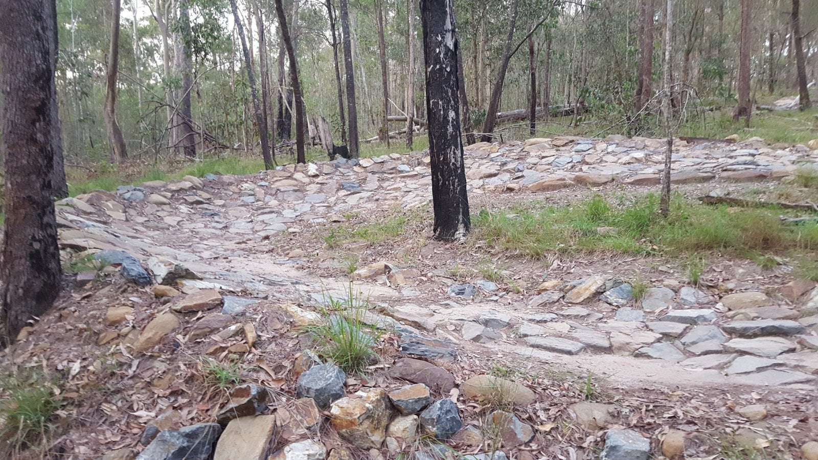

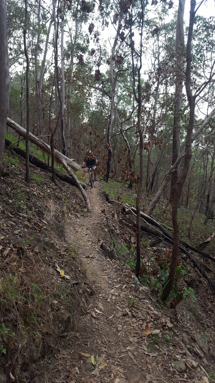

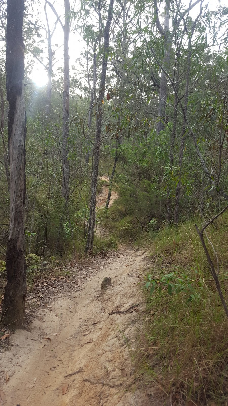

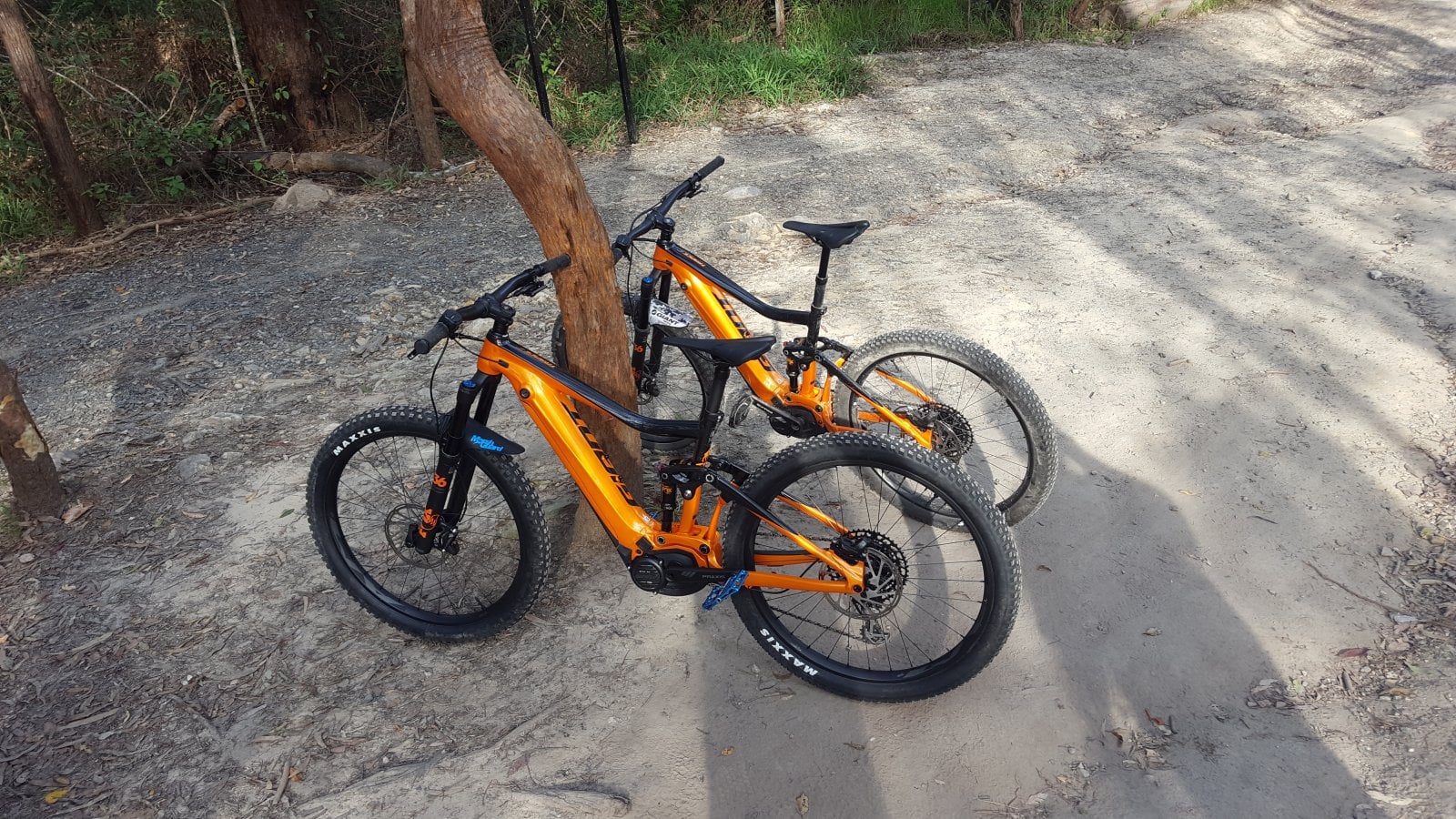

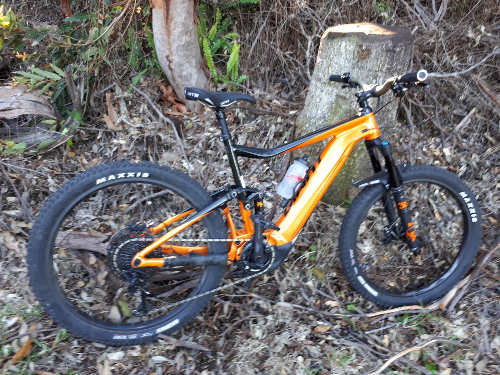

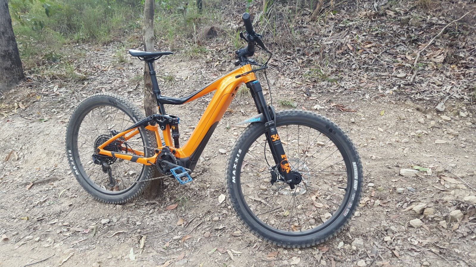

Had a quick ride this afternoon with paul sonofwilliam after work. Really enjoying the bike, it's had it's teething issues but they seem to be sorted and its a cracker.
Ride was in our local Nerang State Forest where we were lucky enough to have the Comm games in Aus this year.
This is one part of the games track, nice rock berm.

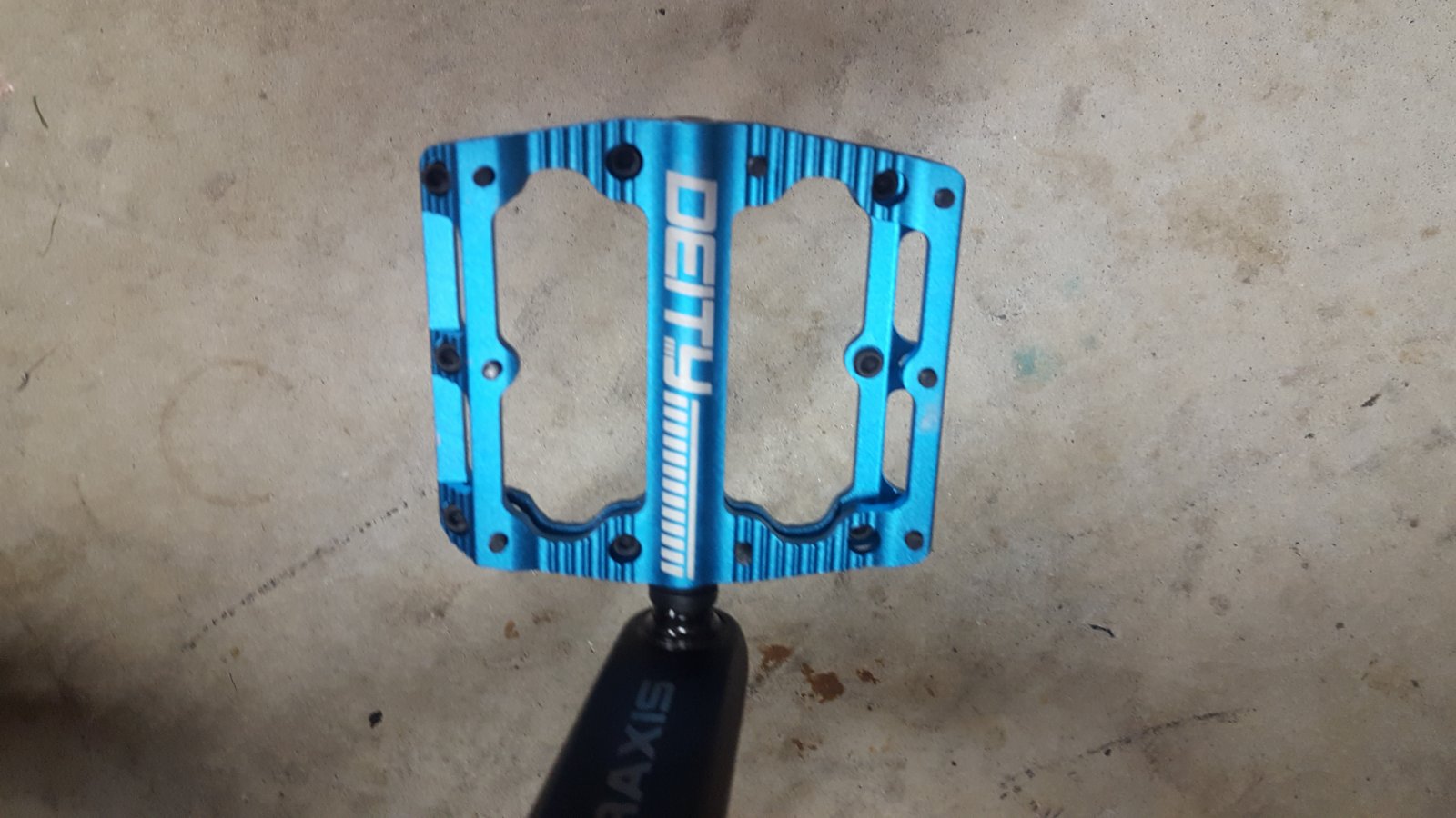

Cheers for posting the pics @poppy. Liking the blue pedals. Was planning on that for mine when it gets here, but it’s good to see what it’ll look like. Looks great by the way.

G'day mate, nothing major, on my 1st ride bike was great for about 15klms, then started turning itself off. I rode another 9klms and it did this 8 times. Would alway's switch back on no worries, more frustrating. Then when i got home i thought i would read the manual and whislt reading, throw it on charge. The charger went pop and that was that. Bike shop has looked after me well and have been helpful the whole time, gave me another charger and sent the other one back to Giant. They got onto Giant about the bike turning off and they kept insisting it was the battery lock. Second ride same things happening at about a similar distance. Back to the shop only this time i took a video of it happening so i could so the shop. Only this time Paul's bike dis the same thing, so they both went back. The boy's at the shop were back onto Giant again. Same thing, battery lock. Anyway, long story short, they re-adjusted everything and we went riding again and have no more issues at the moment.

Yeah, apparently the lock adjustment has to be just right or the movement will shut it down. My battery is locked in a lot firmer now, which is noticeable when removing and installing the the battery. I had another issue the other day with the switch powering up after i washed the bike. I washed it with some soapy water in a spray bottle and rinced it off with a bucket of fresh water and a sponge, then chamois dryed it. The bike actaully switched itself on and would not turn off without battery removal. Then all the lights on the switch came on. I actually pressed the buttons with the battery removed and had the switch light up as well, so seems like a capacitor held charge. They have a new switch on order for me.
I went for another ride on Thursday afternoon and did 21klms with 451mtrs of climbing and the bike went awesome, not a single issue.
