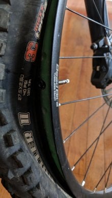

I went tubeless today, the tape was green. Intsallation was a snap and was done 1st try on both tires with just a floor pump. The verdict is still out as I won’t be able to take a proper ride till the weekend. I am a bit leary of the low pressures as I’ve always run a bit high to be on th safe side, but I’ll be carrying spare tubes and a plug kit just in case.

Did your wheels have a green rim band rather than an adhesive tape ? I have asked slang about them but they don’t seem to know where they have come from . The rims should be taped by spank , or have a have a white colour tube protector band . It seems commencal must have used the green rim band , which has worked fine tubeless so far , but Iam still not sure if it was intended for tubeless use .
OEM green tape is still working fine after hundreds of miles tubeless with the original tires. I had a slow leak and found the valve to be a bit loose.
It does seem to work very well , although I don’t believe it was really intended for tubeless at all . The bead stick to the rim band and it gets distorted eventually . I’ve recently replaced my front with with the cafe latex brown tubeless tape as shown on the stank video , I did the two wraps overlapping . The rear I’ll do soon when I change the tyre , but it’s still find with the rim band at 1400 miles and 3 or 4 tyre changes etc . I guess with the rim band we’re nit getting the advantage of the soank bead bite ridges ?
