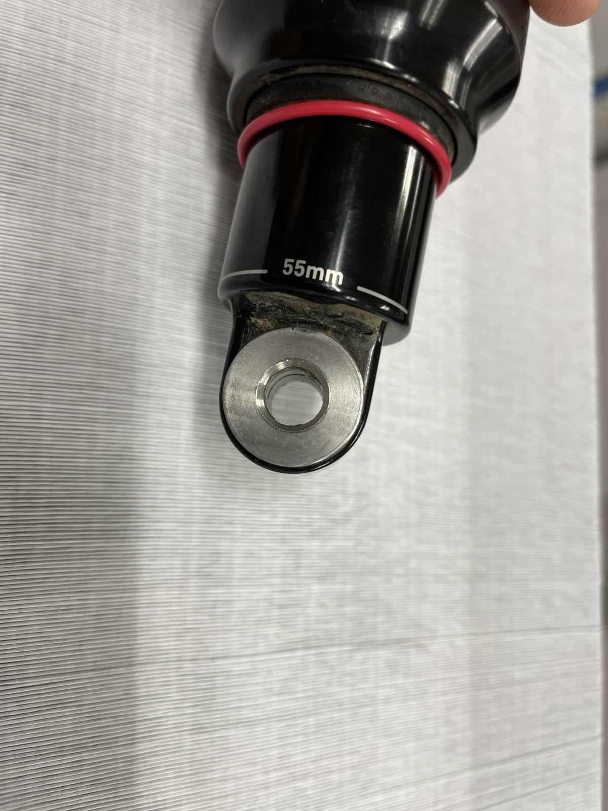

Bringing this thread back up because having same problem. I had an X2 fail on 2020 Levo SL and want to use a spare shock that already has these top hat spacers pressed in. Wondering if anyone knows a sure method to remove? ID of spacer is 8mm and I'm going to try a bearing extractor, all other tools I've tried are a fail, pliers, vice, small flathead screwdrivers to pry lip, can't get a grip on them and no way even a super fine screwdriver is getting under the lip. Why is this so difficult?

thanks for that, was exactly right. Also here's an more detailed explanation from Specialized that should help anyone else that has same issue:
"I have found it easiest to use a small bladed flat head and wedge it between the space where the top hats meet inside the eyelet. I will wedge it (screwdriver) in there and slowly use a soft mallet hammer to push (hammer) the opposite end top hat out. You will need to readjust it to move around the circumference of the top hat until it cleanly pops out. Once one side is out, it is very easy to just use a screwdriver to pop the other spacer out.
I have found it helpful to use a vice of some sort to hold and elevate the shock so I can get clean strikes on the spacers.
Just be careful not to hit the screwdriver into the shock eye body. The spacers are pretty heavy duty and are meant to be removed this way. Consider replacing the top hats only if there is considerable damage to the flange. "

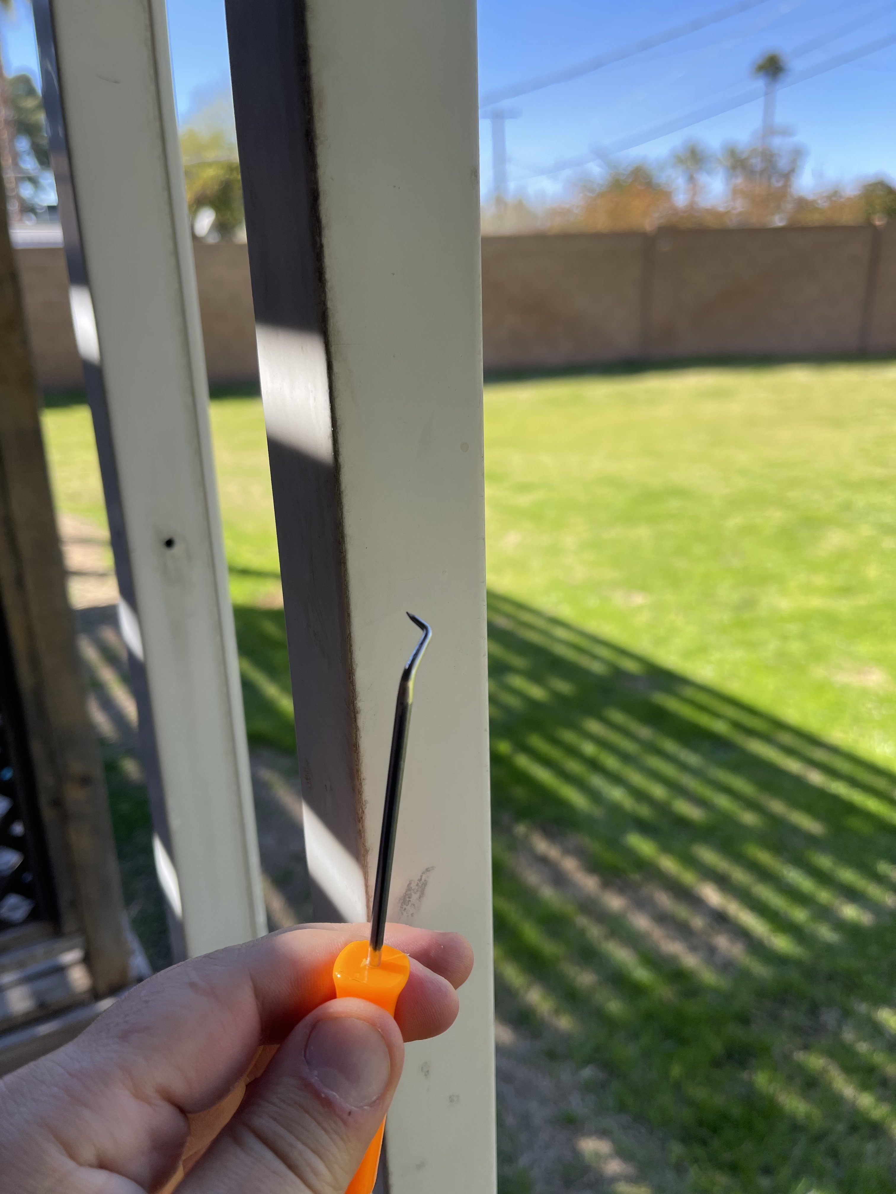

Just like squeegee says, but I used one of the little curvy picks from harbor freight, wedge it in between that gap and rock it back-and-forth evenly on each side until it starts to work it’s way loose
