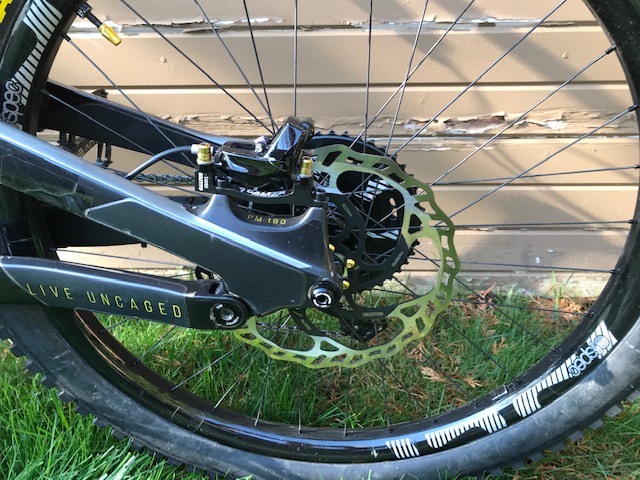

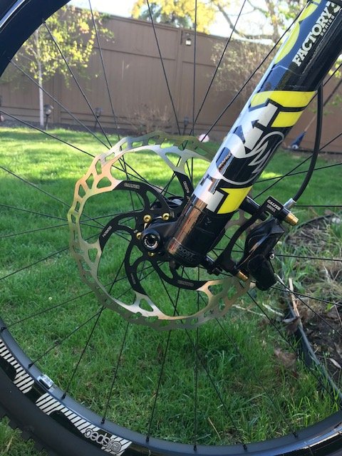

Change #1 - Upsized to Galfer 223mm rotors front and back
Comments: IMO the best upgrade I have done. The Galfer rotors are slightly thicker 2mm than the SRAM and the power is now on par with Shimano Saint brakes (with 200mm rotors). The best benefit however is the added modulation that SRAM codes provide. So if your experiencing brake fade and want more power, you should consider this upgrade. I also bought the Galfer pads (e-bike version rear .. race version front)
Pros : More power and great modulation
Thicker rotors (less warping)
Bling - they look cool and menacing in 223mm size
Very quiet , no squealing (using Galfer pads)
Cons: Heavier than stock
Pricey as you will also need adaptors
Overall: 5/5

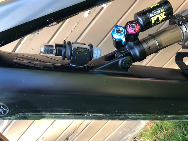

Change #2 - Added Stans Dart Tool to frame
Not really an upgrade, but added a STANS Dart tool just above the upper shock mount. Used 3M clear plastic underneath and epoxied a handpump bracket to hold unit (fit perfectly). Slid a couple of O-rings over the unit to keep in tight and in place.
The reason I did this is because I hate riding with a camelback .. so having the dart took always available in the event of a flat is handy. I now wear a thin runners belt with a mini hand pump and room for my keys and iPhone (ok its a runners belt NOT a "fanny pack" - LOL
No reviews on this one as I have never used it and hope not to ever use it.

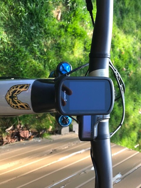

Change #3 = Bought a new Garmin 830
Installed a Garmin 830 using the Edge stem cap mounting unit. Did NOT want to look like a spandex warrior with the unit out in front. The stem cap mount works very well.
Pros: Love the jump and Airtime feature (for those who send it )
Doesn't look "roadie"
Love the accuracy and software integration
Cons : Some may consider "roadie" anyway.
Enough reviews on this unit .. so mine is irrelevant. ** But I will give the Jump distance and Airtime feature a 5/5. Hey what can go wrong trying to beat your last run jump distances :unsure: (as you compare stats with your buddies in a bed unable to move - lol)

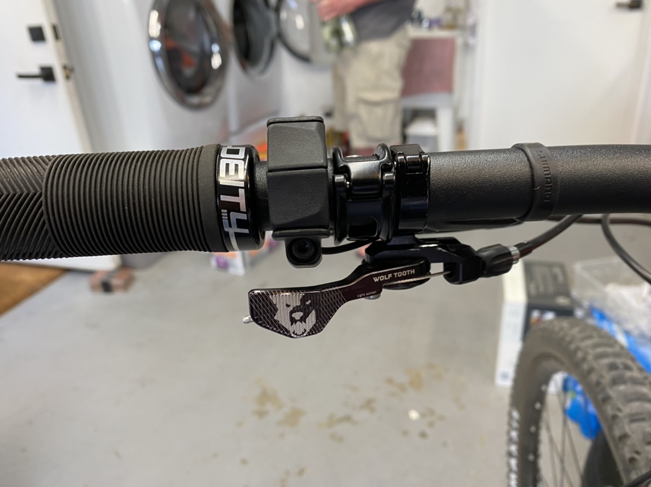

Here is the first round of upgrades. Much more to come, just waiting on parts.
Wolftooth lever and a fox transfer 175mm. Was gonna keep the stock dropper until I felt the lever. When was just gonna switch out the lever only but needed to take the seat off anyways to cut back the cable housing. Once the seat was off, just swapped it out for my fox post. Glad I did even though taking the motor off to route a dropper post sucked. Taking the motor off in general sucked. (How do you work on a bike with no bb/motor or no seatpost?)

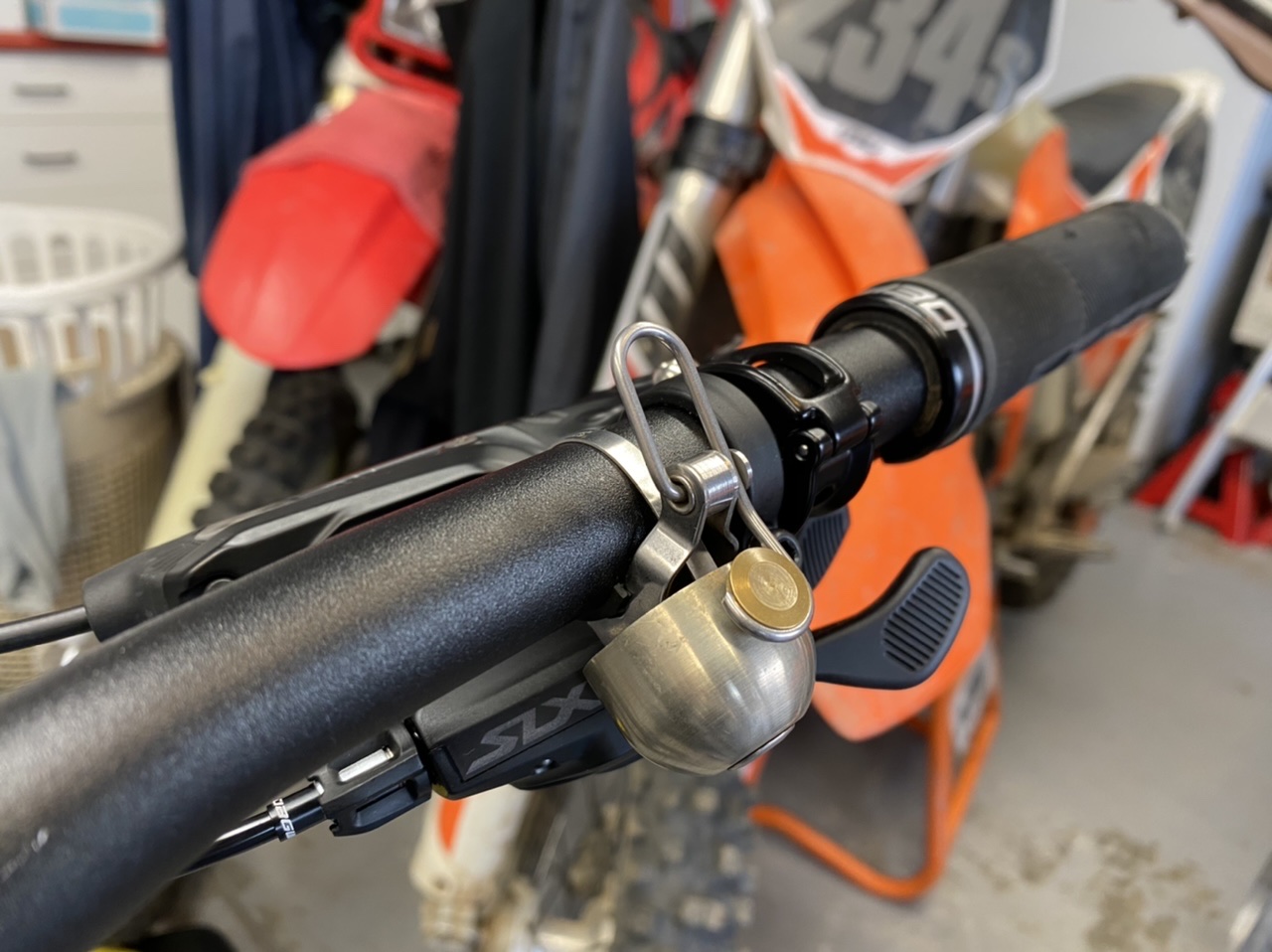

Also put on my spur cycle bell. Best bell money can buy. (Also most expensive. Lol) Needs to be close to the grip so I can actually use it while riding normally, but there isn’t much room and I like my brakes pretty far out.
And put on my Deity knuckleduster grips, they are old but didn’t like the hard ODI’s that came with the bike.
Specialized saddle. I have had this over my last 4 bikes and it hasn’t failed me yet. Plus didn’t hear great things about the YT seat.
First ride on the bike tonight was a success. Can’t wait for many more to come.

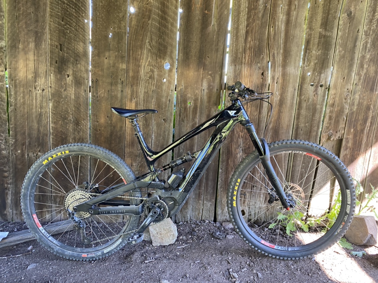

Next upgrade:
Custom ex511 hoops laced to dt350 hubs. Nothing blingy, but tried and true and have yet to fail me. Also have a downhill casing DHF and DD aggressor tires. Exo is too flimsy for an ebike.

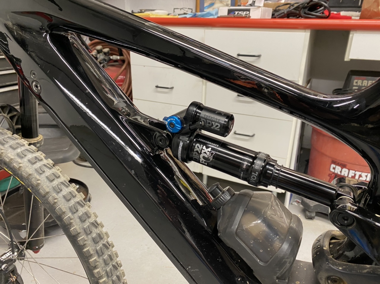

More upgrades.
Dpx2. Nothing exciting since the pro 29 already comes stock with this shock, but should help a lot for the base model. Factory/Elite models are unnecessary according to a knowledgeable person at fox, since the shock works best in this “setting” anyways.

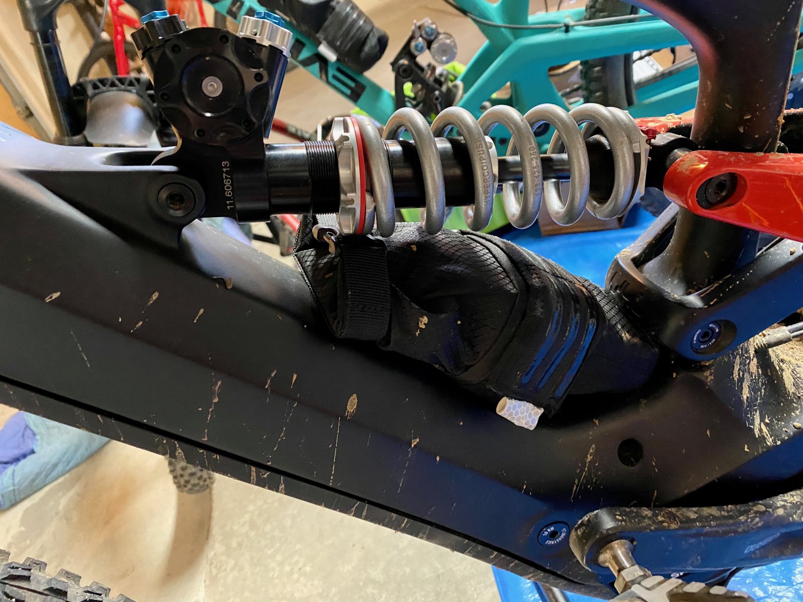

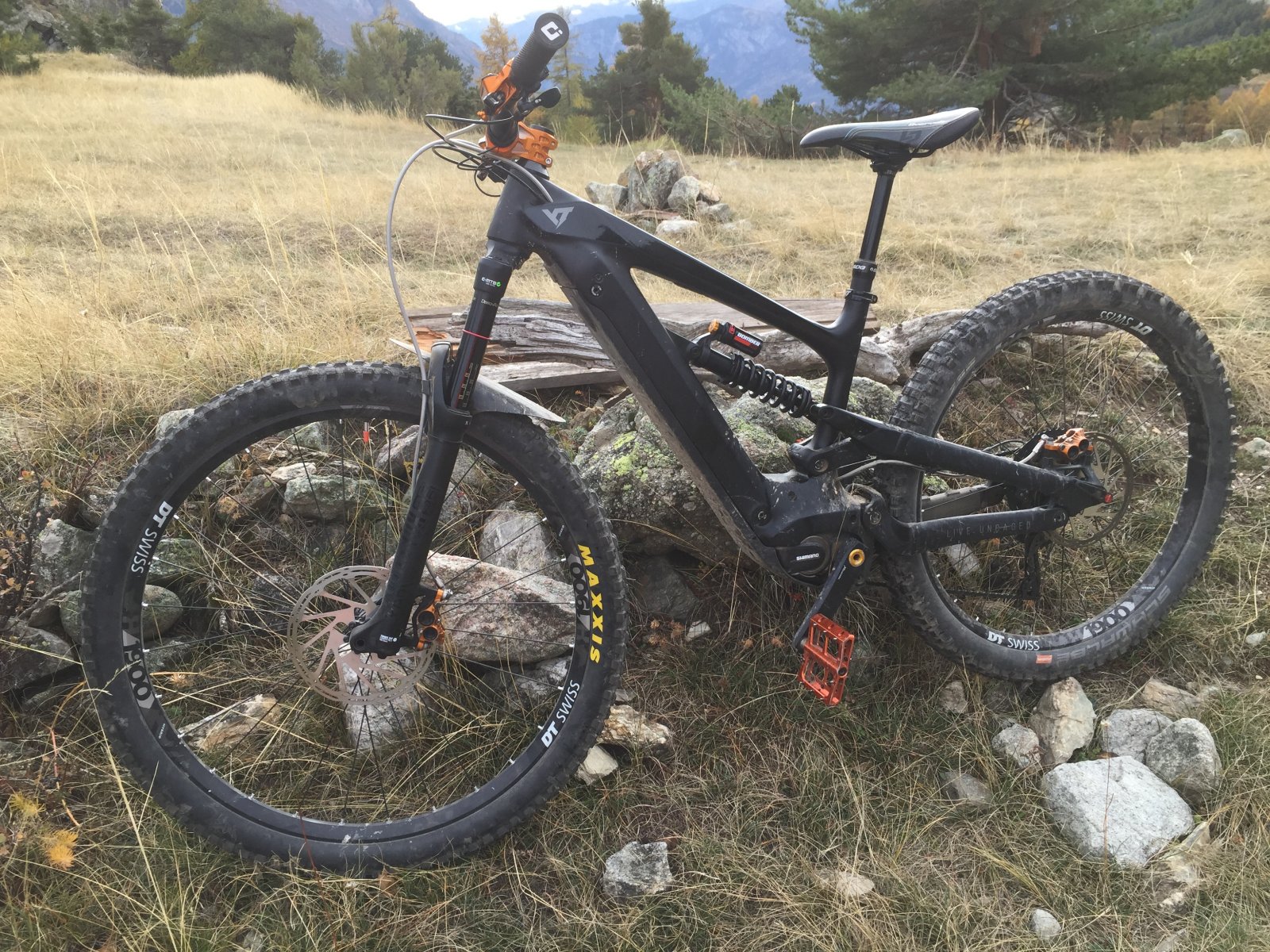

First "upgrade" was to fit a set of Hope V4 brakes that I've had on 2 previous bikes, not sure if it's an upgrade or not over the Codes that came with the bike as i never used them!
Hope stem to make the brakes, natch!
Metal end caps on the cranks so they don't fall off (colour coded to the brakes and stem of course) Note: since the photo was taken, I've now got the correct colour for the end caps :D
Biggest change so far was the Marzocchi Bomber rear coil, this has transformed the feel of the bike, now super plush and adjustable!
To go with the shock, I fitted a 170mm airshaft to the stock Yari and gave the fork a lowers service at the same time, this brings the front in line with the rear and is far smoother, running no tokens seems to make the fork super compliant and no bottoming....

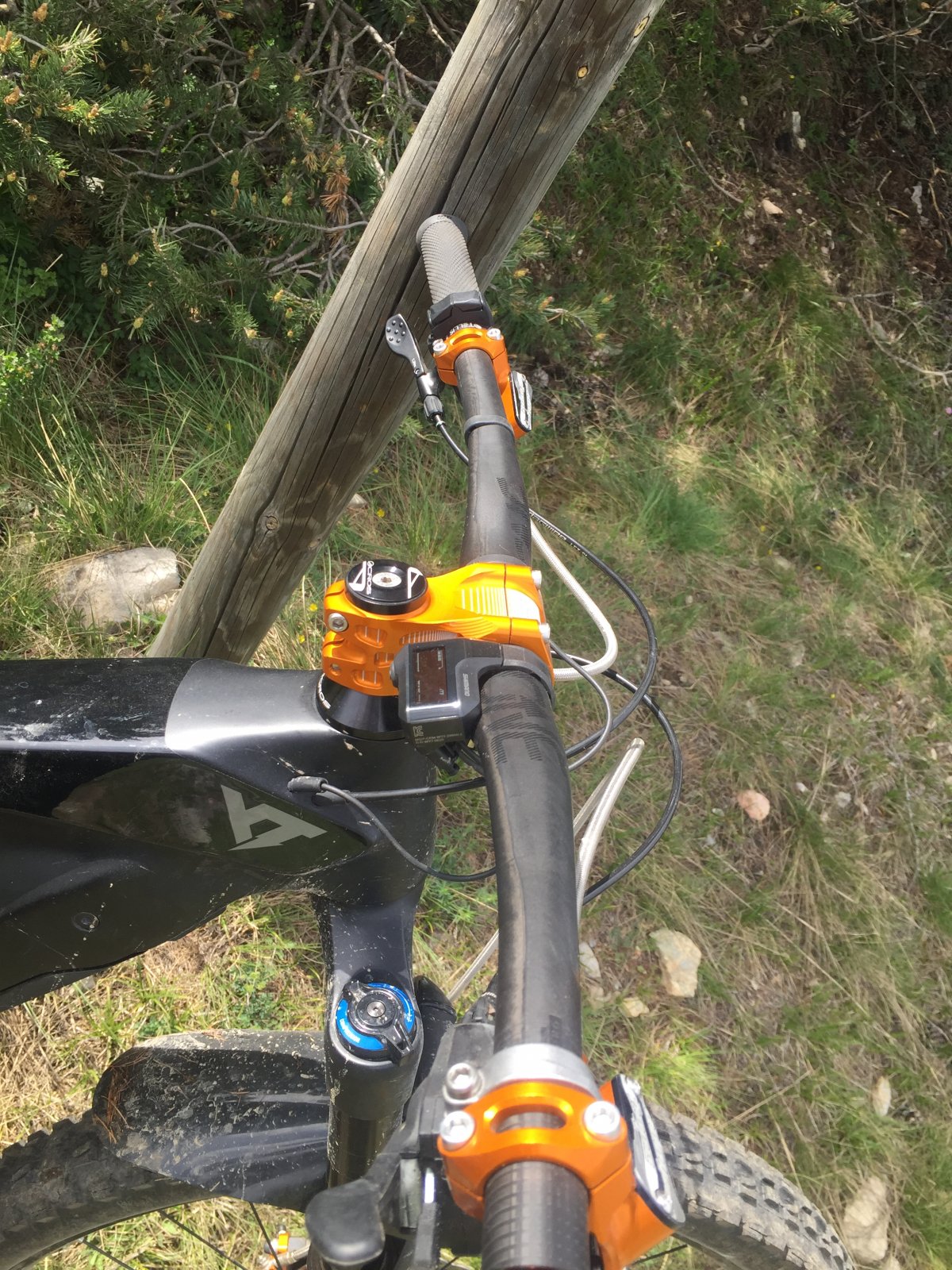

Today fitted a Oneup
carbon bar, 800x20, partly to lower the high front end, but also to damp the front end further, it really works!
For those not familiar with the Oneup, just outside the 35mm stem clamp area, instead of tapering roundly (?) into the controls area, it is flattened to give vertical compliance but not at the expense of steering accuracy.
On my stony/rocky 18km run today it's definitely more damp, now I can only feel the stones, not the pebbles!
Not much to look at, almost stealth-like, but suits the bike!

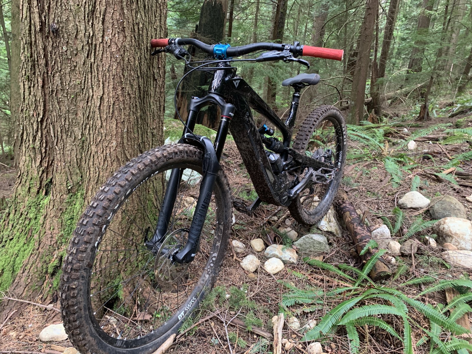

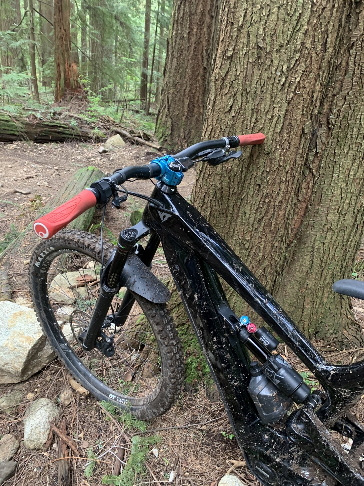

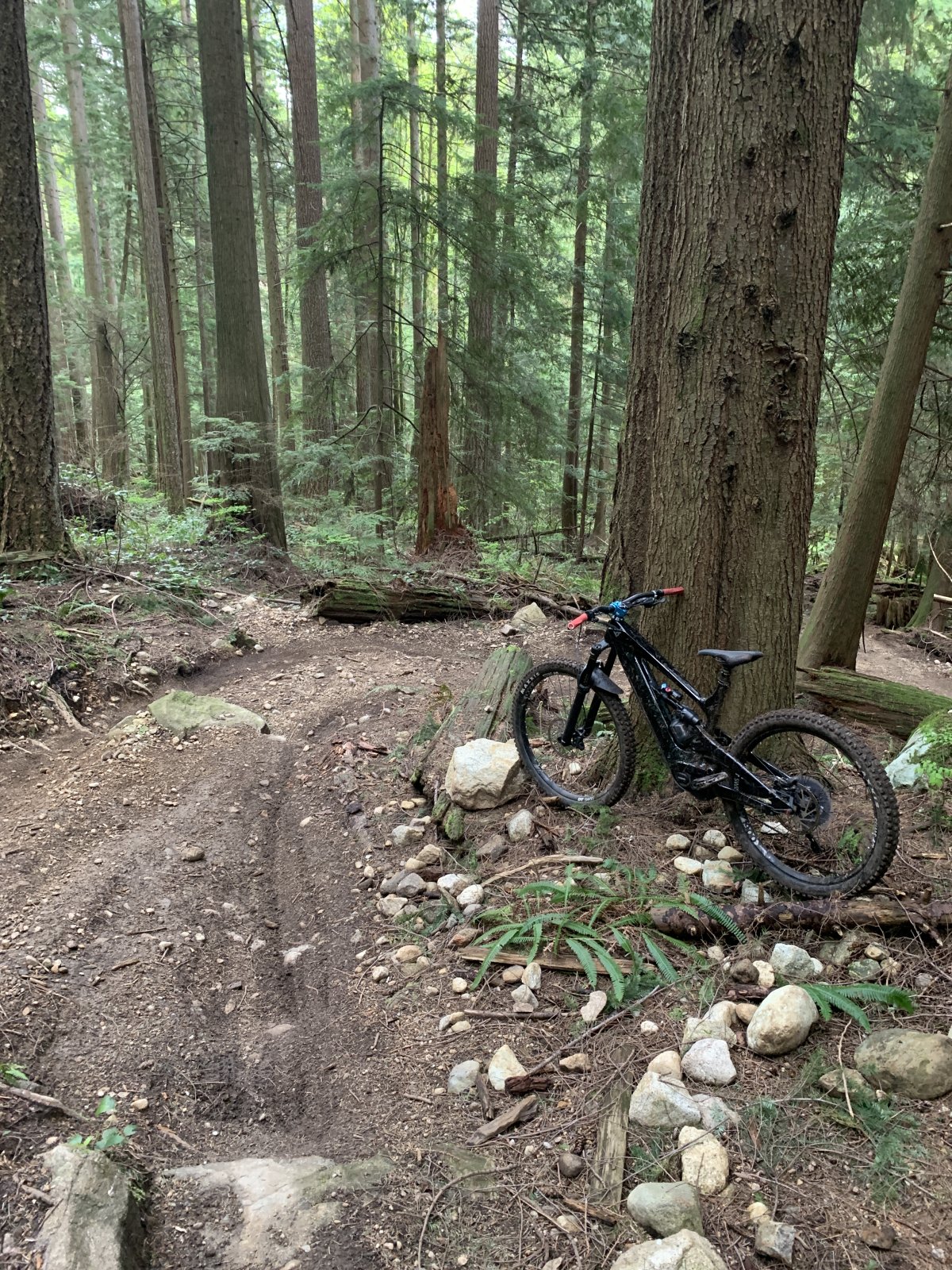

UPDATE:
1) Debonair Upgrade is so worth it on the YARI - Everyone needs to do this if you have the Base model.
2) Custom Decoy Ridewrap installed- Takes a while and I didn't do the best job but at least the Decoy is protected
3) New SQLab 12deg Bar and Chromag stem installed - First ride today and the first time every that my bad wrist did not go numb!!! Win.
4) Fox Float X2 installed and had 3 rides on it.. what a difference... (Also have the flip chip in High Setting) No more pedal strikes and bottom outs.. Feels like a DH bike on the steeps now.
Pics from my ride today.
