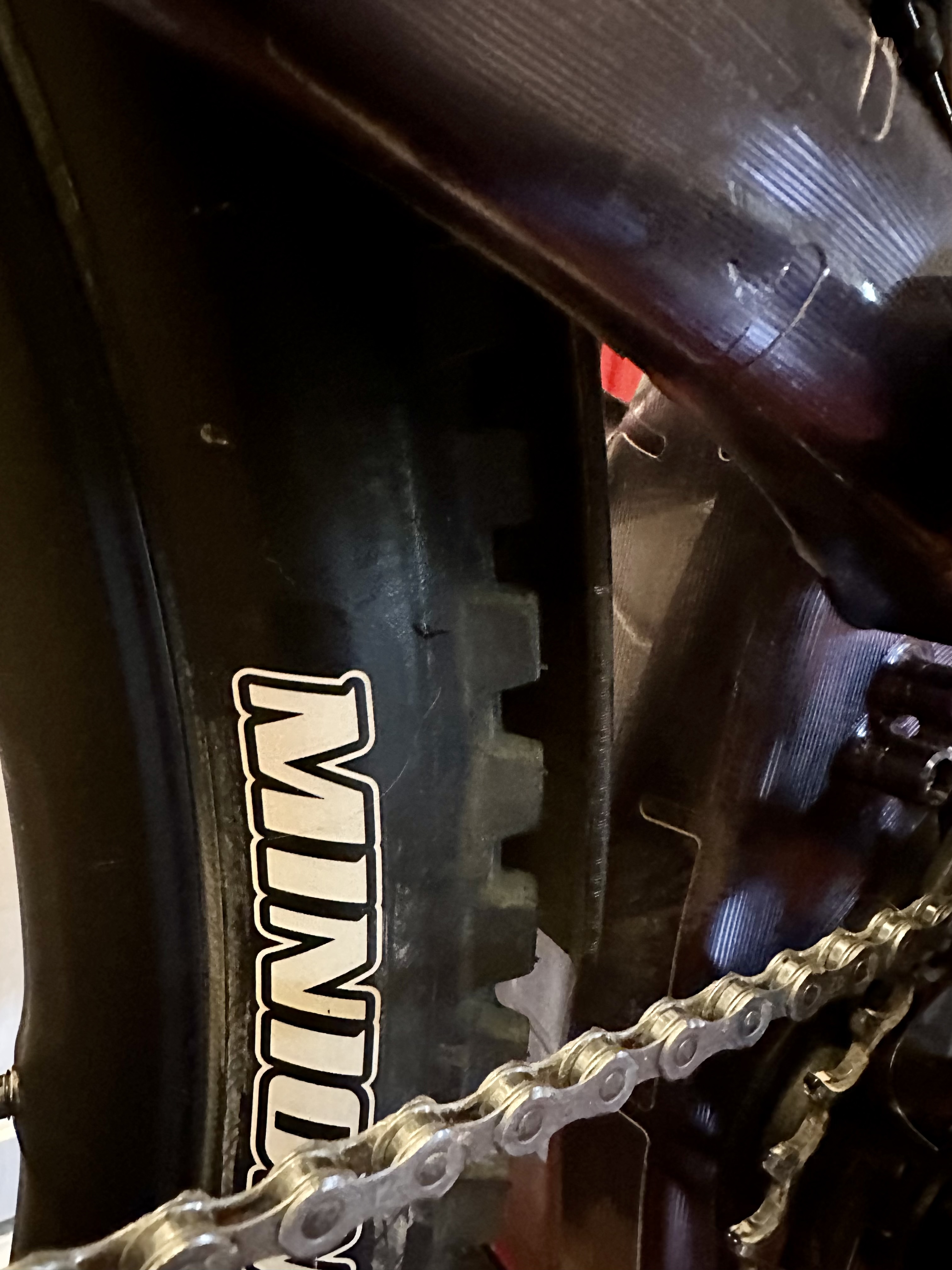

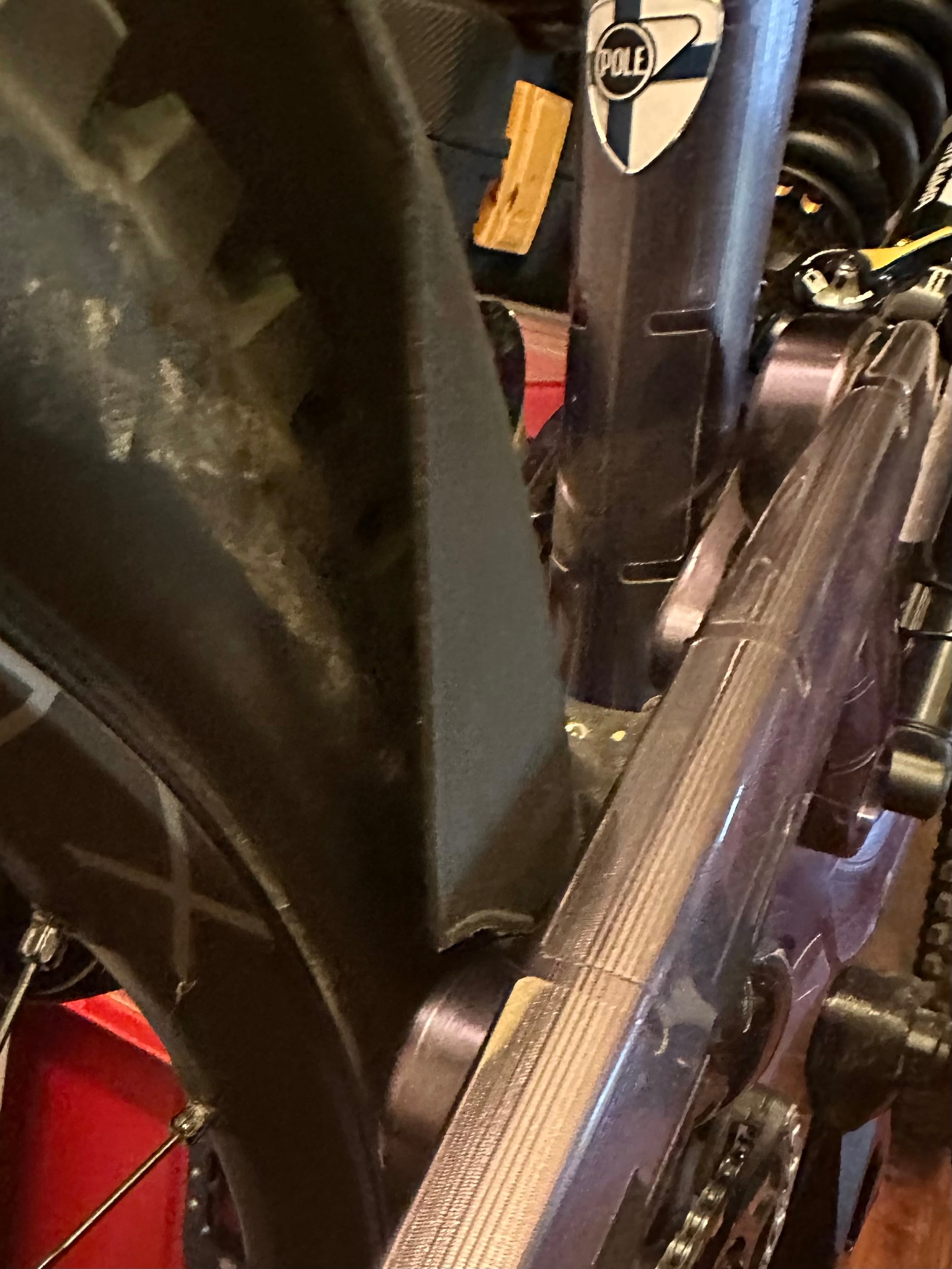

I have one as well, older ribbed short version though. Looks like there’s new smooth redesign available now, not sure how it changed, so all my words are for older versions.
it sits just fine once installed, quality is good, it’s flexible. It has cut-outs in all the right places, doesn’t touch frame at full compression, and generally only contact points are mounting holes.
I wish logo was smaller.
Top portion has a lot of mud clearance on top and sides.
However it doesn’t have a lot of vertical mud clearance at the bottom part on my setup (2.4 wt minion on 30mm internal w rim), not sure how it’ll work in sticky mud.
It’s very flexible down there and I think even if seriously clogged it may work.
I don’t ride in mud, it’s mostly dust here in socal, works perfectly for that.
Despite small issues it’s totally worth it. Good addition and keeps a lot of bearings clean.
