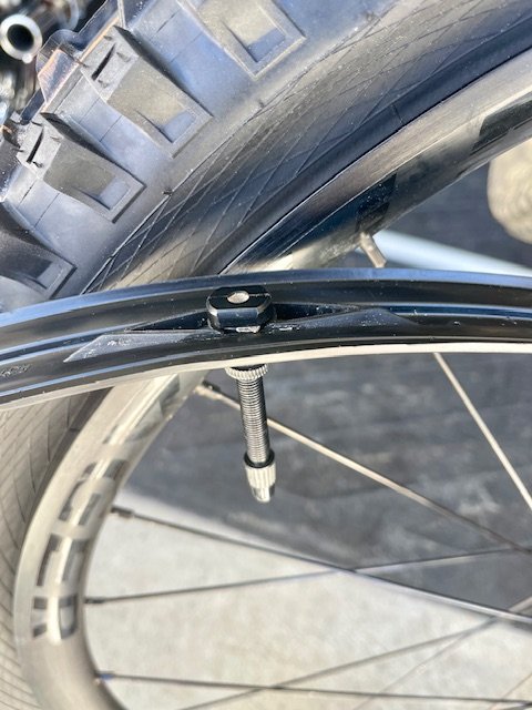

This was the first tire change for my Rail 7. Have plenty of course knowledge on moto and bike tires in 50+ years to know when something isn't right. There was no way the Schwalbe BB's were going to mount with the TLR strip. Could get one side on but there wasn't enough room to get both side beads into the middle at the same time. It wasn't even close. Instead of fighting this and causing damage to both me and the equipment it was time to rethink it. Hense my searching here and elsewhere for information. Thankfully this posting set me on the right track. Replacing the TLR with rim tape allows mounting by hand. In the picture it's a bit hard to see the shape of the TLR but there's no way to get both side beads in the middle at the same time. Another issue is how the valve hole is mouled to hold the Trek stem. The bead is pushed to the outside further hindering enough bead slack to roll it on. Agree with @slomtbr that the system is nice and worked great for couple years, it wasn't going to work for this tire / rim combination.
*Schwalbe BB
