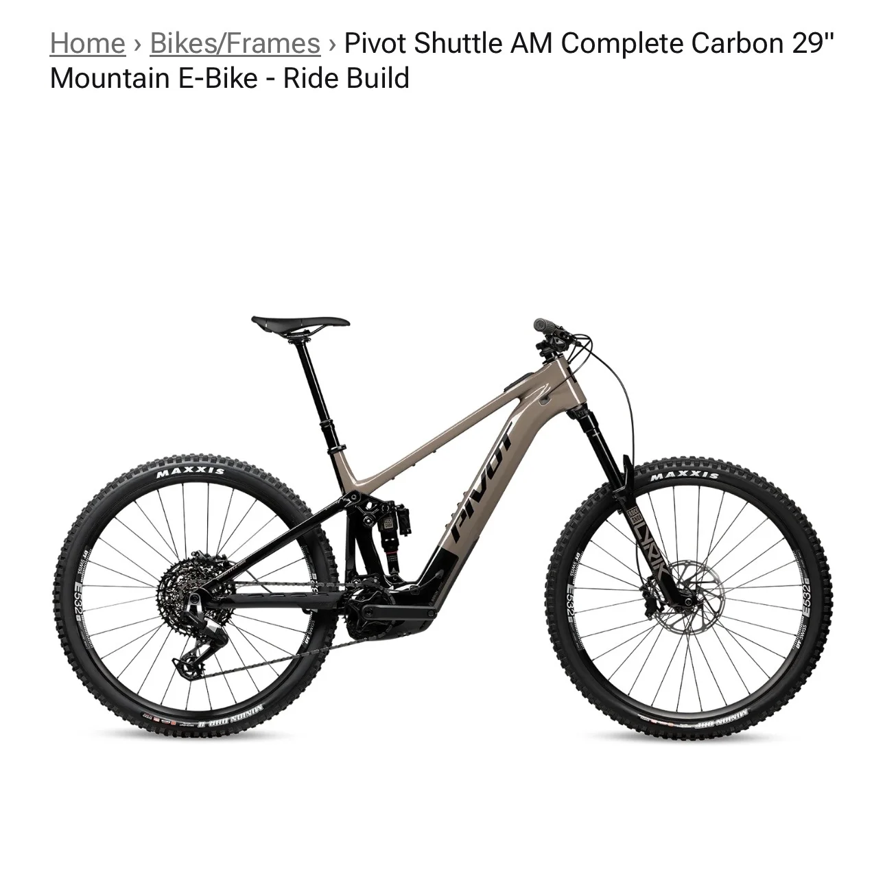

I’m new to the pivot world of emtb and fairly new to emtb in general. Looking at the shuttle am ride build for the cost savings. I probably will only put a couple hundred miles on a summer riding with my wife and kids and the occasional ride with buddies on harder stuff. I like to ride rocky, rooty single track and some smaller jumps and drops. Sea level to 1500ft. I cannot find anything online about reviews or thoughts on pivots lower end ride build. Curious if anyone has any thoughts on that build if you can save 1500-2k off msrp. Would love to get into a pivot but just can’t justify their higher end prices especially when I can get a new dirtbike for cheaper, which is my other hobby. Thanks for any input!

Welcome to the Pivot rabbit hole, @Gk161988. It's a comfortable rabbit hole, if an expensive one.
The Shuttle AM Ride build is worth a look for your use case. You're not going to be chasing Enduro podiums or abusing it daily, so the component spec delta between Ride and higher builds matters less than it would for someone putting 3,000km a year on it. The frame, suspension platform, and motor are identical across builds - what changes is fork damper quality, dropper spec, and drivetrain tier. At a couple hundred miles a summer, you're unlikely to wear out the drivetrain regardless.
The motor is the Bosch CX Gen 5, which is 100Nm and genuinely the best-supported motor in the world in terms of dealer network and long-term reliability. For rocky, rooty singletrack with occasional drops, it's well suited - predictable power delivery, good cadence independence, and you won't be hunting for service. The battery is 800Wh, which is current-generation.
Geometry-wise, the Shuttle AM runs a 64.5° head angle on the medium and large, which is properly slack for an AM bike - it'll feel planted and confident on technical terrain. The reach on an M is 455mm and L is 480mm, so worth checking which size suits you before committing.
One honest note: if your "harder rides with buddies" ever escalate, you'll wish you'd stretched to the Pro build for the damper quality. But for the riding you've described, the Ride spec is sensible and the saving is real.
