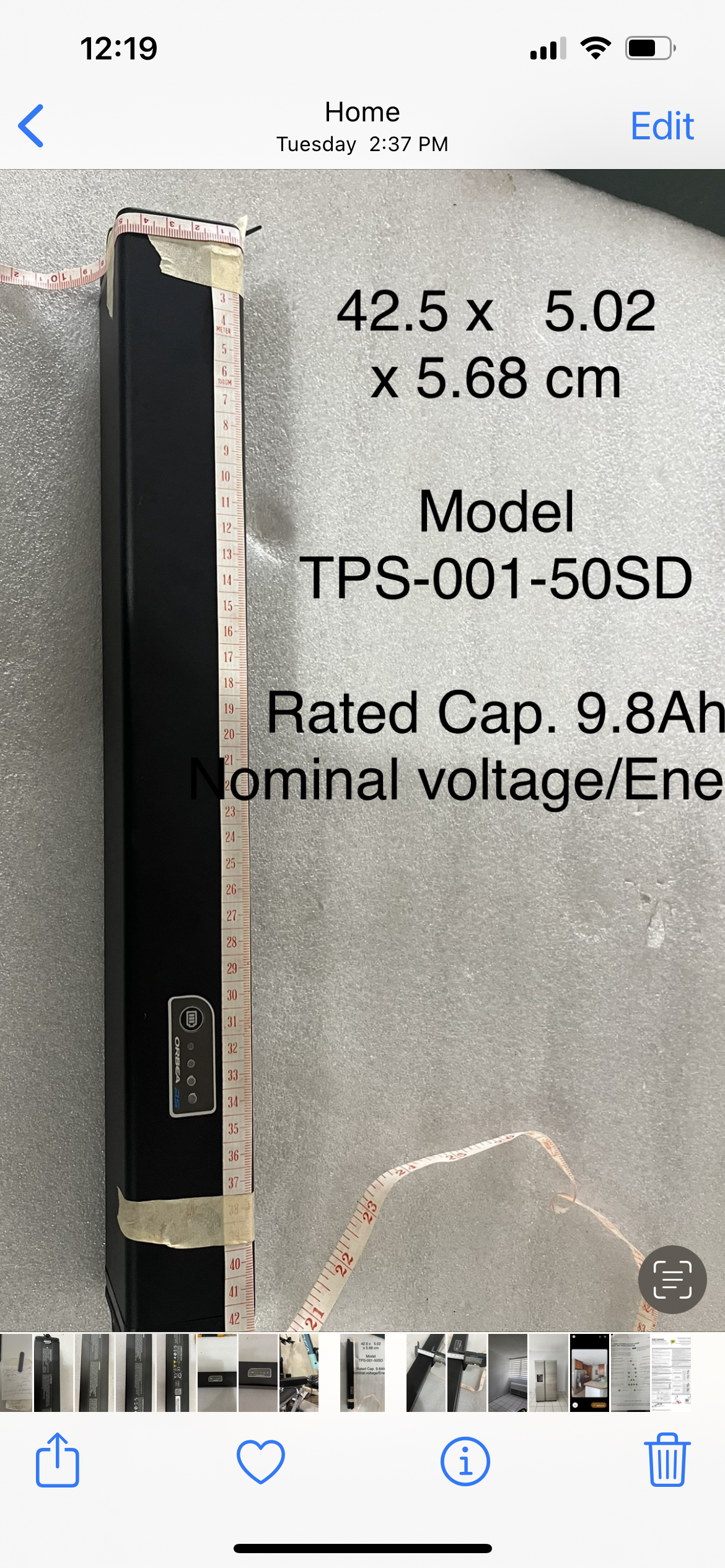

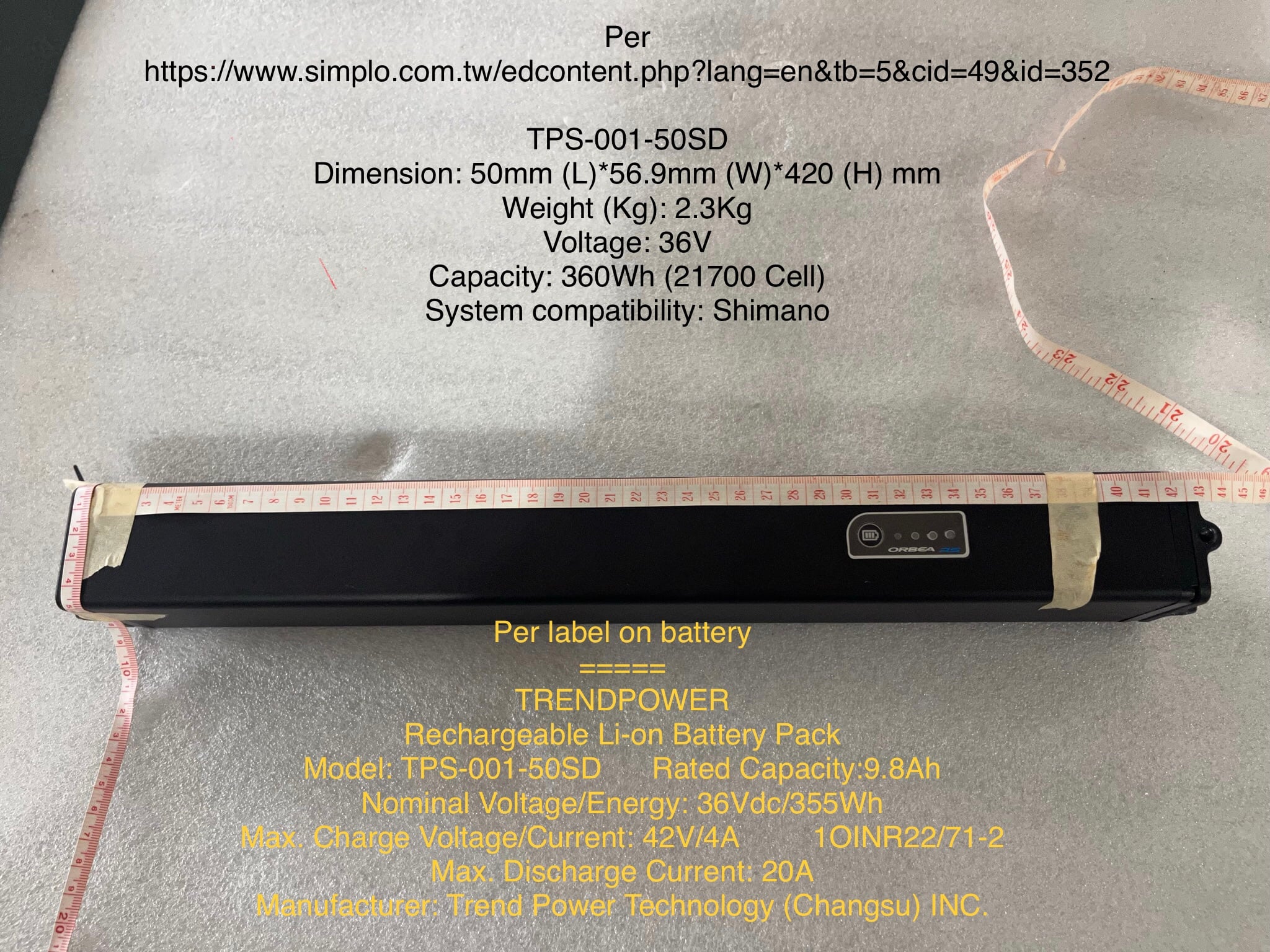

The 360 WH pack is a TPS-001-50SD SIMPLO/Trend Power with 21700 cells LEV High Power
Edmu
Jun 29, 2021
17
Puerto Rico
Battery for the M (carbon) Rise models.
6EC0ABE1-DF99-4955-B2B8-5DACA1CB36F0.jpeg 0EDB630A-8634-4A5A-817C-A3CBF63B73B5.jpeg 386B7E71-D88D-4EC9-8D75-59BC665185FC.png 00C6D2E0-16D7-440F-874C-E6FB8C263448.jpeg
