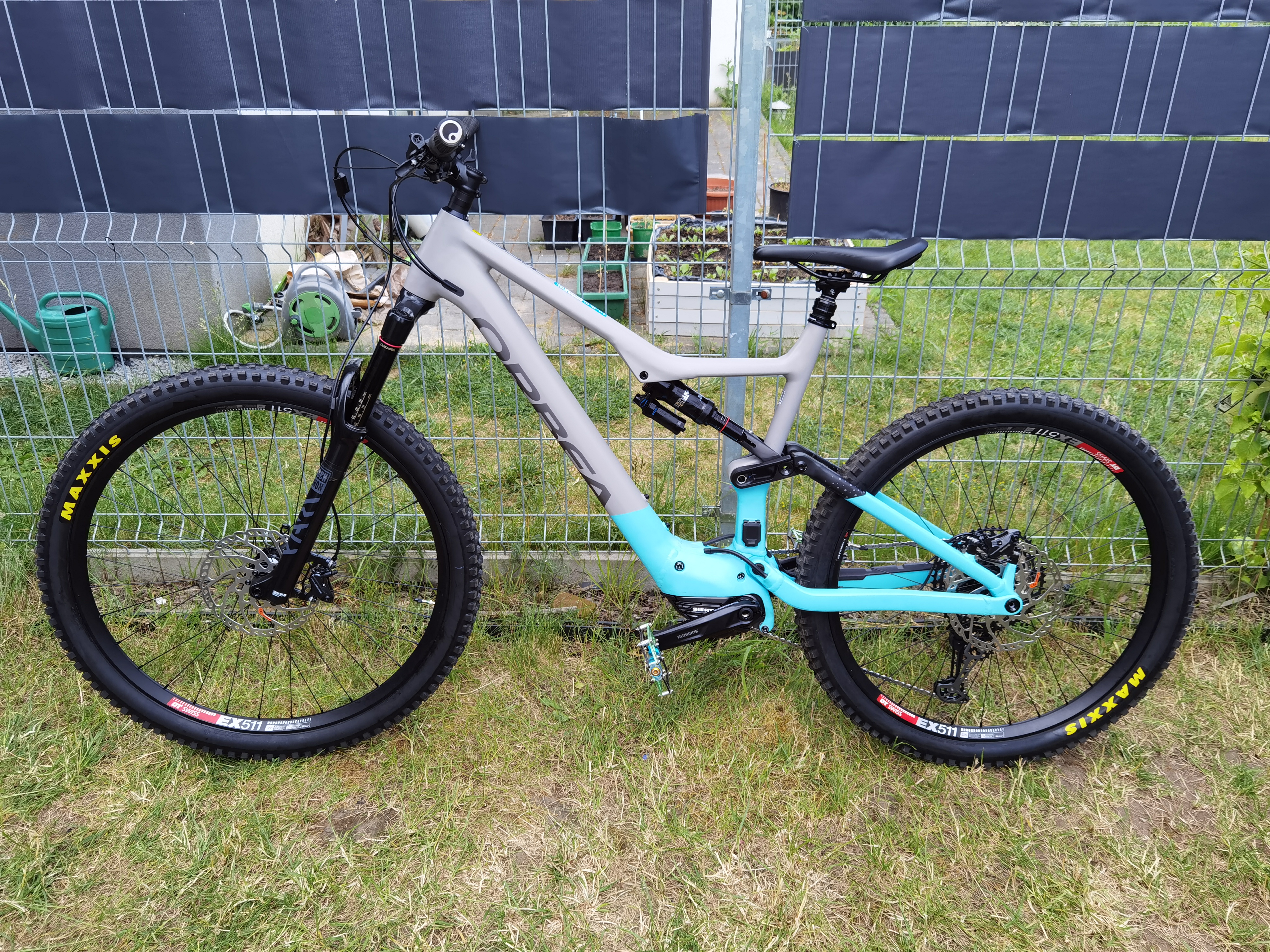

Mine is Mullet from start so I sold factory wheels without ride on 29' set. I also change fork to 150 yari/lyrik and crank arms to 165 and it rides great.
