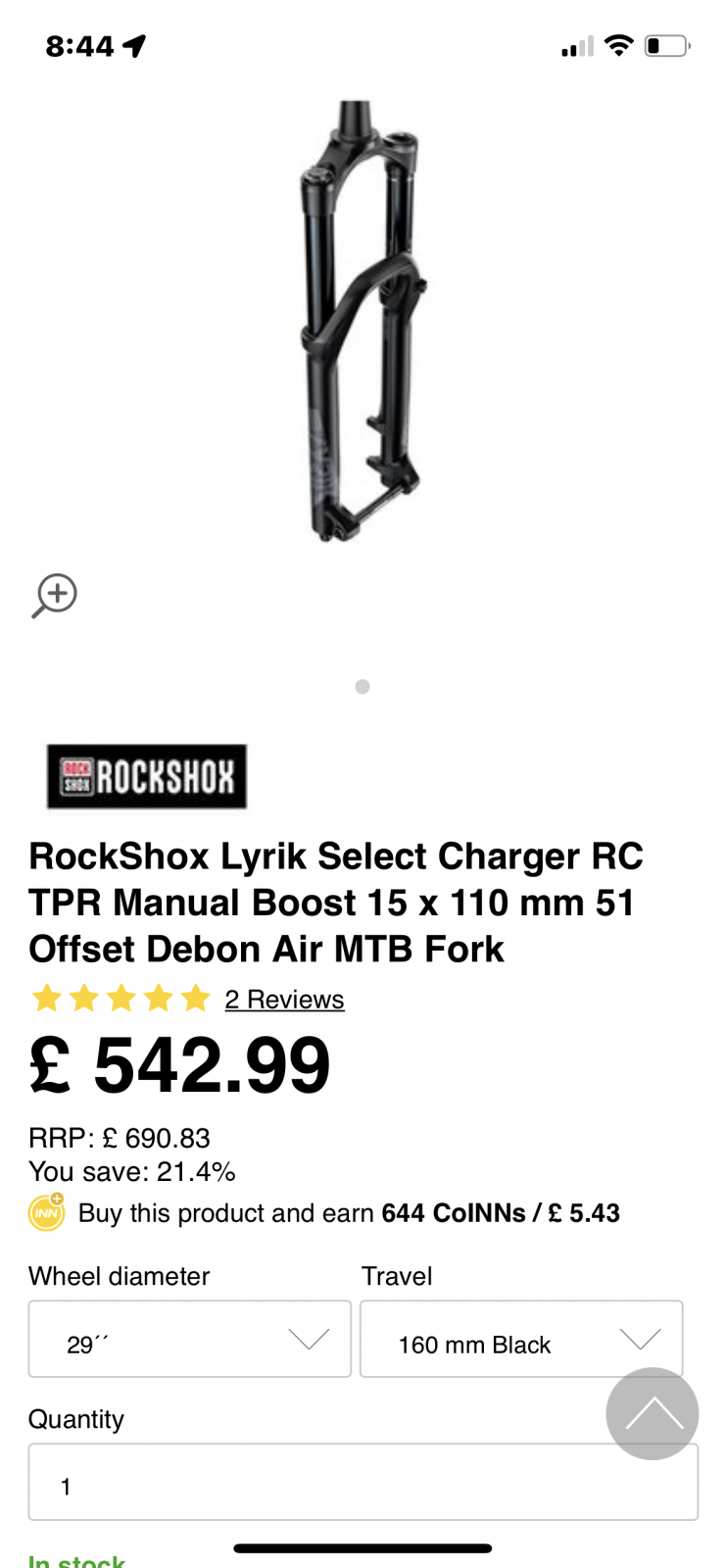

Thanks will do, just found this seems a very good deal or they have the ultimate at £721 🤔
I swaped out the 140mm factory 34's on mine for a Lyrik ultimate 150mm,only 3 rides in but I've found the Lyrik to be a great fork,they even feel much better than the pair of Fox 36 factory I have on my Bronson.
Bought mine with the bike from Sigma Sports,not sure if they have any left,they were on offer for £720.
Right I’ll check them out as that’s a great price, how does the bike feel with the extra 10mm in height ?
