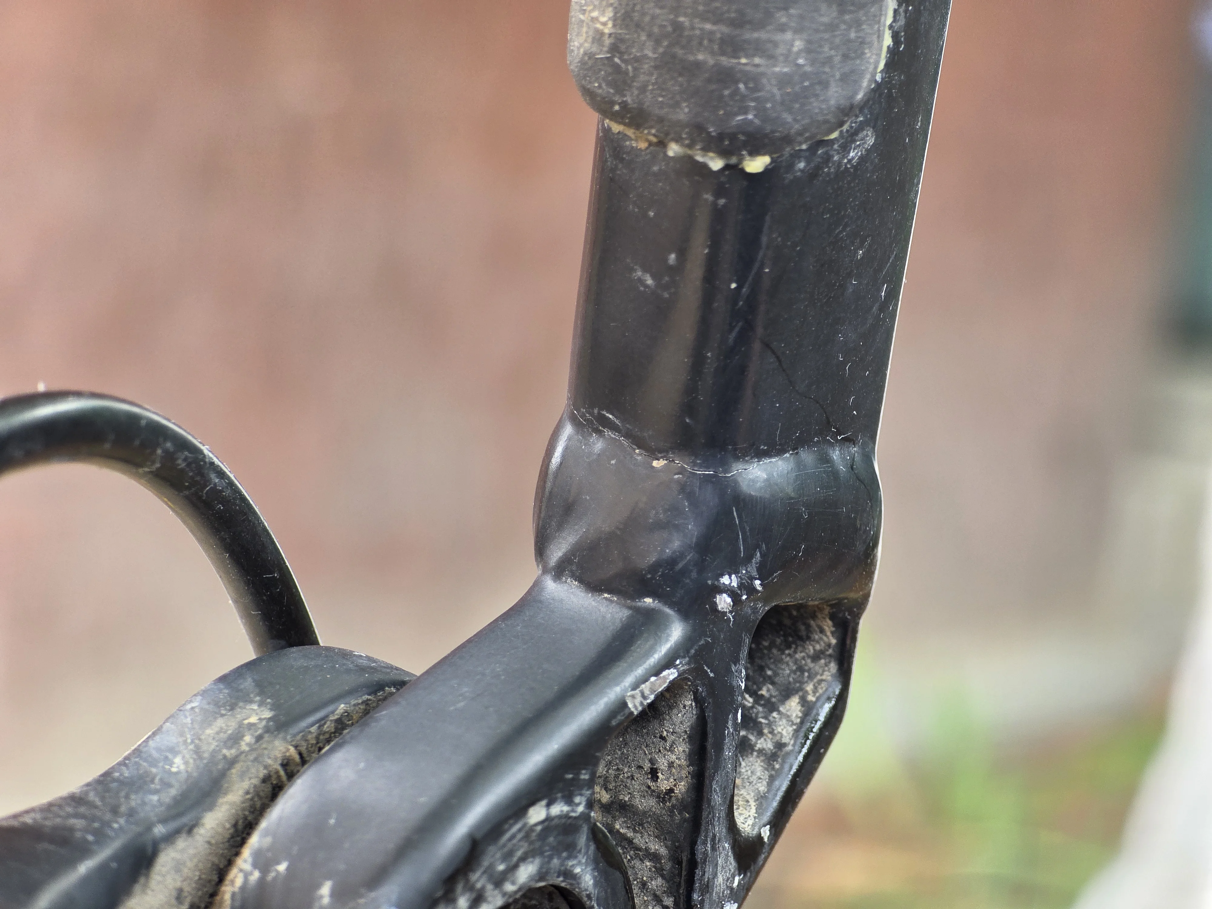

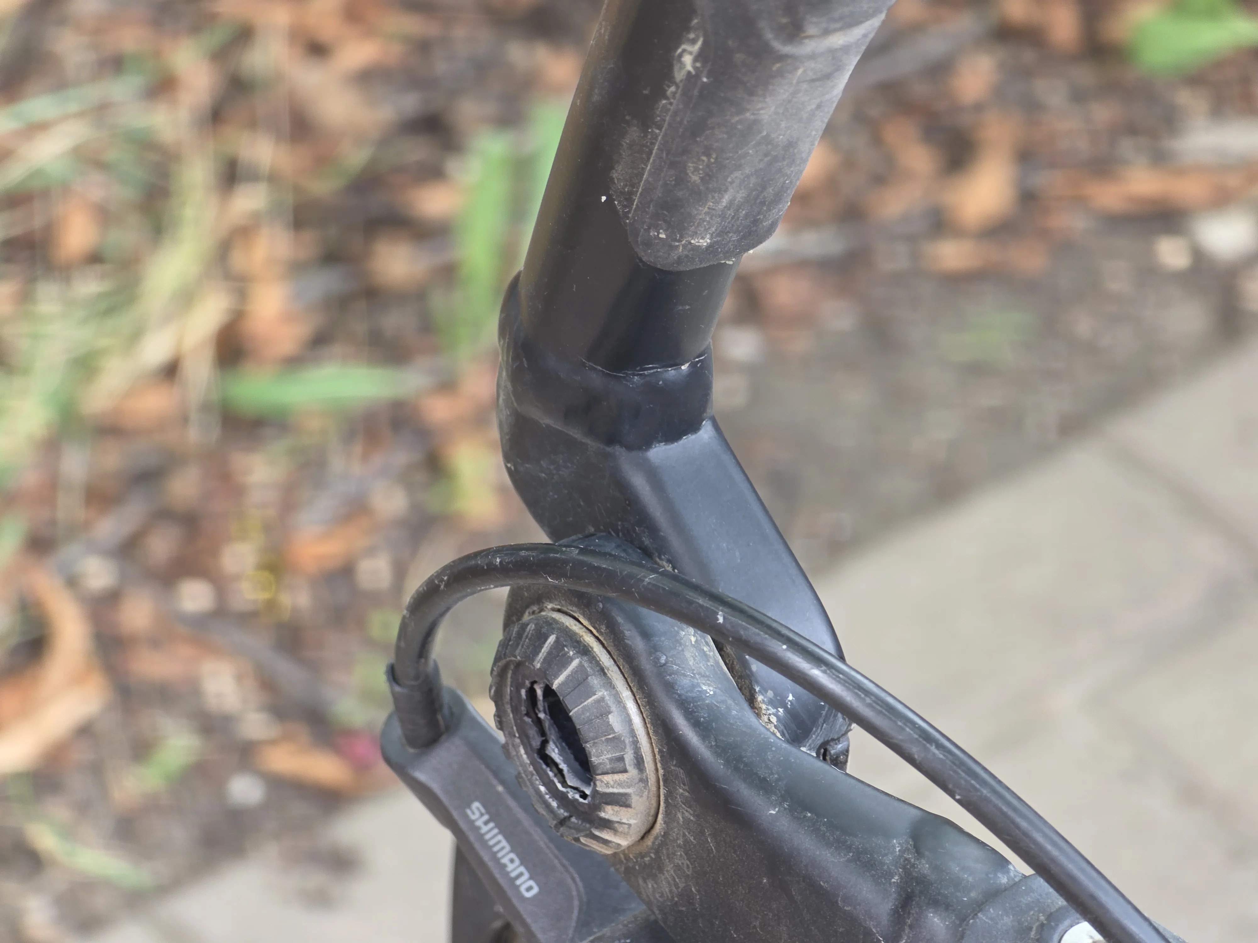

The aluminium rear triangle has developed a crack on the right seatstay at the weld next to the cassette.

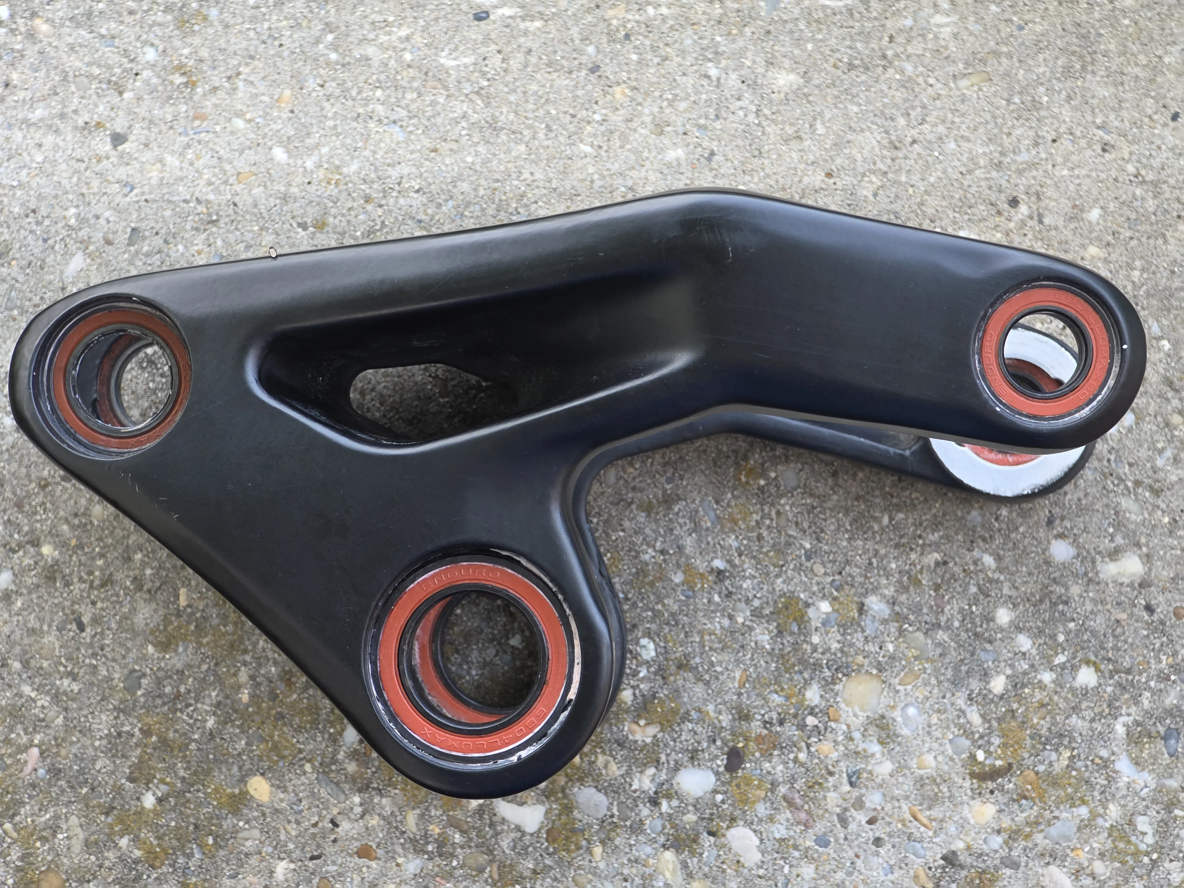

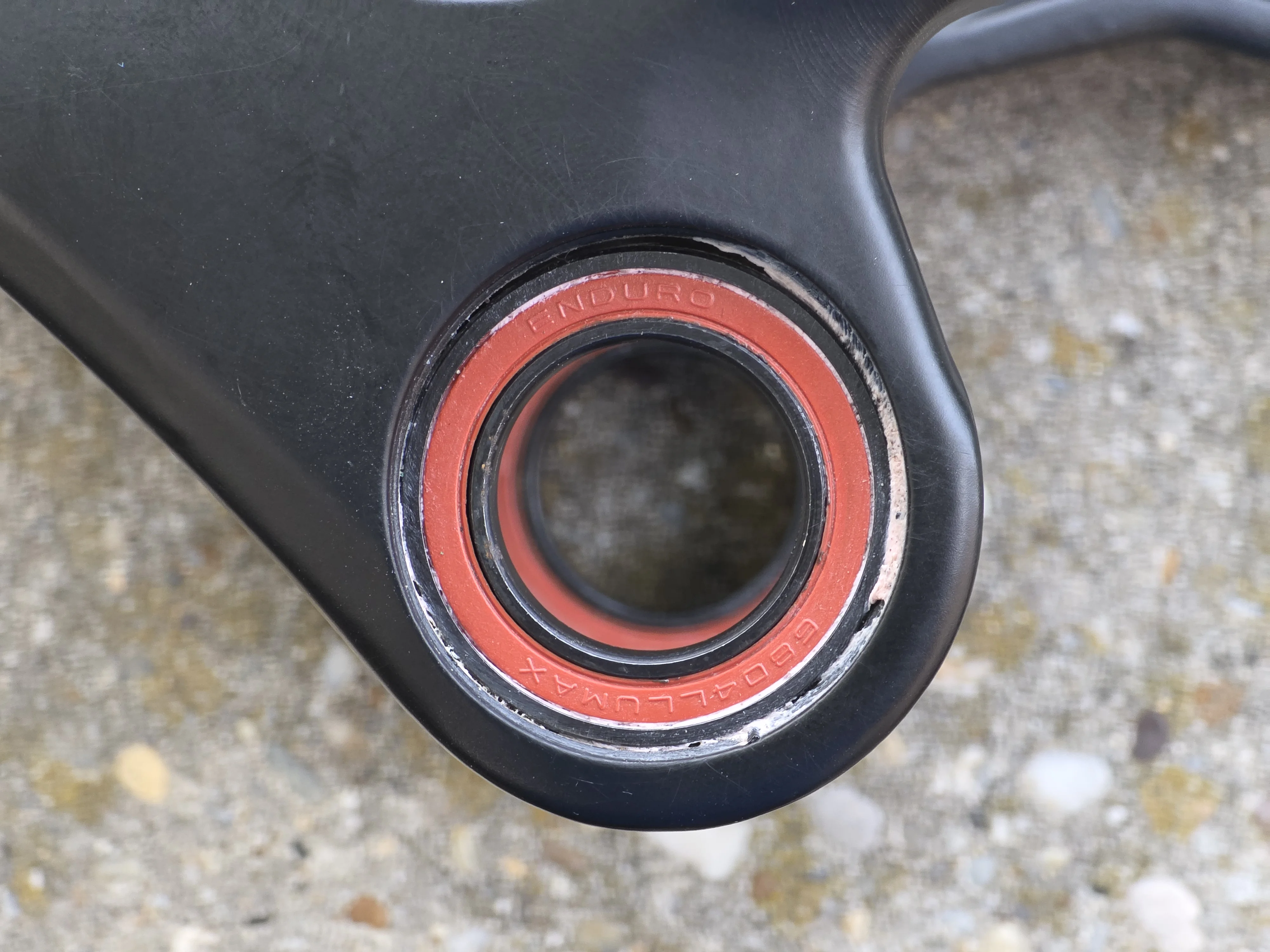

The rocker link arm progressively bent slightly (the rear section bent upward), and I've noticed the bearing holes/seats on the rocker link arm have oval holes, probably not what you want for round bearings...

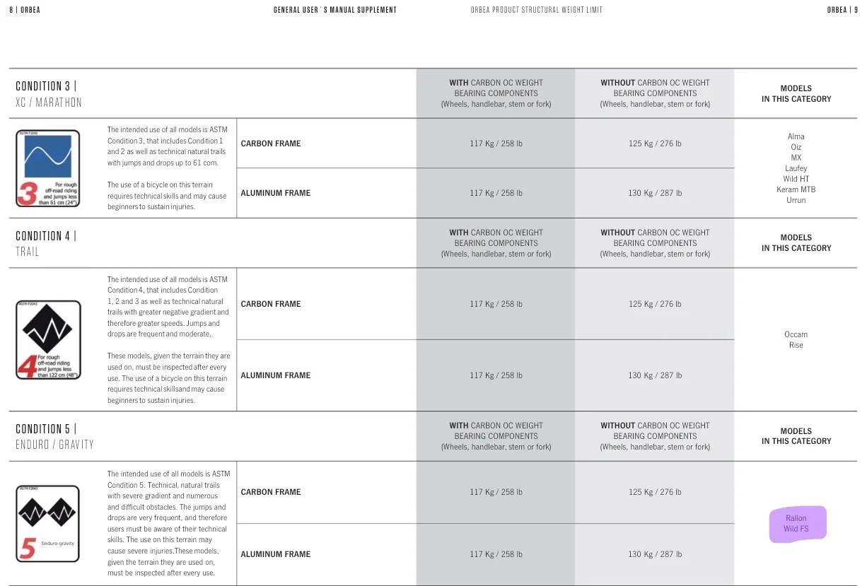

Notice that the bike is officially ASTM category 5 rated, which is a downhill bike standard, meaning Orbea allows you to hit jumps etc. and it shouldn't bend/break.
Talked to my dealer about these issues, they sent some photos to Orbea, but Orbea refused the warranty claim, stating that rear triangles are not covered by the lifetime warranty and neither is crash damage.

I also have no idea why they think this is a crash damage, there are just minor scratches on the frame, nothing you wouldn't expect on an enduro bike that's actually being used as one.
Sure, there were some minor tipovers, but the bike has never see a major direct impact, plus it still wouldn't explain any of the issues the frame has.

Besides, it's ASTM category 5 bike, it should take a few overshot jumps without bending or cracking...
I'm guessing Orbea designed it as a light duty all mountain bike, while marketing it as a downhill sled, which it clearly was not engineered for.

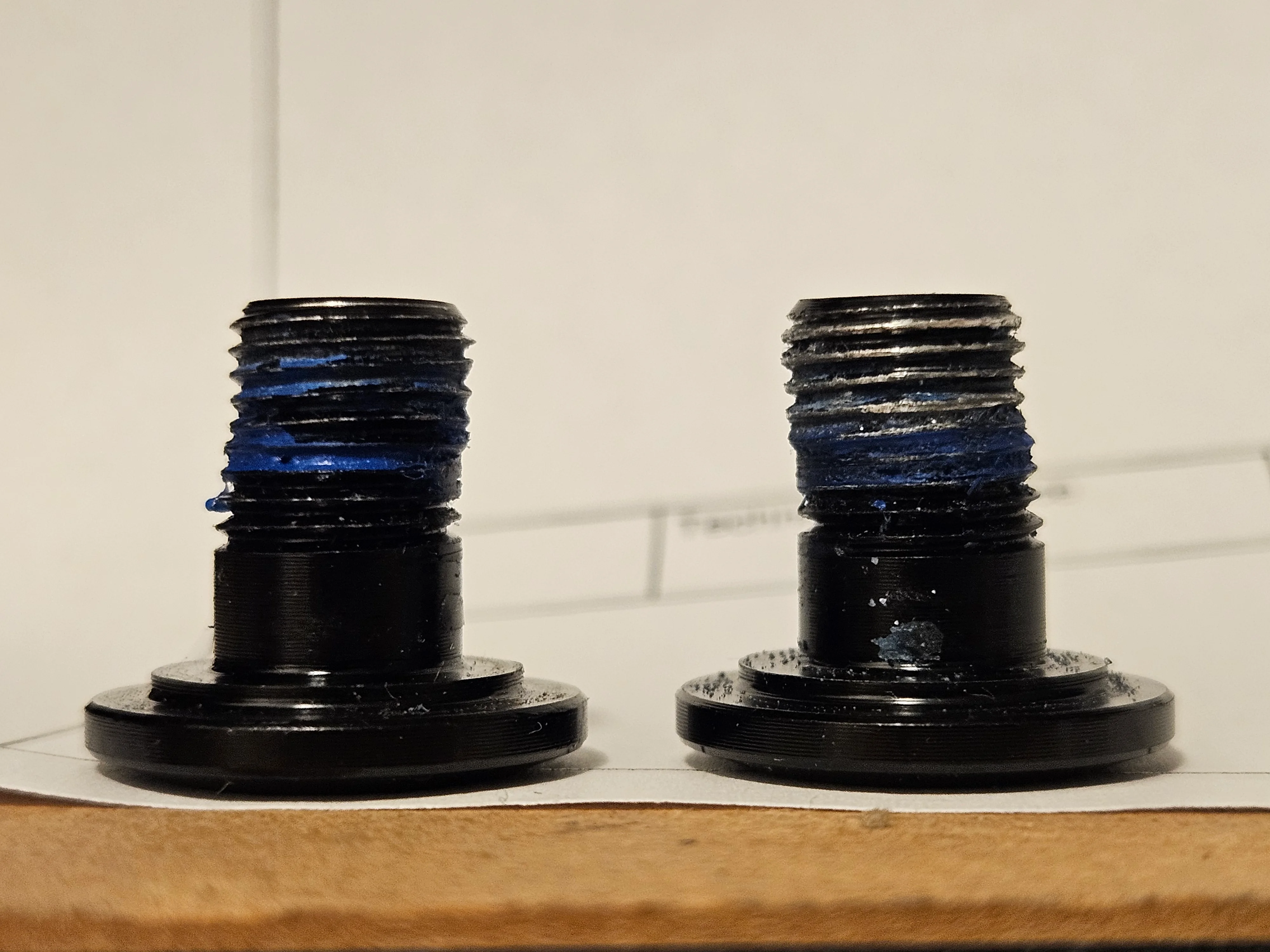

BTW, the Ti bolts are also hollow, they're roughly twice as strong in shear compared to the OEM ones.
I did some math and the OEM ones were barely strong enough to handle forces occuring at mild bottom outs, with basically no safety margins.

I'll try to explain mathematically why those alu trunnion bolts were insufficient in the first place.
I'll have to simplify here a lot to make this understandable for non-engineers, especially the landing forces, but the numbers should be roughly correct.
The trunnion bolts are size M10 with 1mm thread pitch. The Orbea ones have a 5mm through-hole.
M10x1 thread has a minor diameter of 9mm. This gives us a cross section of 63mm2.
But remember, there is that 5mm through-hole, so we have to subtract 20mm2, giving us a total cross section of 43mm2.
Let's assume 6061-T6 aluminium is used for the bolts as it is the most common alu type.
It has 160 MPa shear strength. This number tells you how much force can certain cross sectional area of the given material handle.
Knowing the bolt's cross section area and the material shear strength, we can calculate what the bolts can withstand.
160 MPa * 43 mm2 = 6880N.
There are two bolts, so assuming they're loaded symmetrically, we can estimate that they can handle 14kN at best.
Orbea says the frame is designed for total system weight of up to 150kg.
At 1G on Earth, that is roughly 1.5kN of force.
Since we have two wheels, with the usual weight distribution being 60-40%, we can use 0.6*1.5=0.9kN on the back wheel.
Suspension travel is 160mm, which you get from 65mm shock, meaning there is approx. 2.46 leverage ratio.
That number is how much the force on the rear wheel is multiplied before it reaches the shock.
0.9kN * 2.46 = 2.214 kN - this is the force acting on the shock when the rider is just sitting on the bike.
Your normal landing G-force will be somewhere between 3-5Gs.
7-10Gs is not uncommon for a bottom out, pretty much all mountain bikes are designed to withstand that occasionaly.
Higher than that, you better have an enduro/downhill bike.
Especially DH bikes will see 15+Gs briefly from time to time if you overshoot the crap out of or case a big jump.
Now let's calculate how much margin there is on those bolts.
At a rather soft 3G landing, we're working with a force of 3 * 2.214kN = 6.6kN on the shock.
Seems good, we have factor of safety of over 2x, but remember, this is for your PERFECT, SOFT landing.
Now let's say we have firmer landing, not ankle breaking hard, just firm, I'll use 7G.
At a 7G landing, the force climbs to 7 * 2.214kN = 15.5kN, now we're shearing bolts.
Alright, so we know the bike is definitelly too weak to handle big dudes if they're going to jump.
That's despite Orbea saying it's ASTM cat. 5 with a max permissible total weight of 150kg (i.e. rider up to ~125kg/~275lb)
There is no point with further math at that weight, since we're already past the actual structural limit.
I'll continue with a more realistic scenario, where the rider weights 80kg and is carrying 5kg of gear, for a total of 85kg or ~190lb.
At that weight, the force at 7Gs is ~11kN. The bolts should hold that, but there isn't much margin of safety.
At 10Gs, which would be your "oh shit I'm past the landing and still in the air!" kind of event, we're at almost 16kN and breaking them bolts once again, even with an average weight rider.
At 15Gs, which is probably on the upper end of what most riders will ever experience, those bolts ain't holding a small girl.
So yea... the bike is objectively underbuilt for its purpose (ASTM classification) and rider weight rating.
Your 6061 aluminum example is unsuitable for bolts, it's a fairly soft alloy, after all you need to redo the calculation using 7050 or 7075, or perhaps even 5083. ;)
Doesn't that assume however, that the shock doesn't move at all?
In reality that peak G force is spread out over the time it takes to compress the shock, greatly reducing instantaneous forces on all components.
The forces I mentioned are residual forces after accounting for suspension travel of properly sprung shock absorber etc.
If I didn't account for that, the resulting forces would be infinite.
I did oversimplify my post by using Gs instead of the actual complex math that's behind it, as Gs are rather intuitive for most people.
Furthermore, when the bolts are clamped, I'm not certain all of those forces are transmitted to the bolts. At a minimum you have sky high friction where the bolt is clamped preventing it from 'shearing'. I'd almost think that the OEM trunnion bolts would have to be loose for that to have occurred at a minimum.
You're right regarding the friction between the shock and the spacer, but the clamped area is so small it's basically a statistical error.
It has no effect on the strength of the bolt in shear - there is plenty of unsupported length of the thread, which allows for relatively high shear amount, as that is linearly proportional to the length.
Are your spacers all OEM on the inside of that shock mount.
Yes.
PS. I huck my Wild daily, landing on flat from a solid 2 meters up (the largest jump on the behind my house trail).
Strange.
When I hucked mine to almost-flat from ~1.5m height, that was the first time I sheared them bolts.
Truthfully it's the g-outs that really put the most load in to the bike.
Incorrect.
The force is just acting longer, so you feel it more, but landing jumps generates much higher forces for brief amount of time.
You'd be surprised what alloys bike mfgs use where it really doesn't belong. But even if those were in fact made out of 7075, that extra 50% strength in shear still wouldn't do it.
