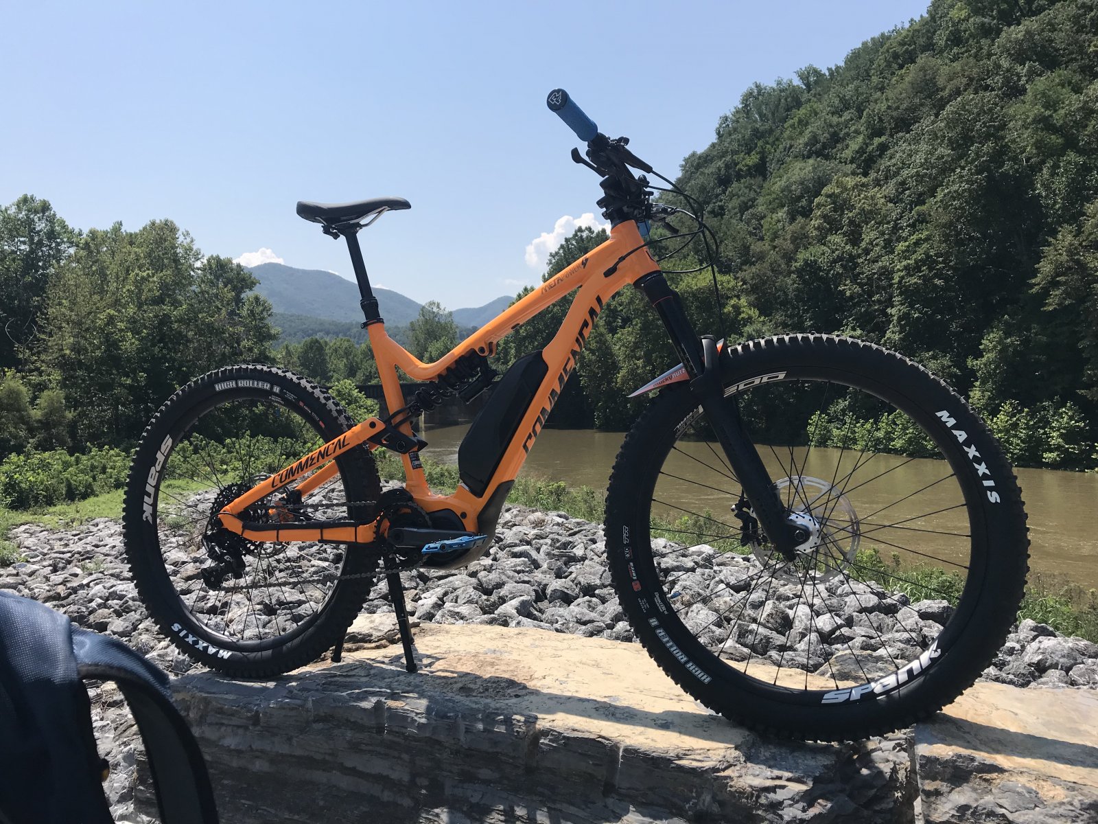

here she is in all her glory. the maiden trail voyage went fine I’ll have to make a doctors appointment to have the smile removed from my face as it transformed a pretty bland trail into really good time. Ready to move to the big stuff, just wondering how far down the road a spare battery awaits. 1956CDEB-46B6-4353-BB29-4485CF1FBCAA.jpeg
here she is in all her glory. the maiden trail voyage went fine I’ll have to make a doctors appointment to have the smile removed from my face as it transformed a pretty bland trail into really good time. Ready to move to the big stuff, just wondering how far down the road a spare battery awaits.View attachment 3759
Iam Afraid after 6 months the smile is still untreatable , it can’t be removed unless you remove the bike , this bike so often amazes me with it ability
