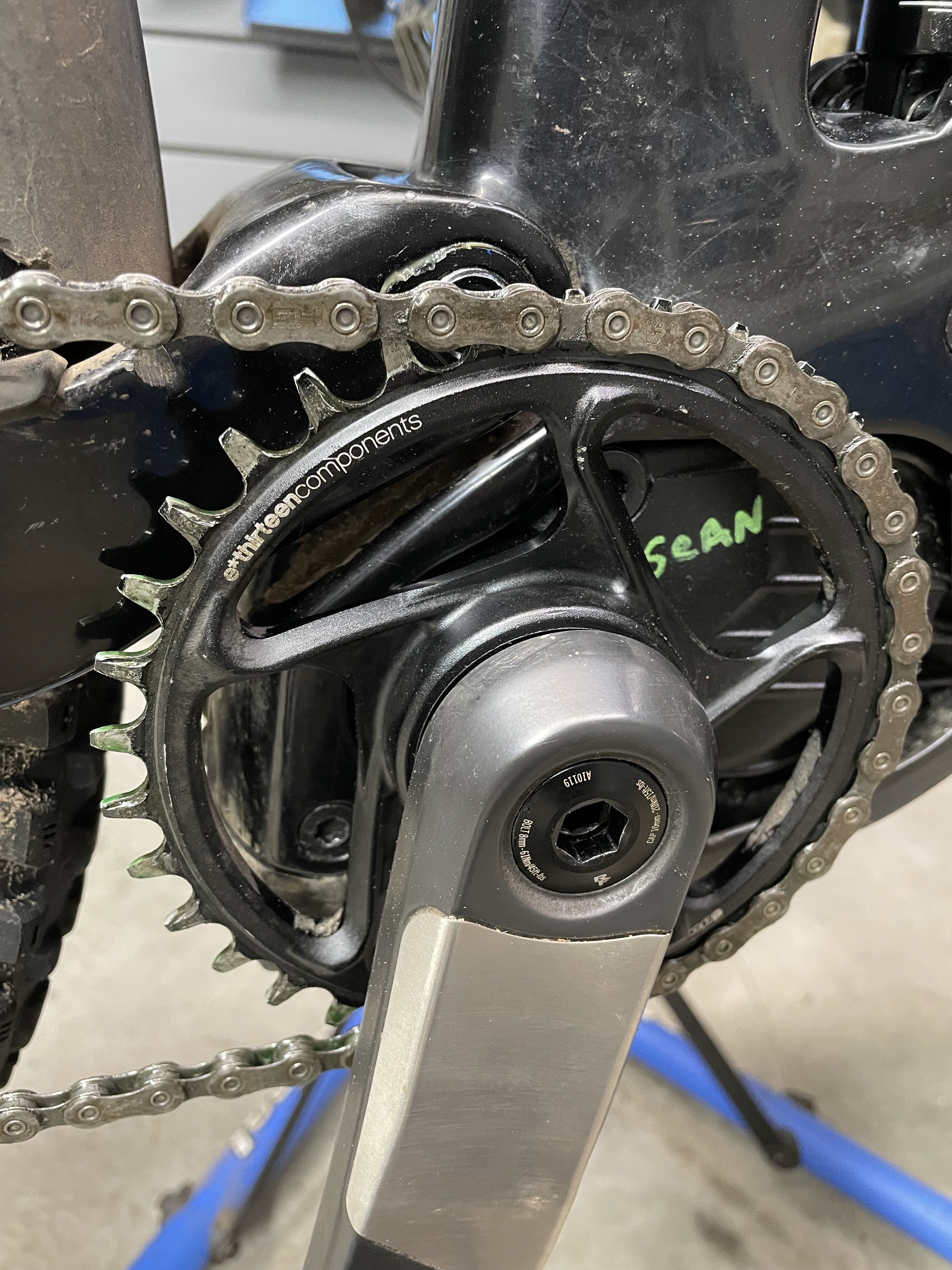

…motor Sean, sorry Stihldog,
bahahaha.…I’m guilty of tinkering with other bikes so I use permanent markers to keep track of things …I must be easily confused and forgetful.😉 (Sean is my neighbor, I’m just a Hand-held-power-TOOL!!!!)😡
I always weigh my options; Do I buy the tool or send it away? I guess it depends on my ability, time, interest, need etc. Rebuilding a motor is possible for me but there’s a can-of-worms…so I’ll send it away. I’ll stay in this lane for now. The bearing seal kit is as far as I want to go right now.
I can’t bake a cake …but I can lace a wheel. 🤷‍♂️
