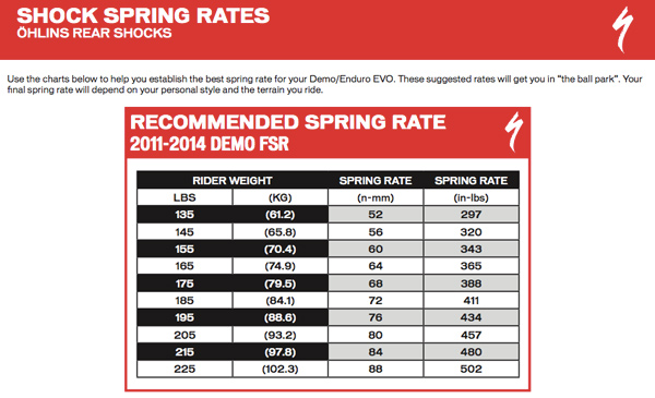

Hi Kiwi in Wales, much appreciated.
Ok, Kenevo is medium with a 457 spring.
I’m 89kg fully loaded.
This chart below is telling me, medium spring is ok for my weight. Hopefully!

The spring rates shown in the table (post #72), don't seem to jive with stock spring rates. A small frame comes with 411 lb/in which is for a 84 kg (185lb) rider?
Dax
May 25, 2018
1,461
1,834
FoD
That table says at the top its for a Demo not a Kenevo. Different geometry and bike weight, so spring rates would be different

Salvie69 has actually sat on his bike fully kitted up and the sag is 28% so this is a good starting point for his Öhlins rear shock set up. I am sure he will be able to decide what he wants to change or not change after a few rides.
It makes the table which you are correct, is definitely for a different bike, more or less irrelevant.

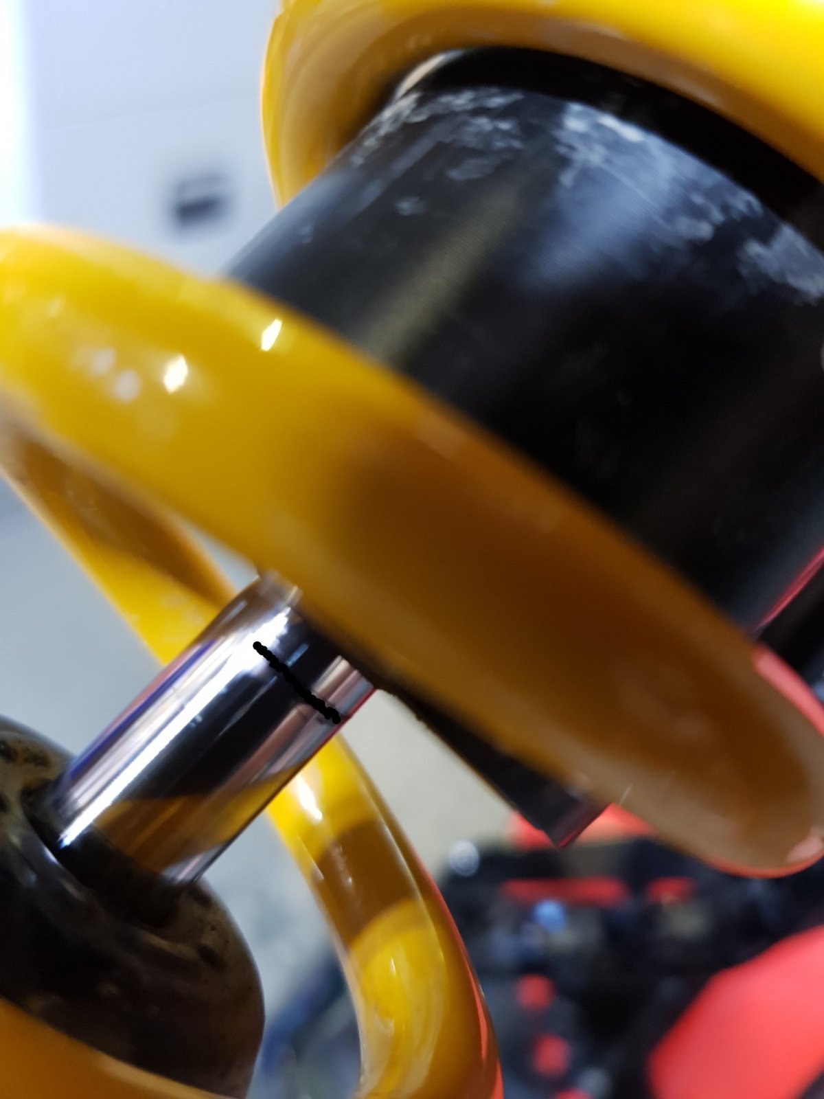

A point to note on a coil shock on an ebike that can skew your sag measurement.
Believe it or not, just the weight of your ebike will cause your coil shock to sag by around 1 to 2 or even 3mm. As the Kenevo is a bit heavier it may be the latter.
You can check this by using a fine tip marker pen to mark around the shock shaft as it enters the shock body. Then all you need to do is grab the front triangle of the bike just above the rear shock near the rear mount and lift.
You will then see the shock extend and see the mark around the shock shaft move away from the shock body. You should be able to see this extra sag quite clearly as per the attached photo.
