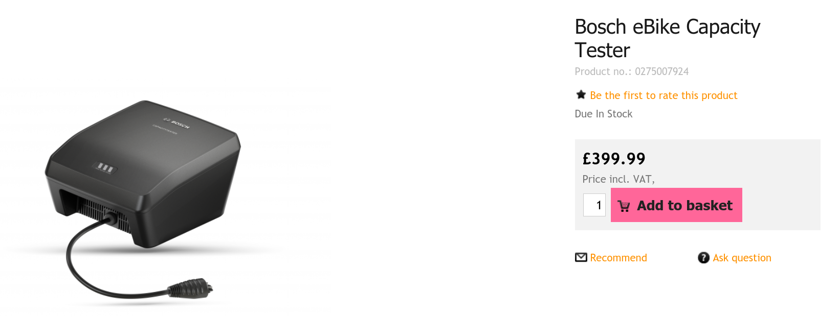

You can test the health on the Bosch batteries, but you (or a bike shop) needs a BCT-100 (0275007924)
Manual : https://www.bosch-ebike.com/fileadm...ual-CapacityTest-BCT100-MY21.pdf?_=1598970392
