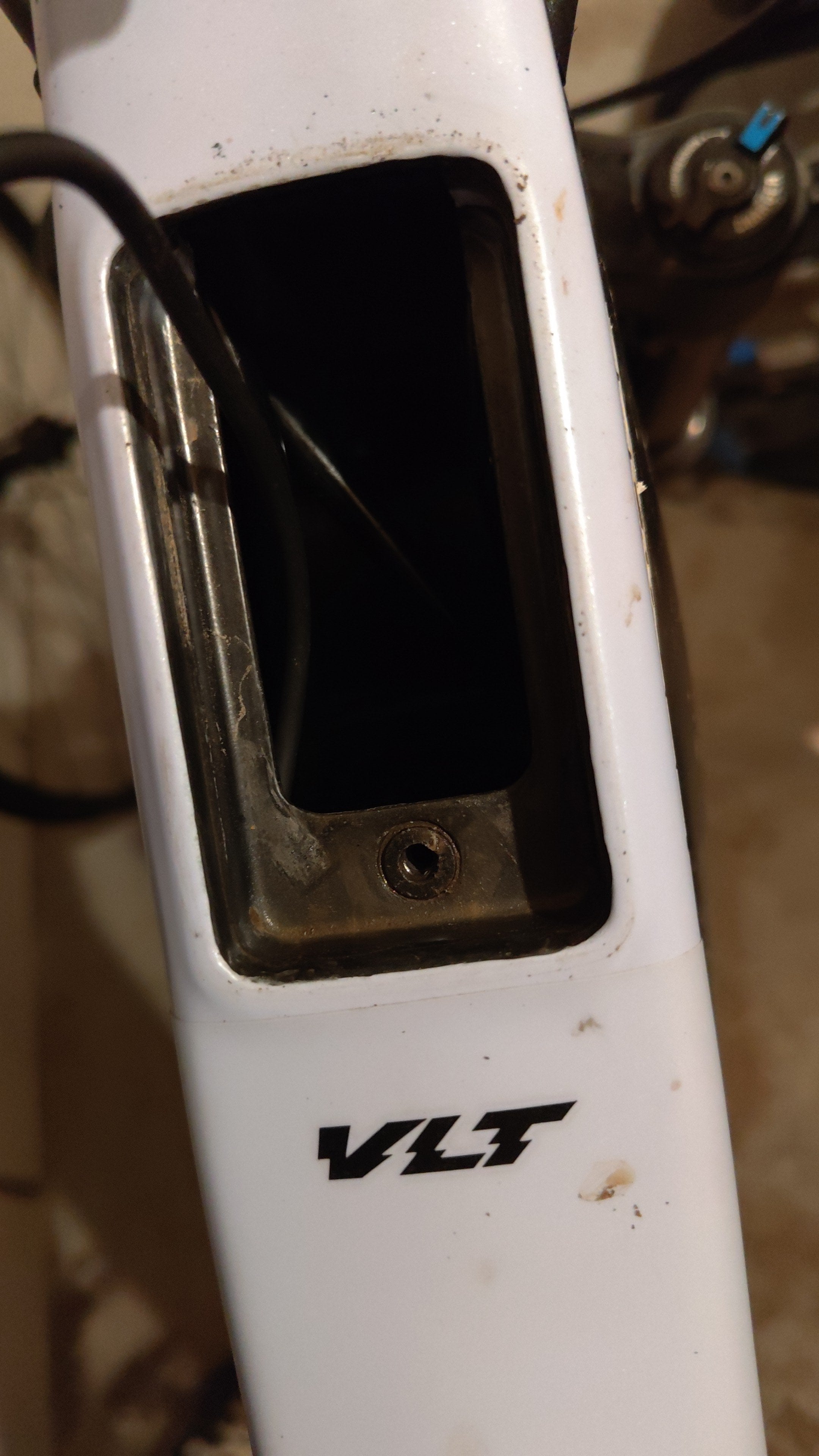

Friend of mine contacted Norco about if the kriox 400c will fit.
He got this response:
It fits for sure on size 4 and 5.
On size 2 and 3, the edges in the hole were missing on the 2025 model (I don't know if it will be revised for 2026 models, I hope so) so you can mount a Kiox 400C but you have to create a kind of plastic shim to properly maintain it in the frame. It's technically possible but it's not perfect on these frames.
So I got a size 2. Has anyone here build it in a size 2 or 3?
How did that worked out?

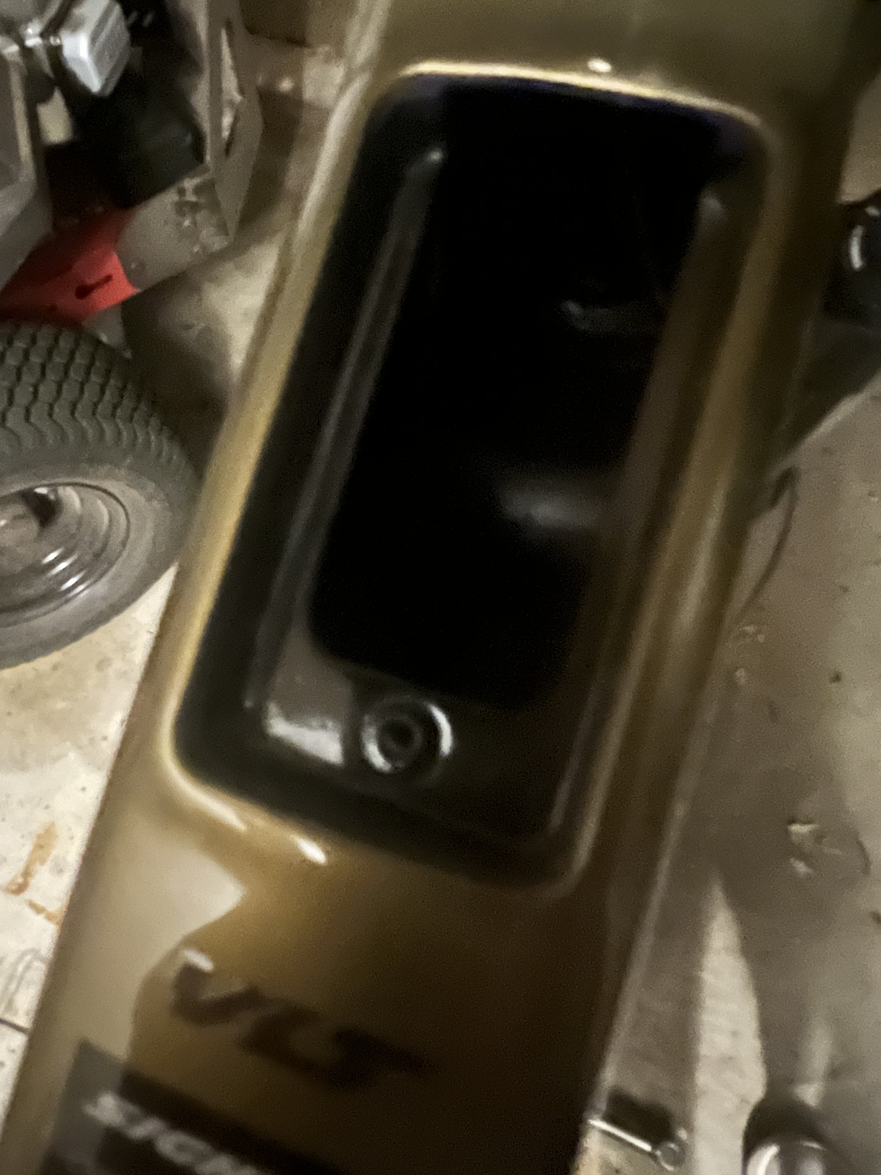

I’m not sure it’s size specific, it’s model specific. You can see in the attached the C2 pic which is a S3 size, whereas the C3 is an S4 🤦‍♂️
It fits both, you just need to be creative with some 3M 2228 tape On the ones without the cradle.
What I find mad is they have 2 different moulds, for the same front triangle. 🤯

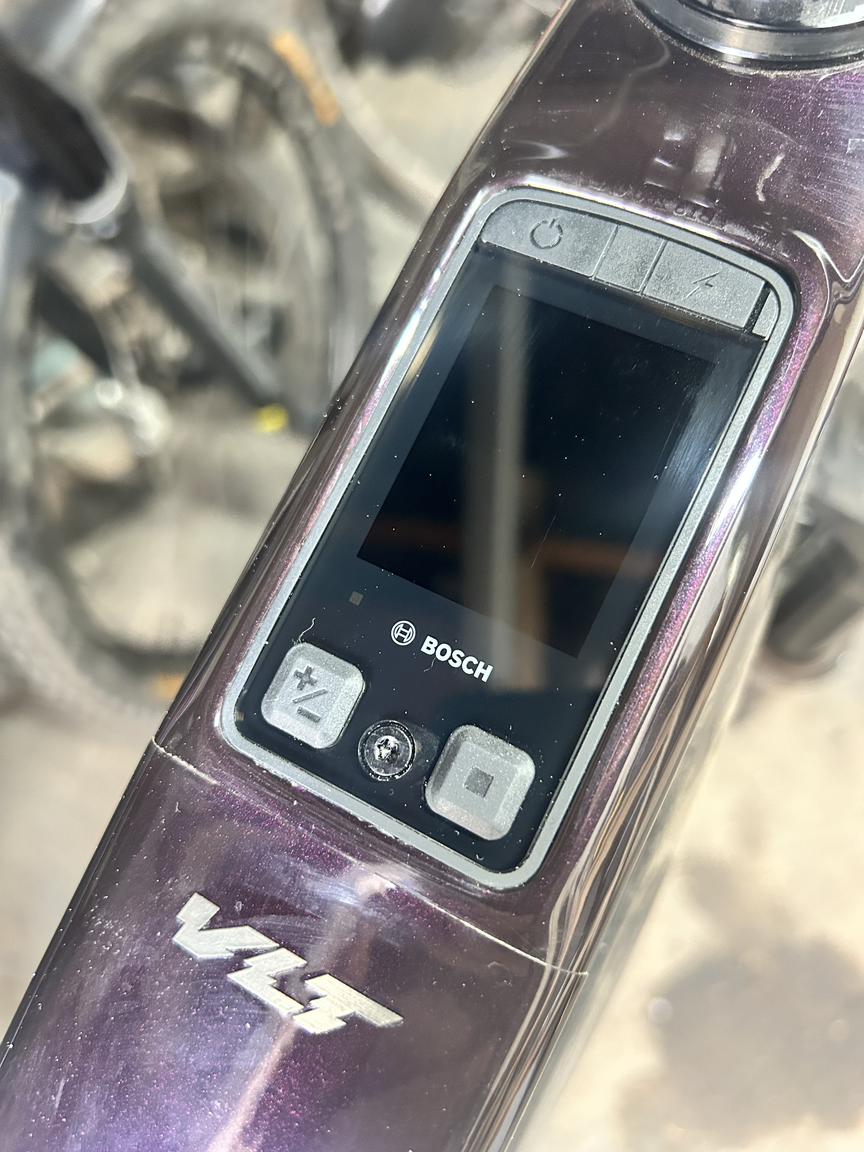

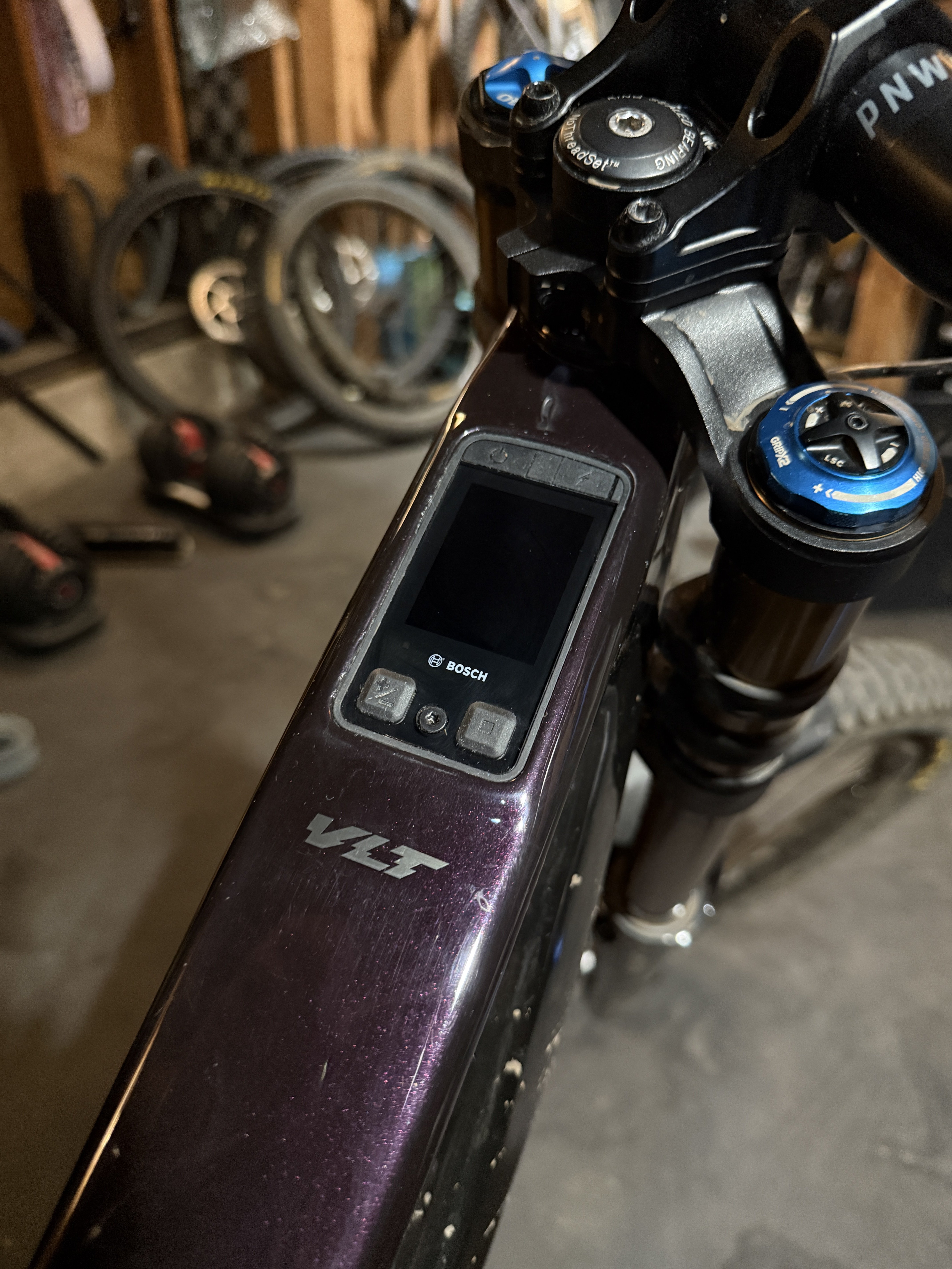

C1 build in S2. I must of got lucky because it has the ridge. I am in the US and ordered the display from Italy, would of been bummed if it didn’t fit
O wow! Nice. I wil pick up the bike in 2 days. Hopefully there is a ridge

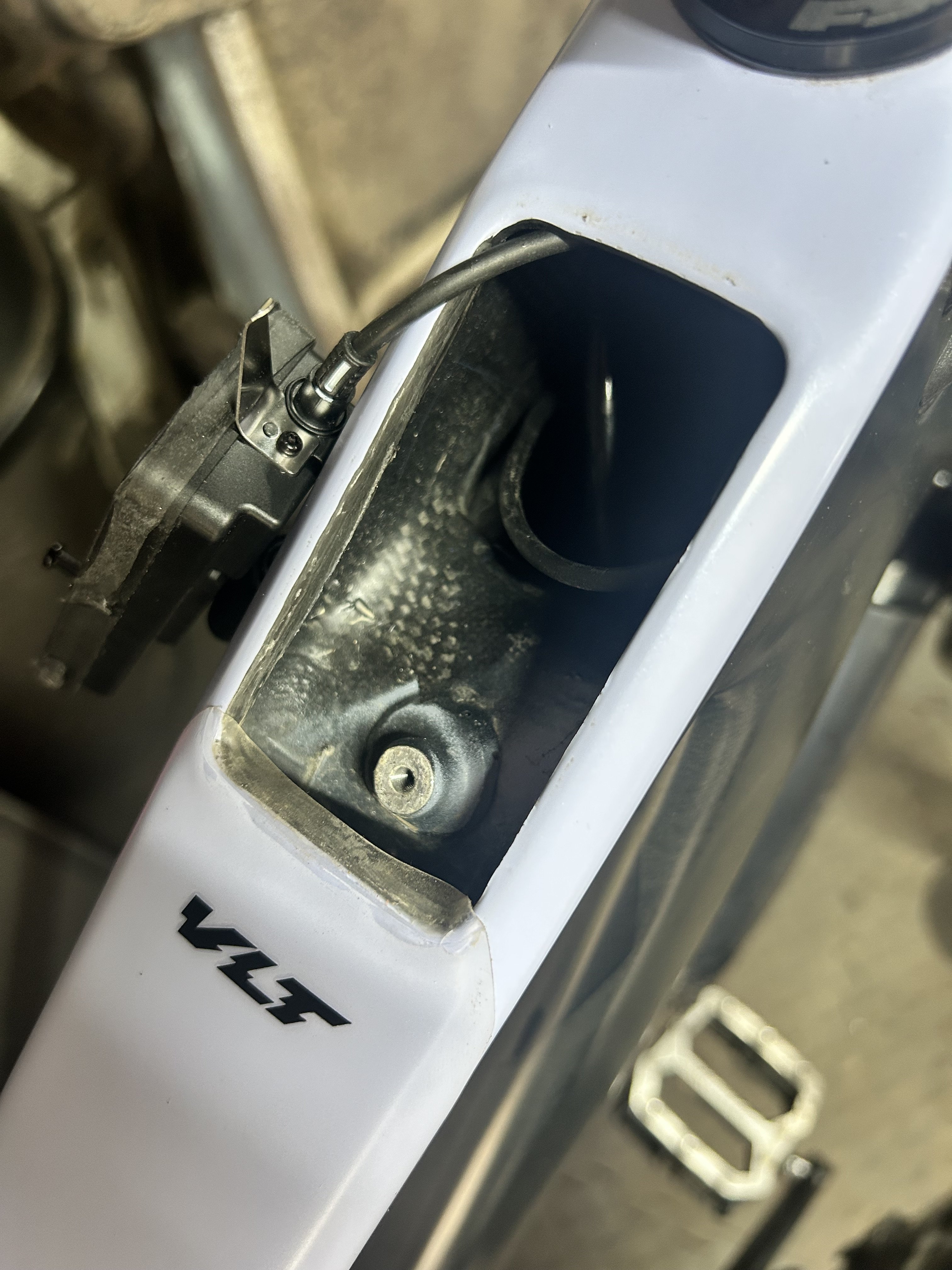

I got the cf2 size 4 here and no edges in the cut out. Whilst norco said the s4 would definitely have them. Quite a simple fix though. Few layers of electrical tape and the display isn’t going anywhere. Still pretty bad for a premium brand like norco.
But the kiox display is a great upgrade! Looks super nice mounted flush in the top tube.

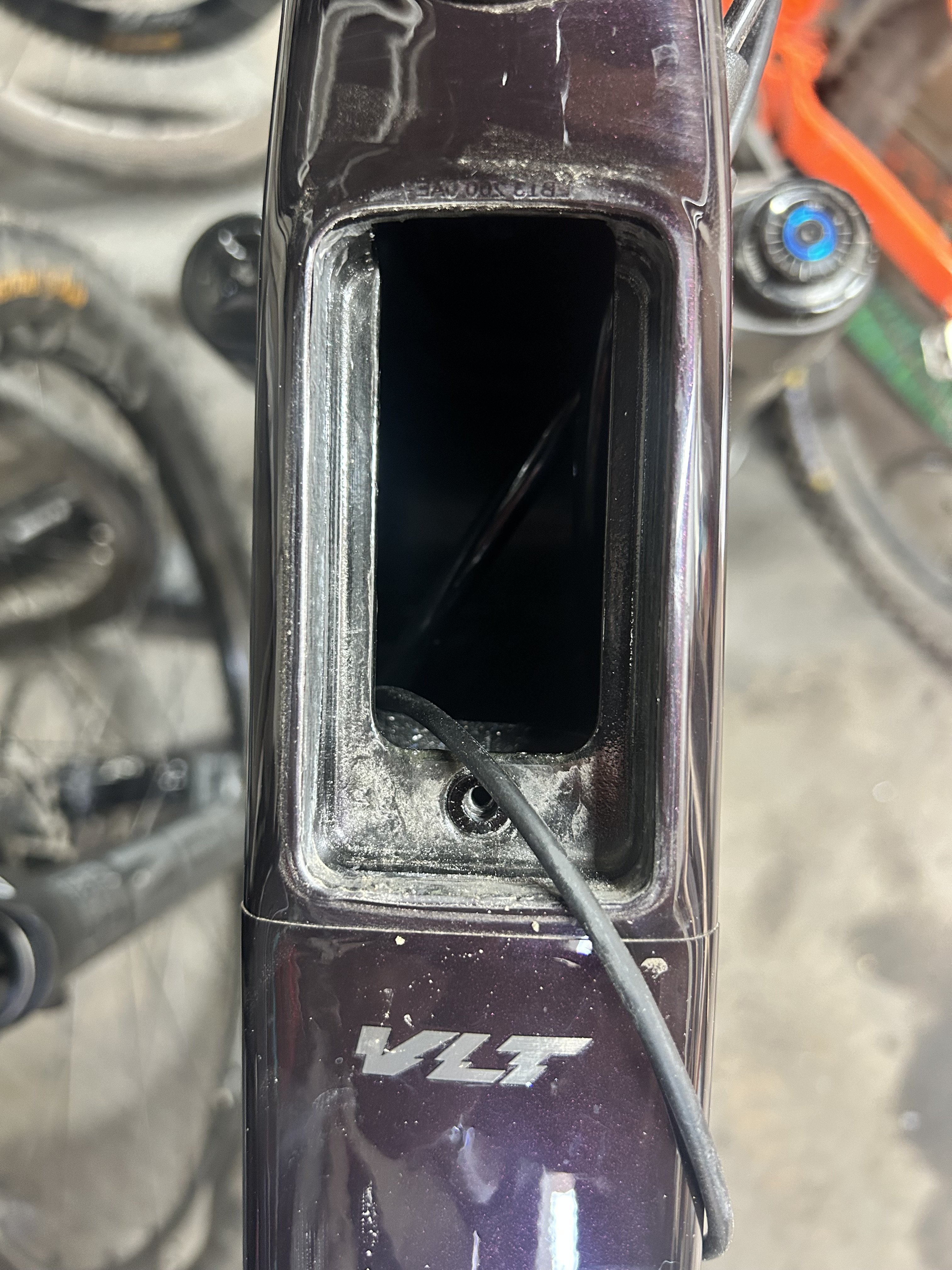

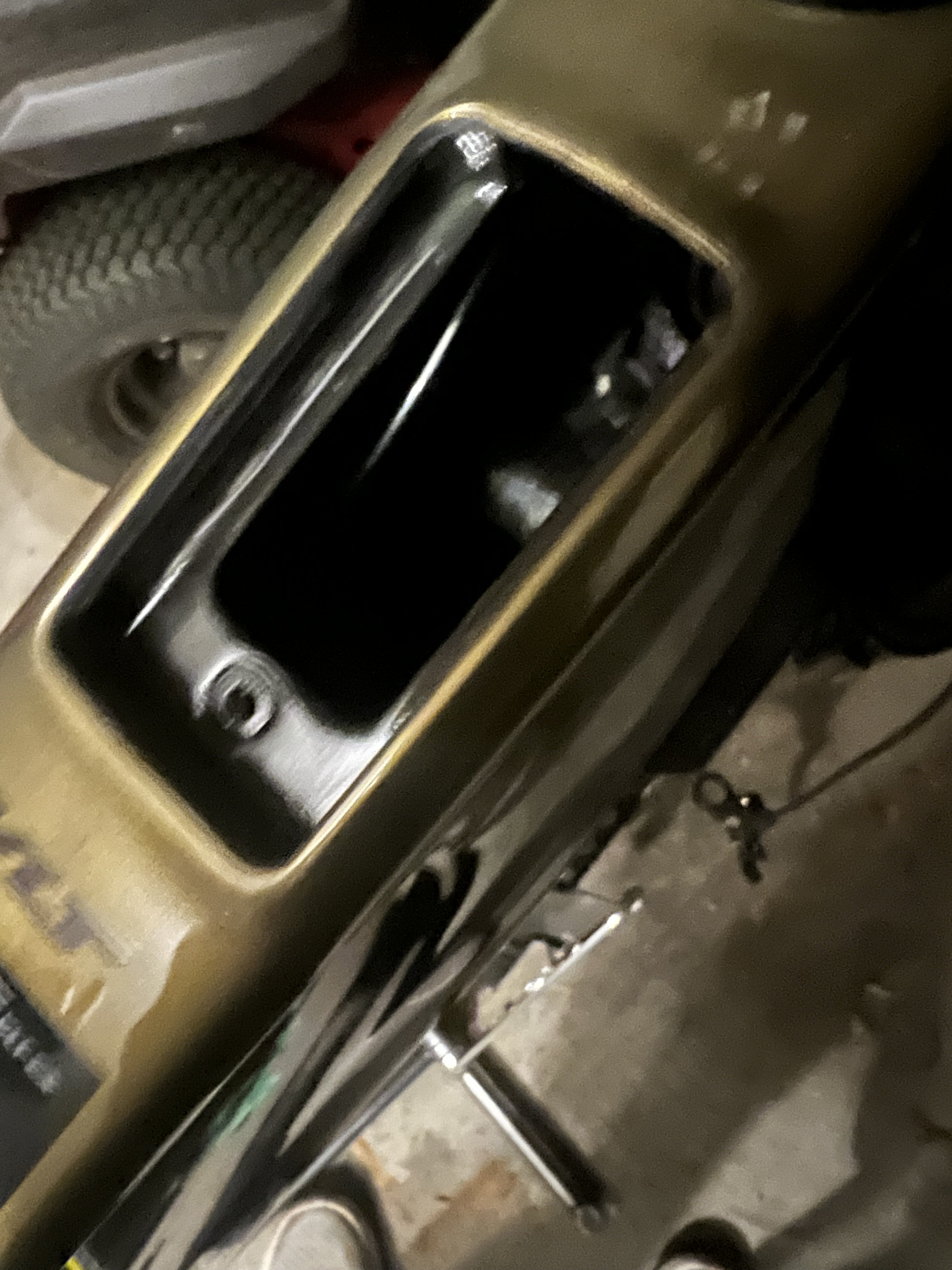

I've got another S4 missing the Kiox mounting edges.
The different models are all coming out of the same mold per size. Looks the S4 mold was off and they just ran with it. Bummer.
Layering electrical tape on the edges of the Kiox to friction fit it seemed to work but quickly started to fail on my ride today. It needs some kind of bridge support under the head tube end to keep it from sinking into the hole.
I think I can rig something up with an old phone case, a dremel, and some 3m double stick tape...
The different models are all coming out of the same mold per size. Clearly the S4 mold was off and they just ran with it. Bummer.

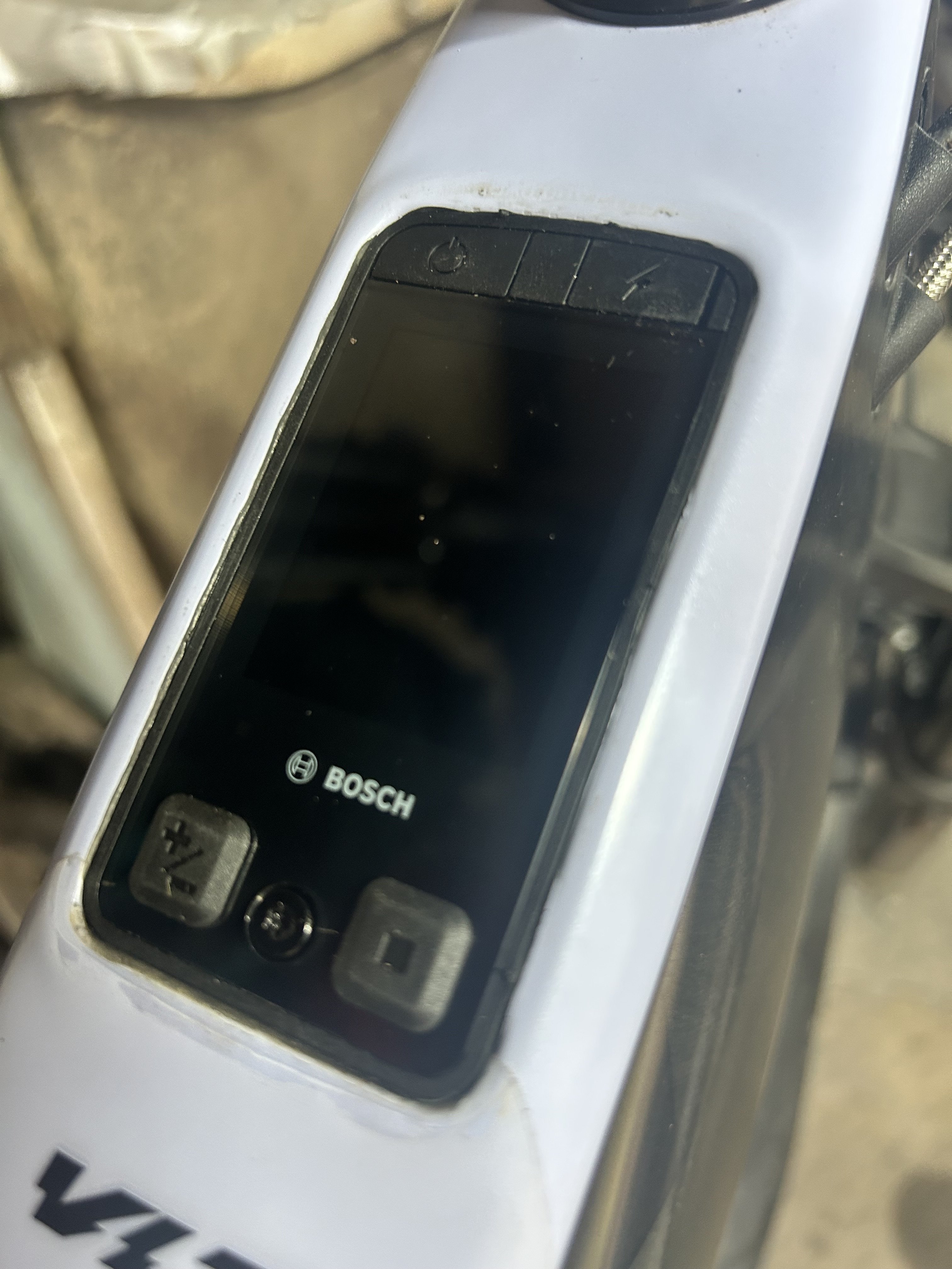

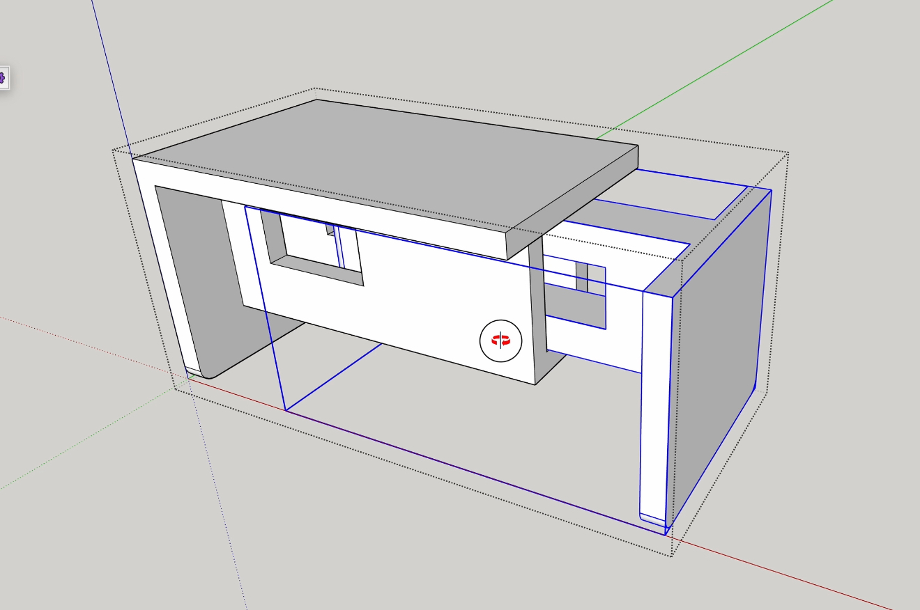

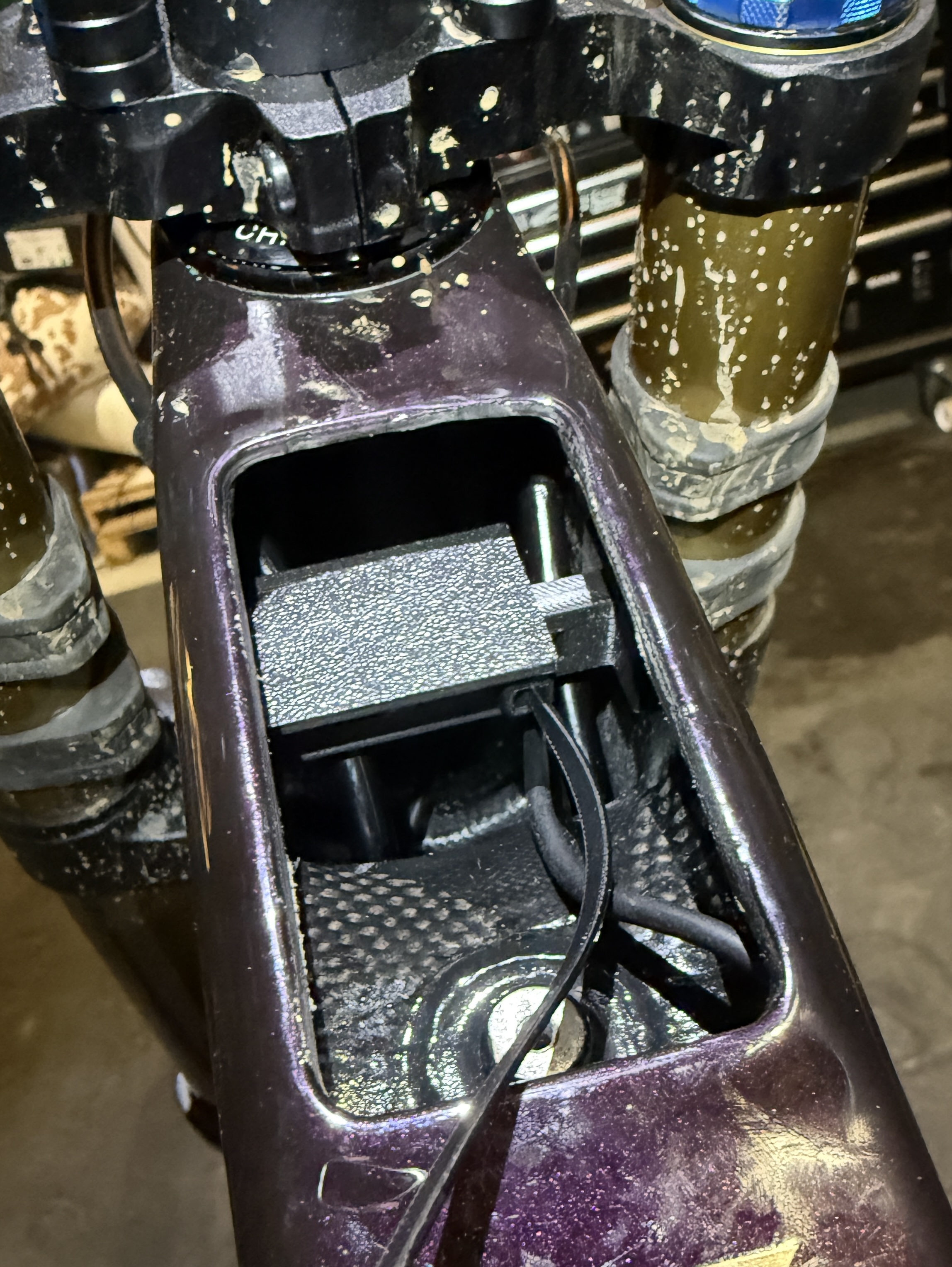

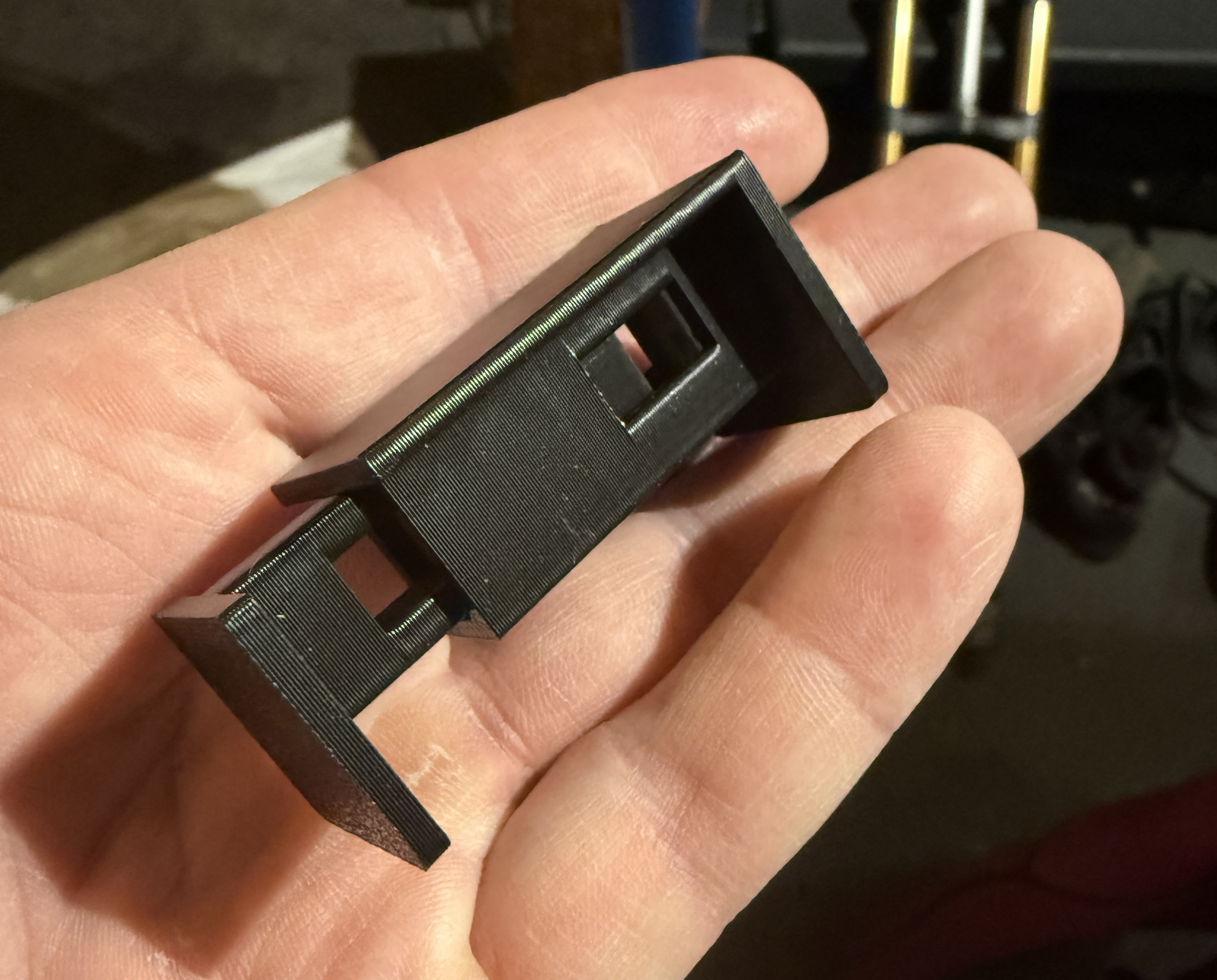

Went straight to the deep end...
Ends get double-sided Gorilla tape. Tightening the zip tie pushes the ends outward tight to the frame walls.
Now I can mash buttons with conviction.
