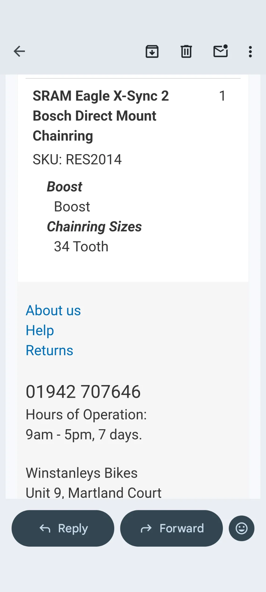

I've just ordered one for my Bosch Gen 4 bike, but totally forgot about the offset 🤔
