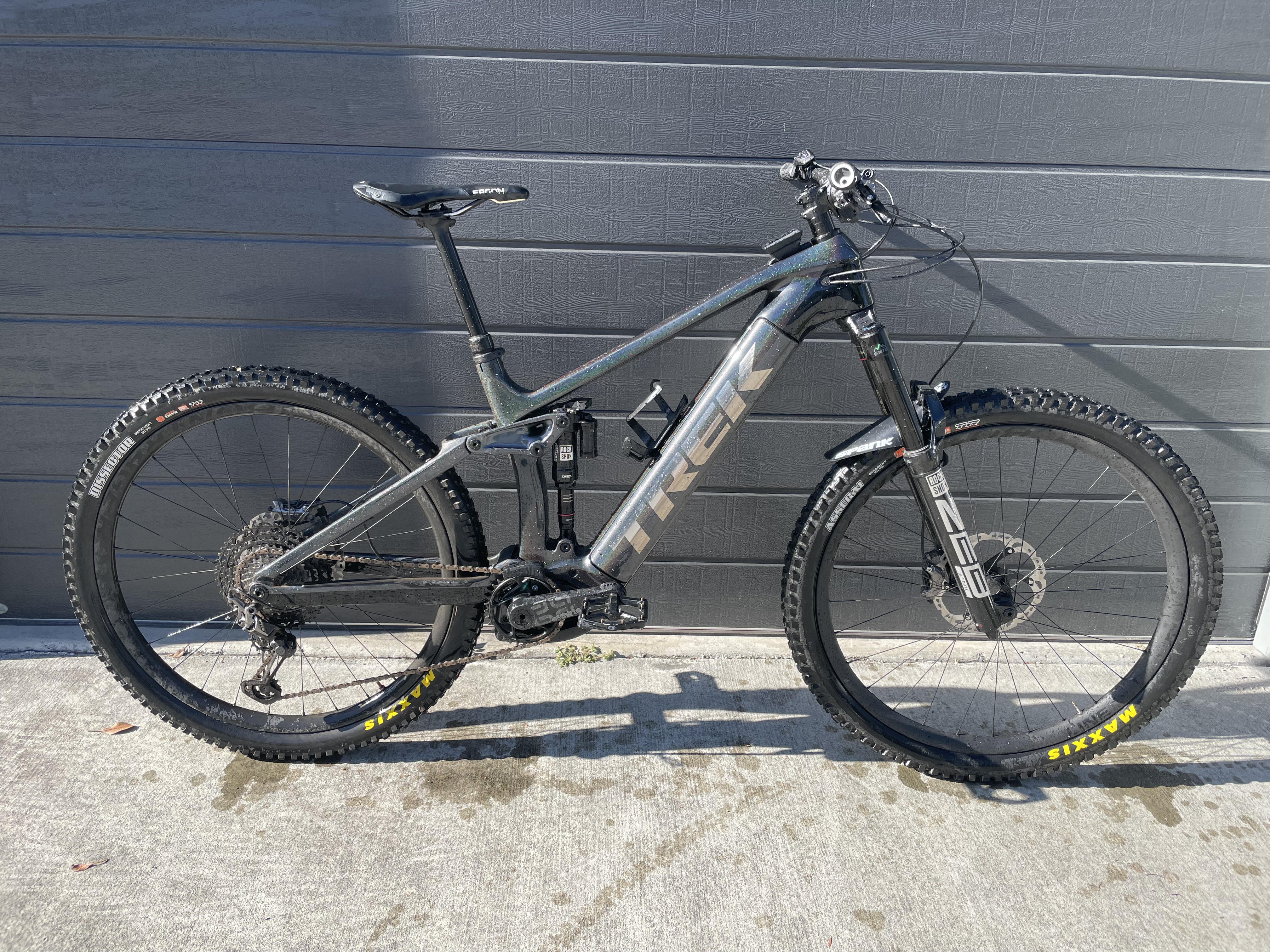

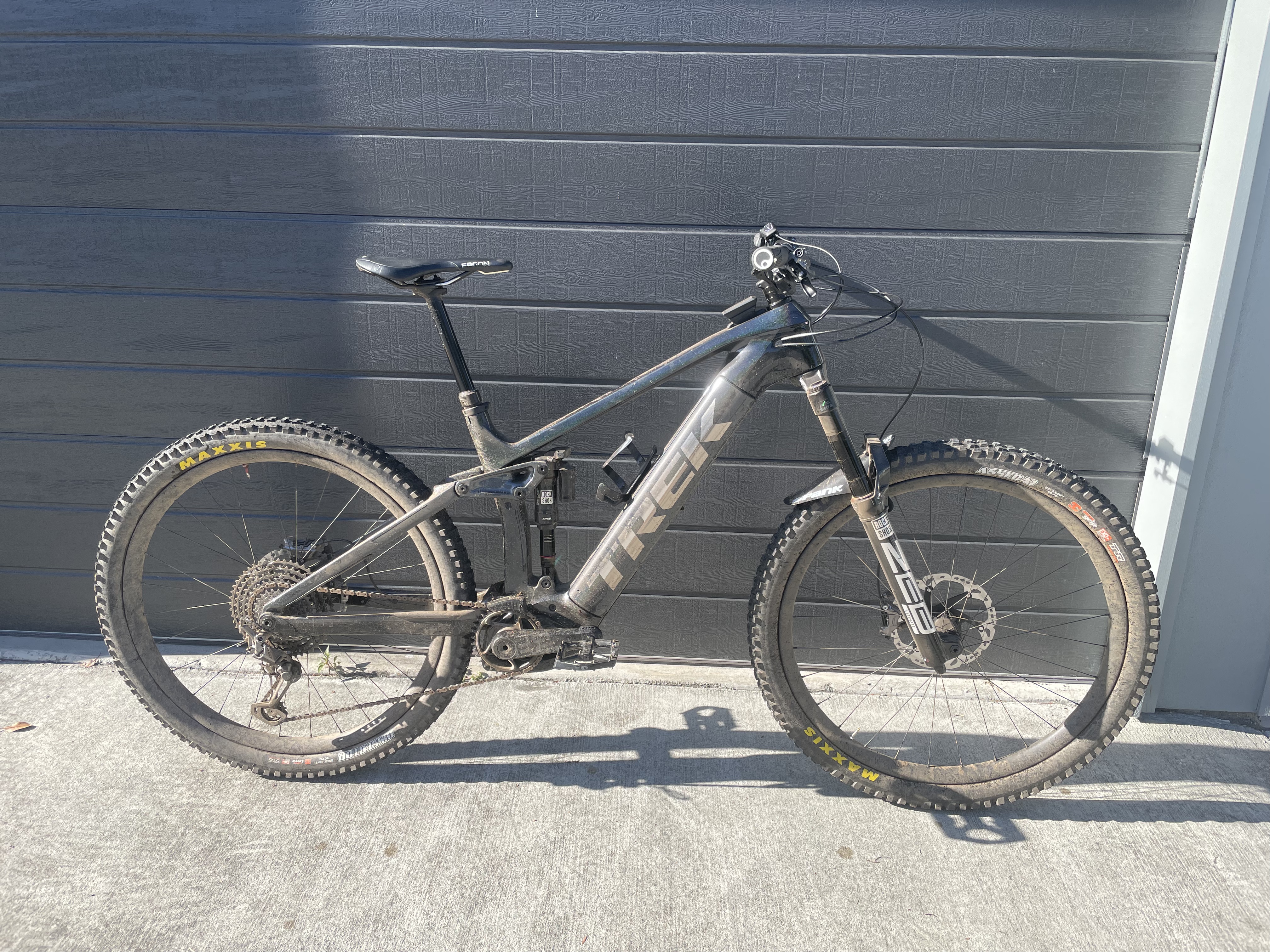

Dusty, post ride:

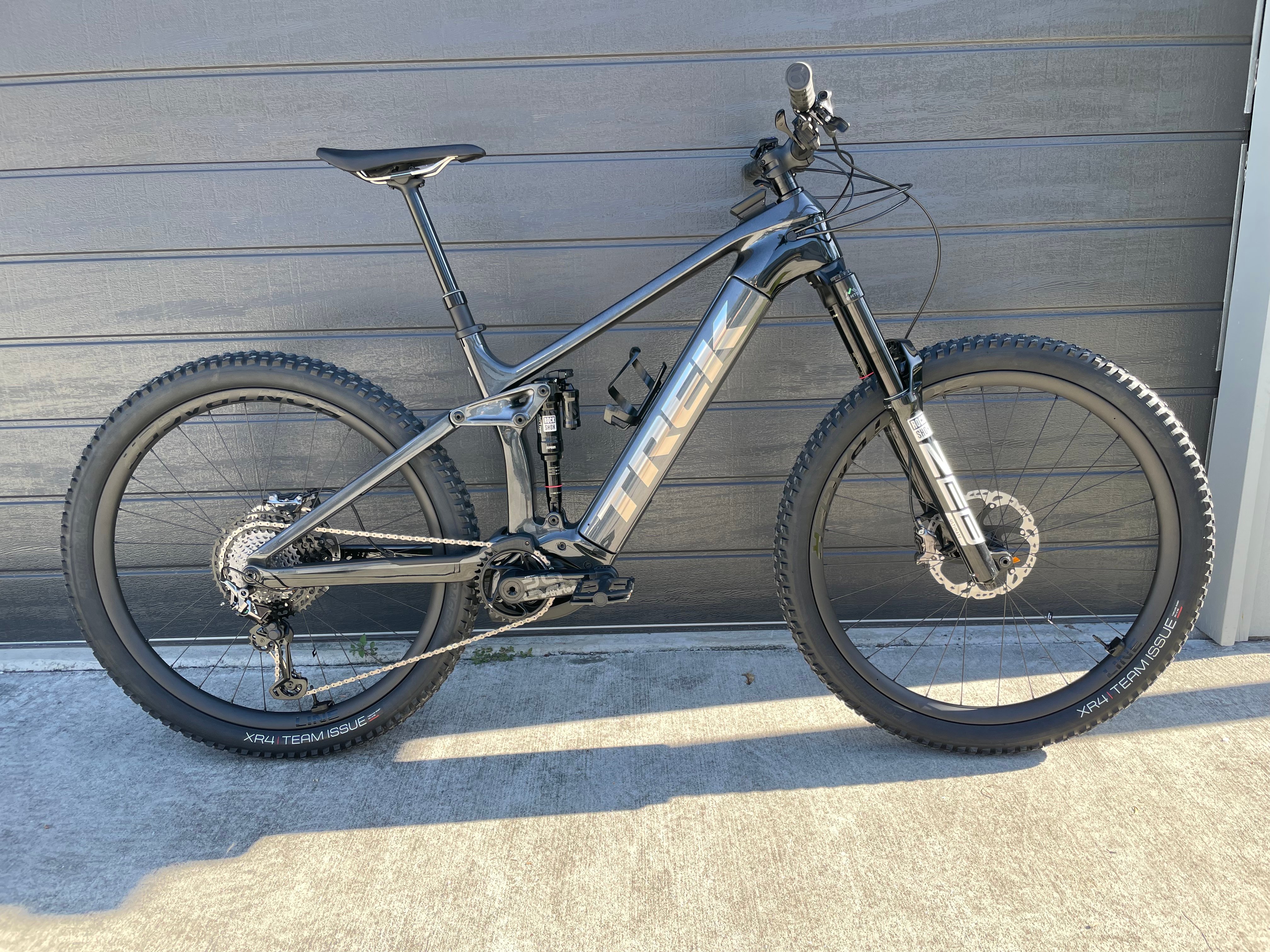

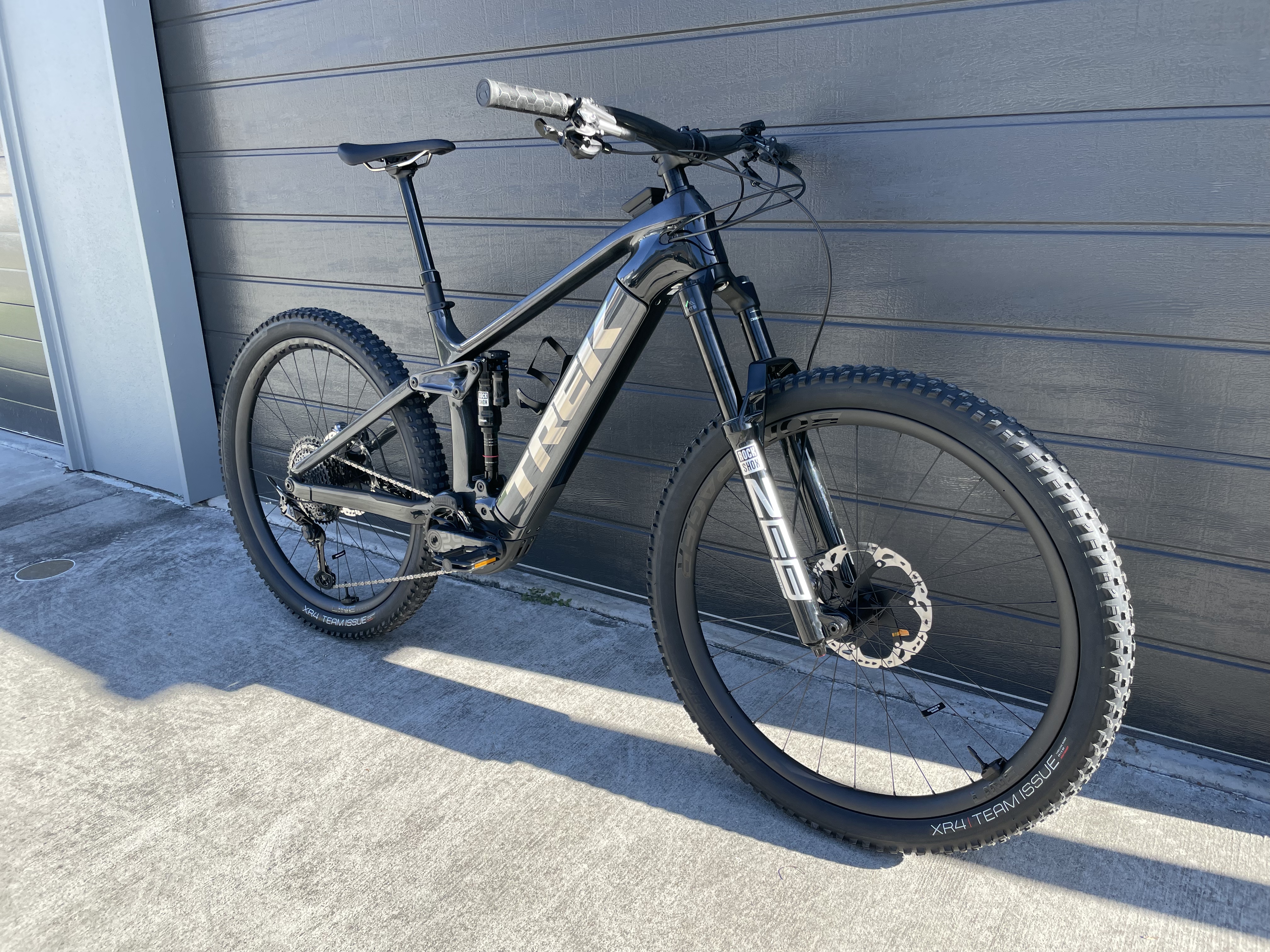

I thought that above photo, hosed down and still wet, would look good... Anyway, here's some clean ones pre my bits...
The paint job really is sweet, like a pearl glitter through it and without sun hitting it just looks dark grey like above.
