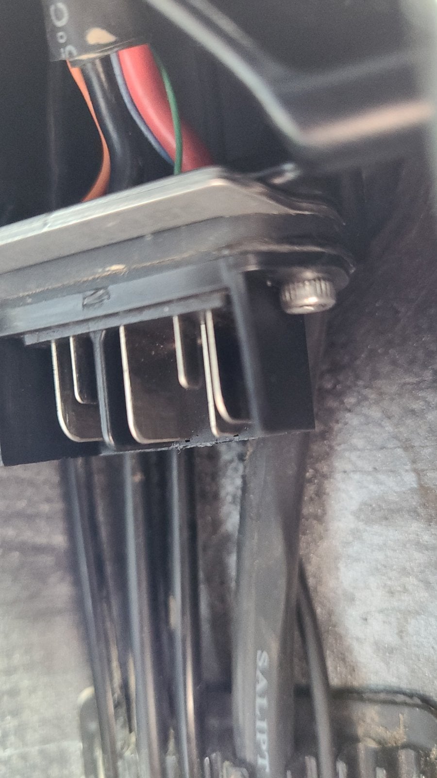

hello I sent my decoy to yt for engine change following repeated e10 errors, they also modified the electrical connection with the battery with this system
Before
After
Who has this system ?

I sent the bike to Germany, for the motor and the electrical system it took more than 2 months

I can't see the difference. Are these two pics before(in your hand)/after(installed)? I tried hard to compare, any captn here?

It looks like YT added a small back plate (silver one?) this will shorten the length between the two battery bolts. Also the contact plates for the battery are now surrounded with a guide (?) plate to prevent lateral movement maybe? I will have a check what mine looks like (2019 decoy). BTW never had any error from battery related stuff. Only thing I have is that if I do not tighten the bottom bolt enough first I get a creaking sound when pedaling :)
that's exactly what it
