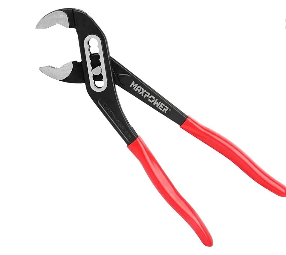

What did you use to tighten up the lock nut on the chainring cant get it to bite enough to tighten up
These style of pliers / wrench
Remember that nut is reverse thread

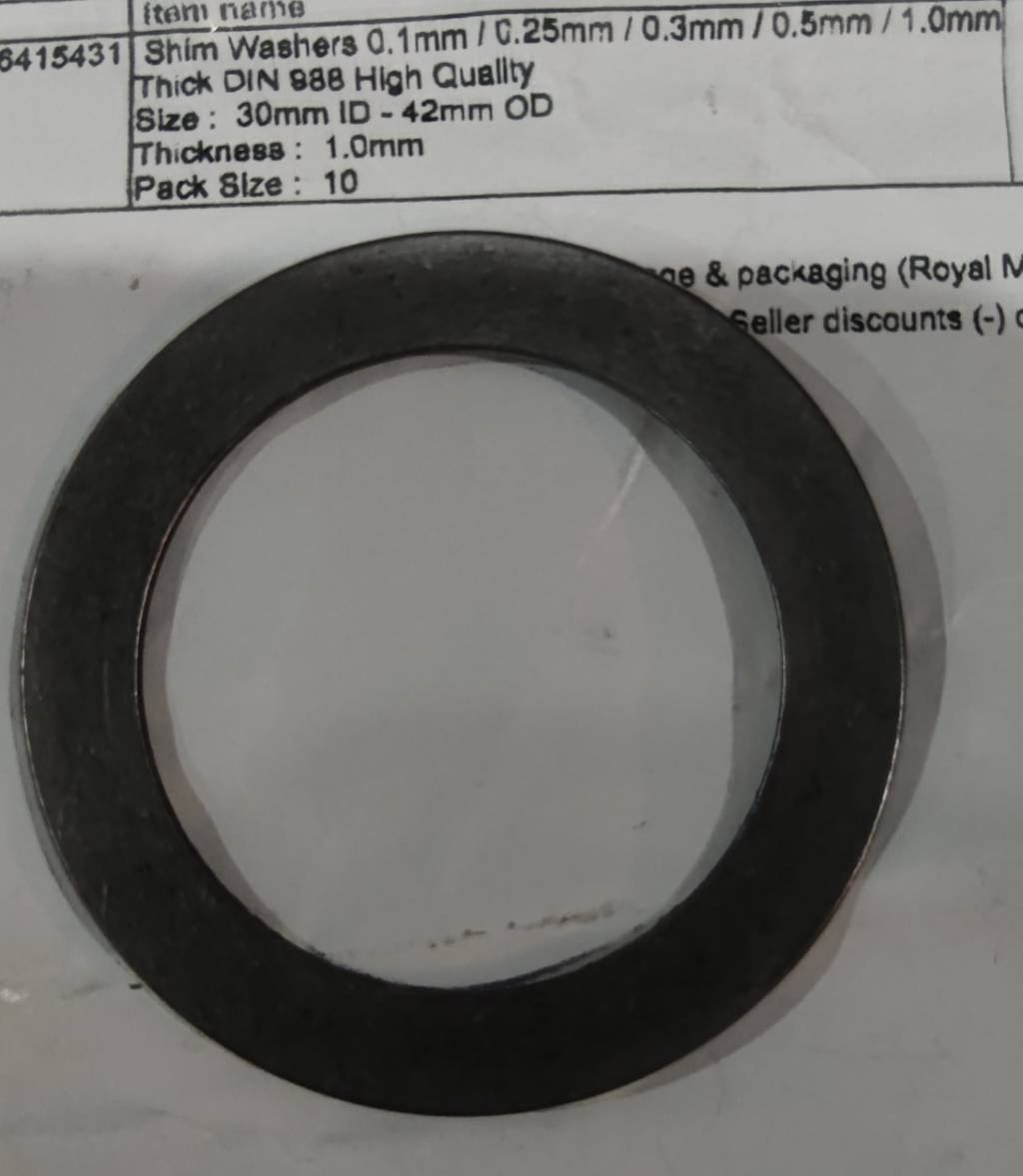

Just went to clean chain and noticed the chainring was wobbling looks like a problem with the offset did you use another spacer when you fitted yours ?
Slymobi
Mar 13, 2021
863
2,281
UK, Derbyshire
Ah.... I thought I just had a problem with that. Yes I had to purchase a shim washer ( 30mm ID x 42mm OD x 1mm thickness.
I bought a bag of 10 but you will only need 1 and place it inner the chainring and spacer.
So you will have working inwards...
Lock nut
Chainring
Spacer
1mm Shim washer*
Inner spacer
*If you want I can send you a couple over ( 1st class ) for free ? Obviously private message your address if you decide you want me to send you some but should be easy to source if not

Spacers arrived thanks again mate,however when i put them in order u stated as in the shim washer at back i found it was rubbing on motor and making chainring stiff to pedal but put it infront of the stock spacer not internal one and it runs smooth did u not have that problem ? 👍
Slymobi
Mar 13, 2021
863
2,281
UK, Derbyshire
No probs mate, glad you sorted it I will have to have another look cos I'm sure I placed in the order I said ! But it makes sense what you're saying. I definitely don't have any rubbing etc.

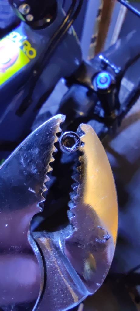

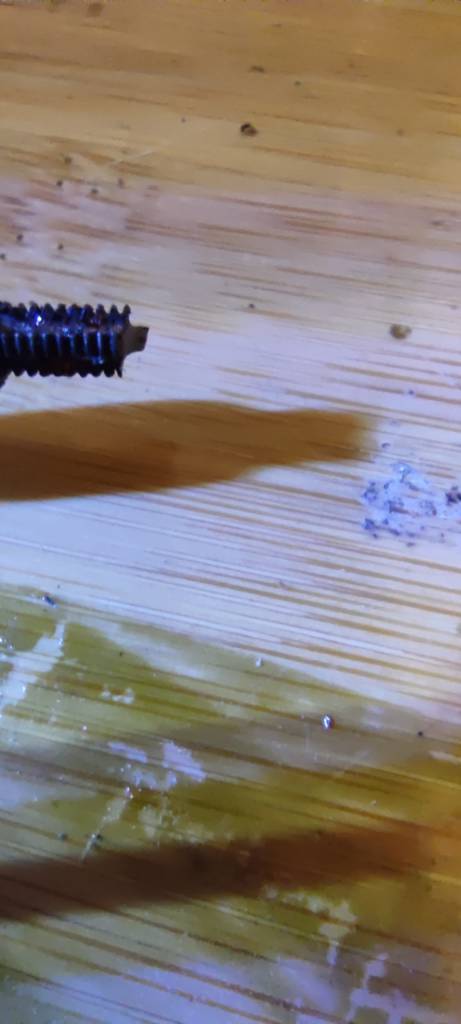

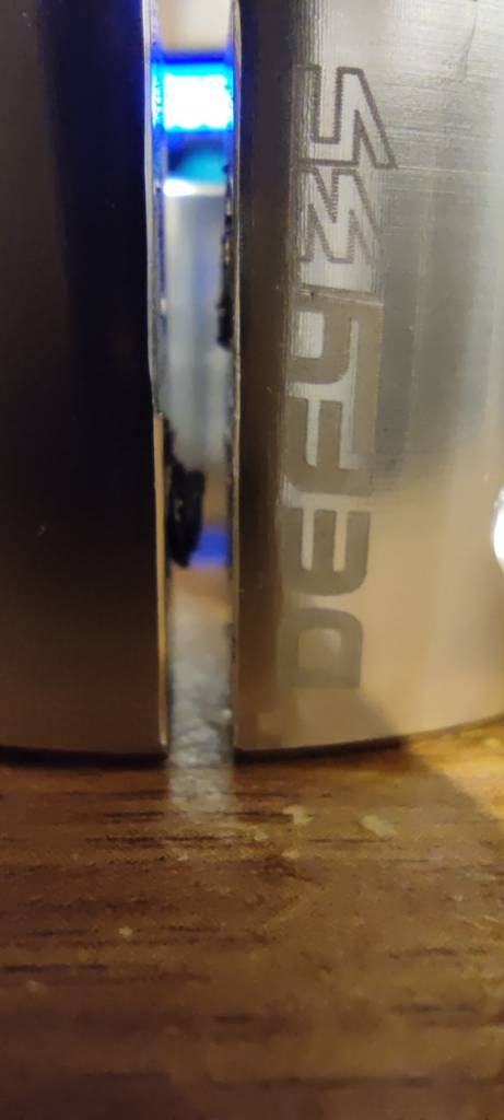

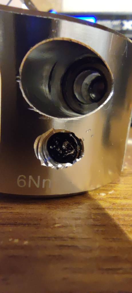

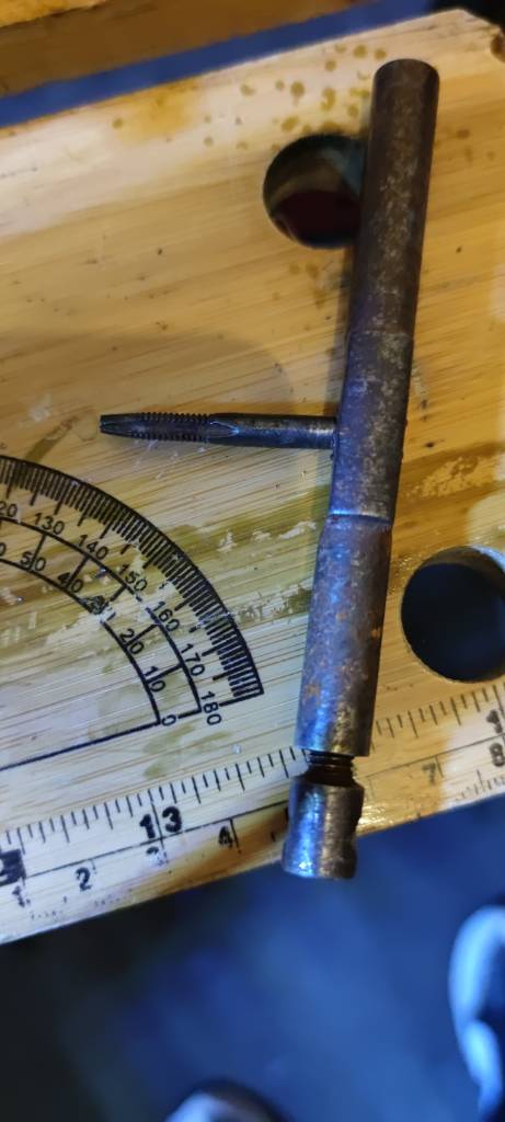

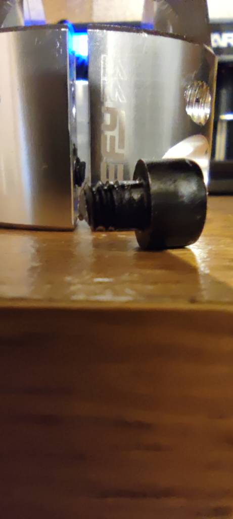

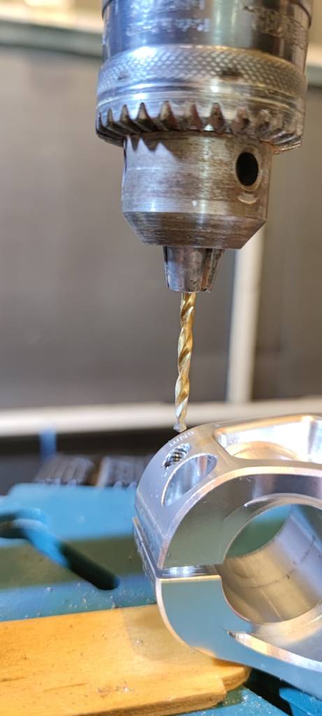

Got the broken bolt out from the Defy 35.
Titanium drill bit into broken bolt,
used a thread tap thingy to catch onto the broken bolt and began to push thread it out,
this was working until the threading bit snapped lol ( only to me !! ),
Drilled into the other end of the broken bolt, now it had a good portion of drilled hole and had worked out close enough to force a hex bit into and take the bolt out.
Bit of a bodge job but it's job done
Just need to source a new bolt now

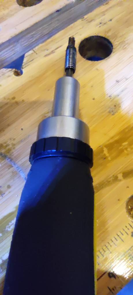

Decided to get a bit more bite up front and upgraded to a 203mm rotor.
Purchased 2 disks ( cheapish ) to see if the left over mount( 160-180 ) from previous forks would work.... Tested and could see the caliper was a wee bit low, added a washer to each side and re-tested...
That's much better aligned and hopefully will do the job
Still needs a bit more bedding I think but the initial testing was good.
