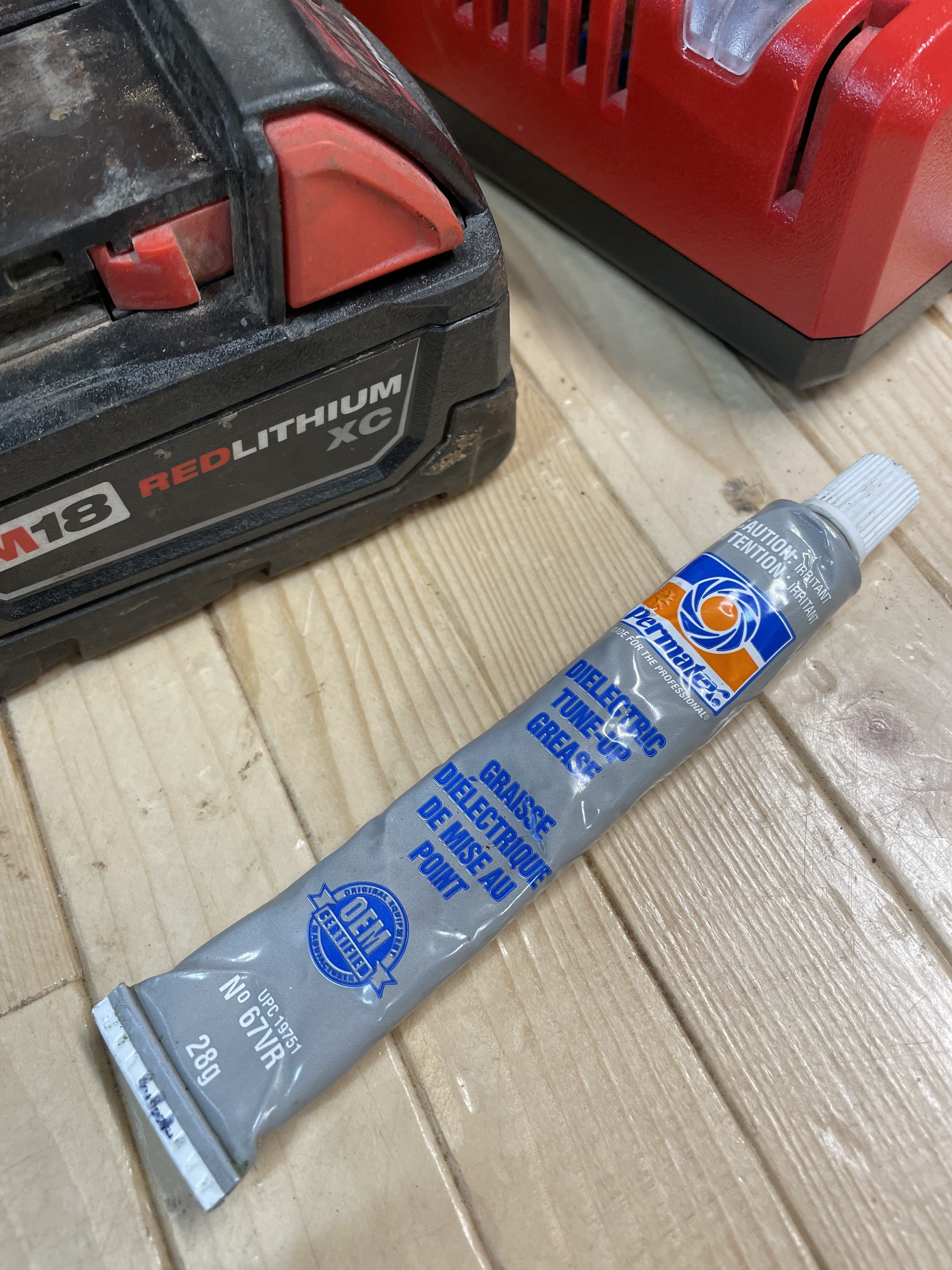

My fix was simply the battery to connector contacts. Readjusted the battery alignment and slightly adjusted for better contact. The short wiring harness seemed okay. I also use a non-conductive grease at the motor connectors (3-4?).
THIS^^^ worked for me . Applied dielectric grease to the connectors between the battery and motor and tightened the battery with a few pieces of dense rubber. I went from having shutdowns every other ride to none since applying the grease. Its been four months and I ride about three days a week in a rough rocky area. Bike is a Yamaha ydx, the fix was recommended by Yamaha.
I think vibration is your enemy here and it seems like you addressed that by adding a few pieces of dense rubber to the battery area. Also by adjusting the main power connector you’ve likely prevented a loose electrical connections. Dialectic grease only prevents moisture or corrosion from developing if applied correctly.
I can remember slopping dielectric grease around battery terminals and spark plugs (silicone dioxide properties) to prevent water ingress. If used correctly it can be very effective. F570D77C-9A19-4221-B712-B5AE41F1871D.jpeg
It is a terrible lubricant for bearings or metal to metal contact. (Not petroleum based). I use it to repel water only.
I can remember slopping dielectric grease around battery terminals and spark plugs (silicone dioxide properties) to prevent water ingress. If used correctly it can be very effective. View attachment 101313
Not sure why you would doubt the recommendation from a company with Yamahas' reputation. I tried the dense rubber pads first before getting the dielectric grease recommendation.
The rubber helped but I still had frequent shutdowns.
An engineer friend of mine explained that dielectric grease does more than repelling moisture. It also prevents carbon build up between moving "dry" connector prongs, and that carbon buildup can cause the shutdowns. I think he's correct because prior to trying the grease I could clean the connectors with parts cleaner and get a ride without shutdowns. However I couldnt get two rides due to the carbon build up.
I agree. A poor electrical connections can be problematic. My experience with EBIKE’s is extremely minimal when compared to the engineers at Yamaha. But I know what worked for me. When used correctly dialectic grease can be very useful.
