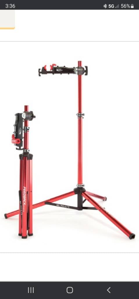

Why not use a feedback sports stand? When not riding just hang the bike by the nose of the seat over the stand.
I have a dodgy back, and generally avoid lifting. When I need to put one of the eMTBs in my work stand I have a small ceiling mounted electric hoist I use.
The bike stand would be mostly used for storage. I've tried "roll-in" bike stands, but they don't hold the bike very securely at all.

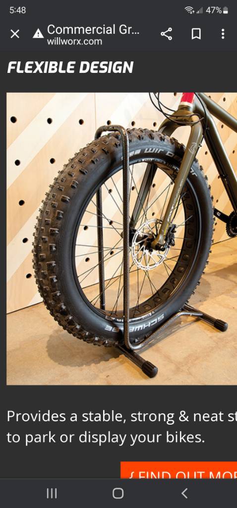

Is this the willworx stand? Does it require a push with the foot when one pulls the bike out? Seems like the stand would cone with you and the bike.

That's the one, it comes in different sizes for different width tyres. I got the superstand 12 to 29" which is supposed to be suitable for up to 2.5" tyres My 2.4" front tyre goes in and out without the stand moving at all.
My wife's Levo has a 2.6" front tyre so that is a bit tighter. The easiest way to get that out with minimum effort is to stand in front of the bike, place a foot on the base of the stand and push the handlebars back.

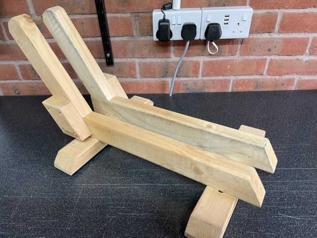

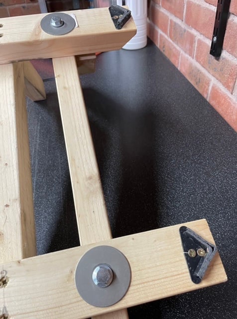

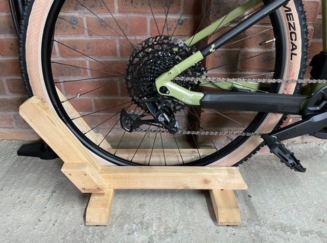

If you want a motorcycle style stand I’m sure a local engineering place could make you one, or modify a motorcycle one to fit your bike. Doubt it would be cheap, but would last you forever!
I don’t need a “lifting” stand, just a storage stand so I made my own out of timber wall studding. Really stable and the bike rolls in and out easily. Adjustable width too if I decide to fit wider tyres (the silver bolts underneath slide in a 1” slot).

I made a couple similar - a bit rougher than yours out of some old pallets but put 3 cheap small castor wheels under them & they're brilliant as you can move the whole bike around the garage & not have to find somewhere to lean the bike around.
