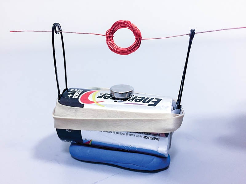

The only motor I know that is fully serviceable is the one I made in a physics lesson all those years ago
