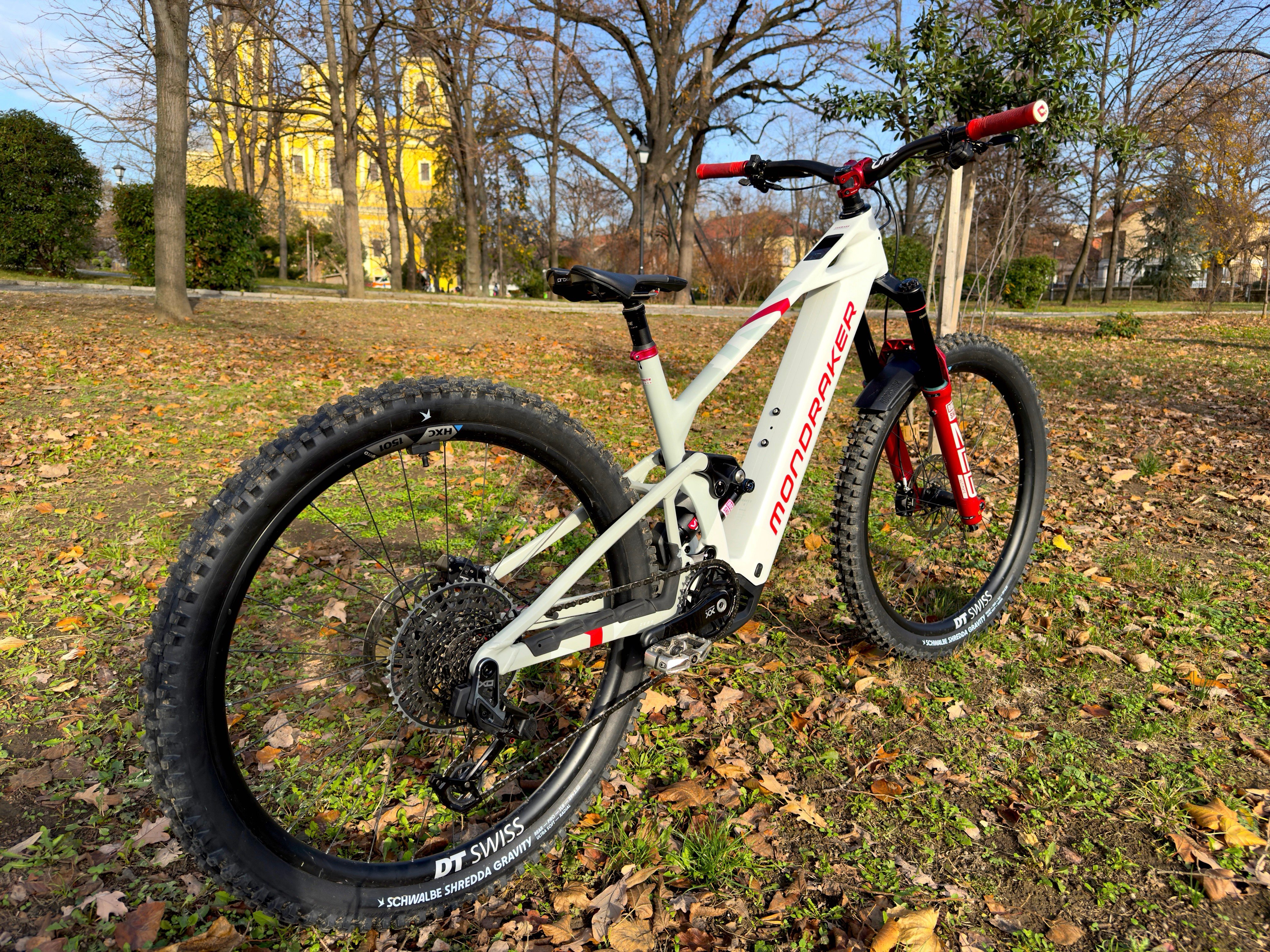

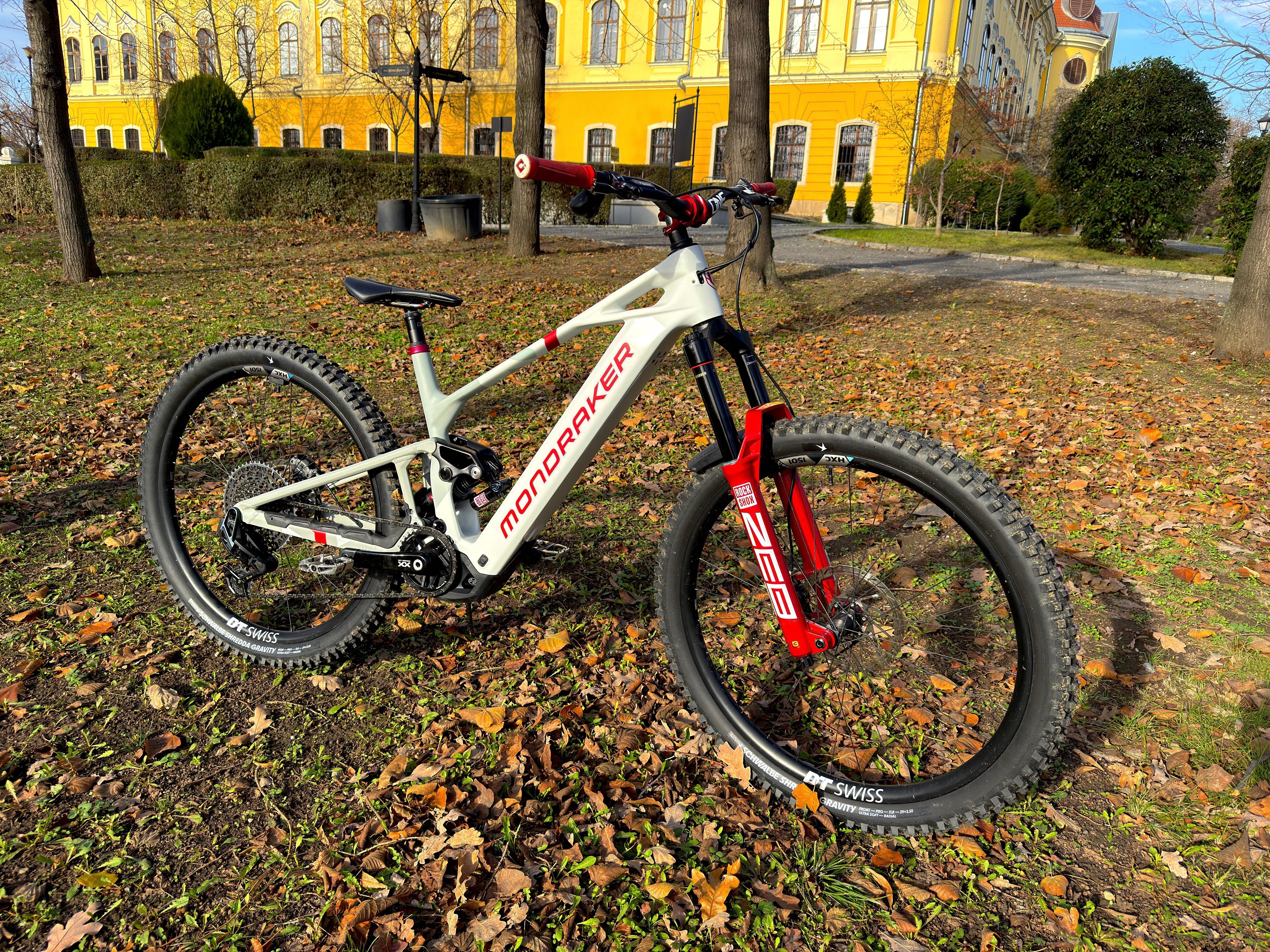

Hi guys.
So since spring I've modded my stock Crafty 2025 to a point that only the rear triangle is still stock. So I'm 99% done :D
I'm listing here below all parts replaced (also the weights) :
Vivid Air Shock : 652 grams
Zeb Ultimate 3.1 170 mm : 2382 grams
Saddle : Prolongo Proxim W450 Sport 145 - 269gr
Dropper : One Up V3 - 180 mm 31.6 480 gr
Bars : One Up V1 :35 - 35 mm rise cut to 780 : 234 grams
Stem : RACE FACE Stem Turbine R 35 0° | 40 mm - 130 grams
Grips - ODI AG2 - 105 grams
Sram XO Transimision - 1183 grams
Sram XX Cranks 165 : 360 grams
Woolftooth Alloy Chainring 34 - 95 grams
Maven Silver : 758 grams
Maven HS2 200 Discs : 510 grams
(summer tyres)
Magic Mary Front Gravity Ultra Soft : 1393 grams
Alber Gravity Soft : 1270 grams
(winter tyres)
Shredda Front & Rear - Gravity Ultra Soft - 1523 & 1585 grams
Mallet E LS Pedals : 441 grams
Cane Creek Hellbender headset
Schwalbe Click-Valves
3D printed Click-valves adaptor under the seat
JM Graphics custom stickers.
Kiox 400c
Weight with winter tyres and 600wh battery - 23.54 kg , with summer 23.04 kg . Size ML
My new crafty rr weighs 26kg with winter tyres and tubeless.
Besides the Mavens and heavy tyres parts used were towards the lighter side but still durable
Wow, Bogdan_CH, your modding skills on the Crafty 2025 sound impressive! It's fascinating how you've customized it to the point where only the triangle remains stock. I bet the transformation is quite remarkable. Have you noticed significant performance improvements with your modifications? I'm curious about the specific changes you made and how they've enhanced your riding experience.
Hi Charles,
Most parts were changed from day 1 (suspension, wheels, cockpit) , so can't fully relate to the stock build, but it does ride quite amazing. I can directly compare it to my Enduro bike , Pivot Firebird and it's not that far in the rought stuff. The 600wh battery is definetely noticeable for ridding jumpy trails.

Nice looking bike, but maybe I've already told you in some other forum 😄
Where did you find red "Mondraker" stickers? I'm thinking how could look mine in yellow instead of grey.
Haha , true that . You’ve blown my Italian cover 🤣
I’ve got it from JM Graphics. Really nice guys .
They even own a Crafty as well :)

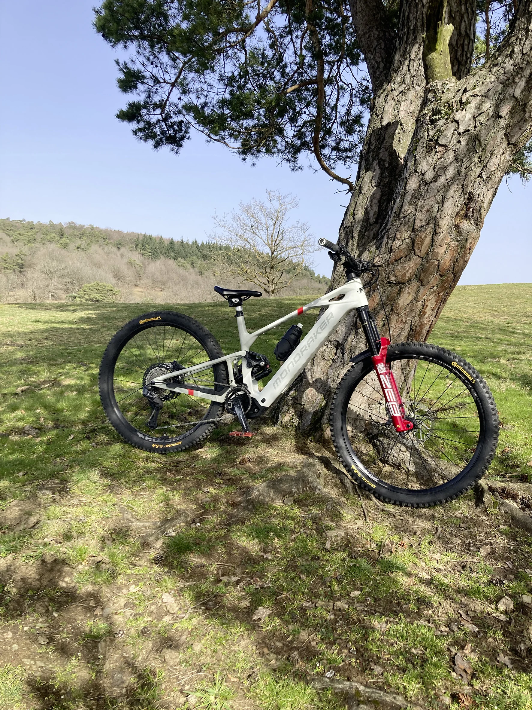

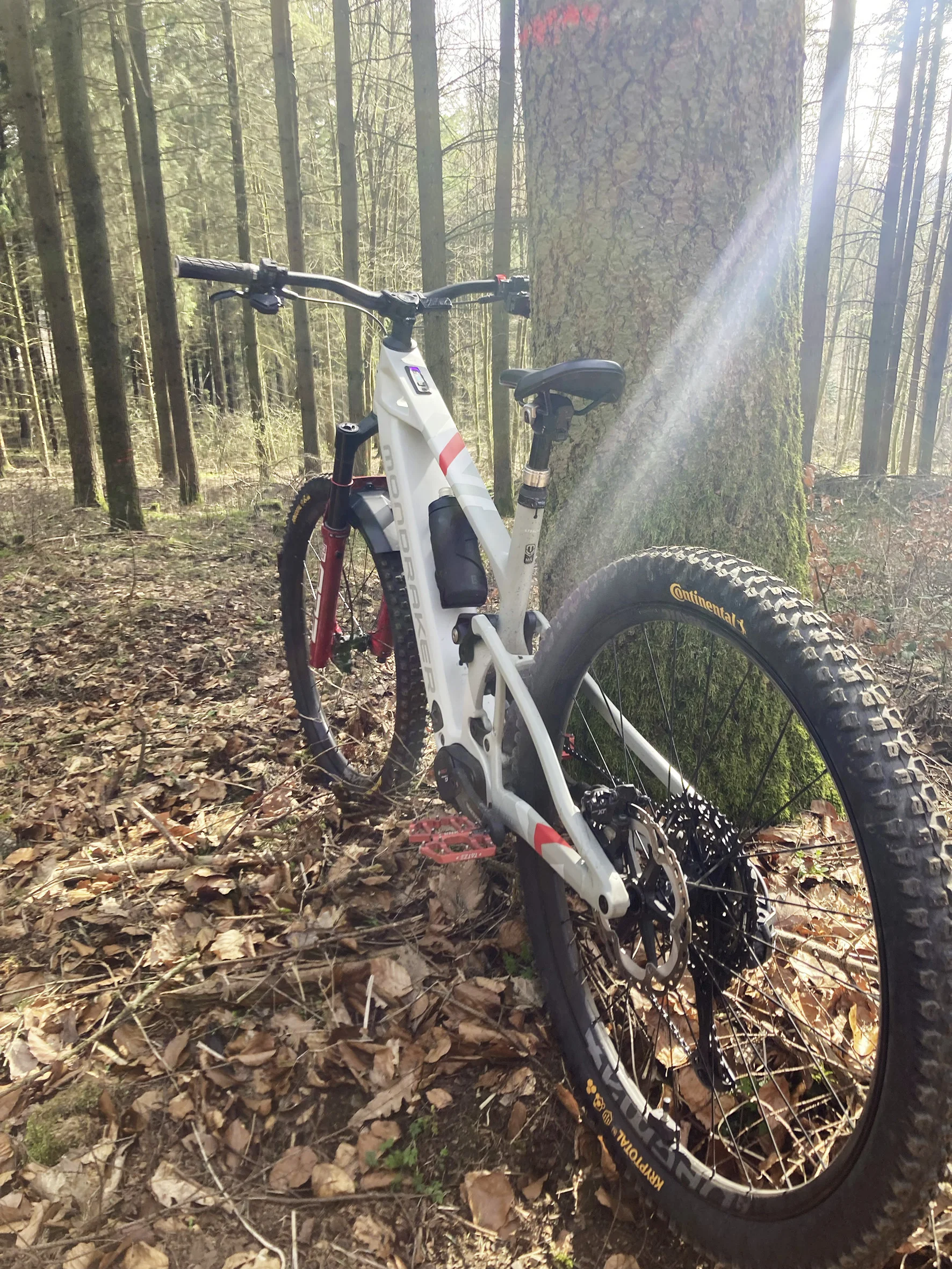

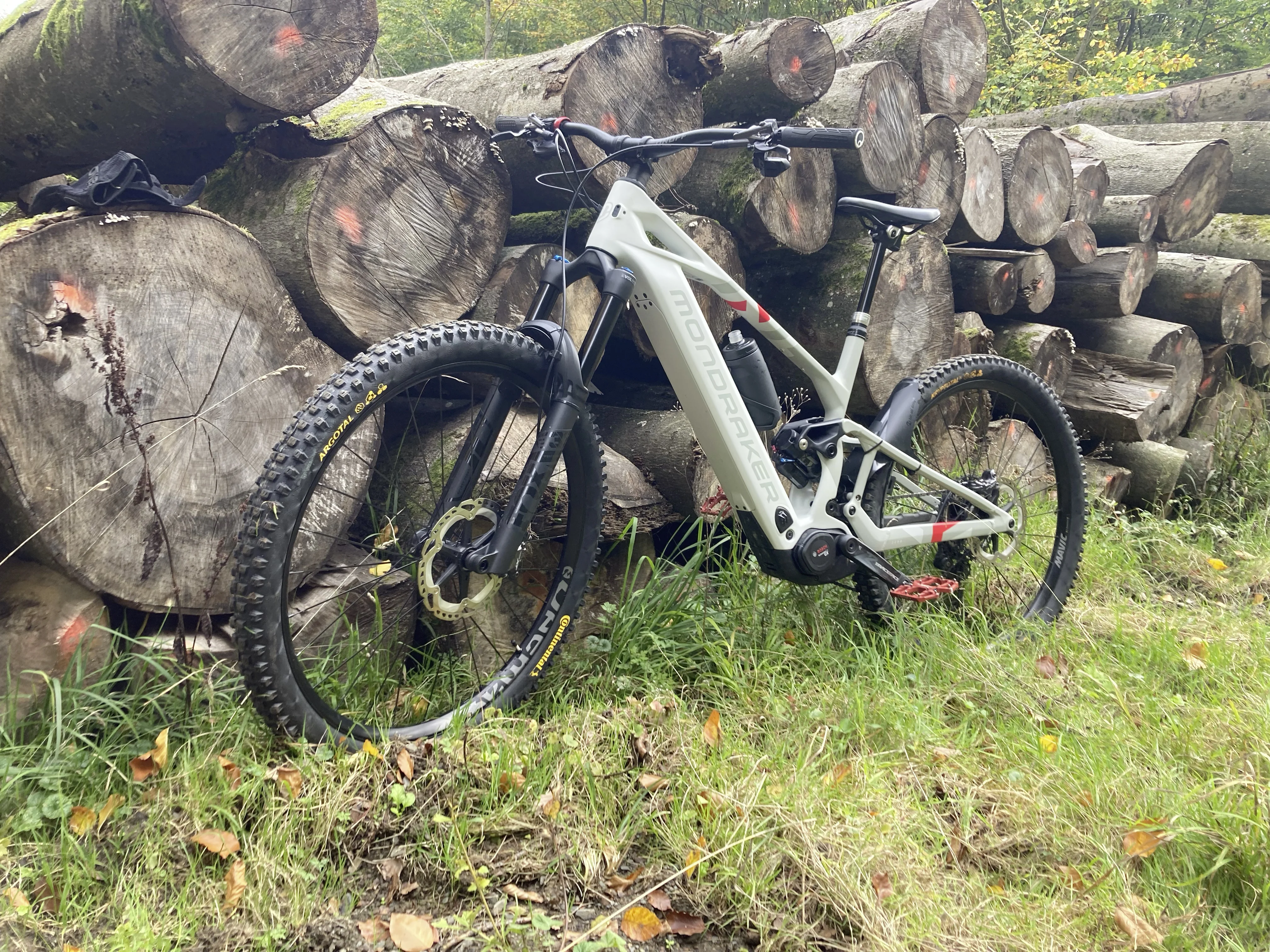

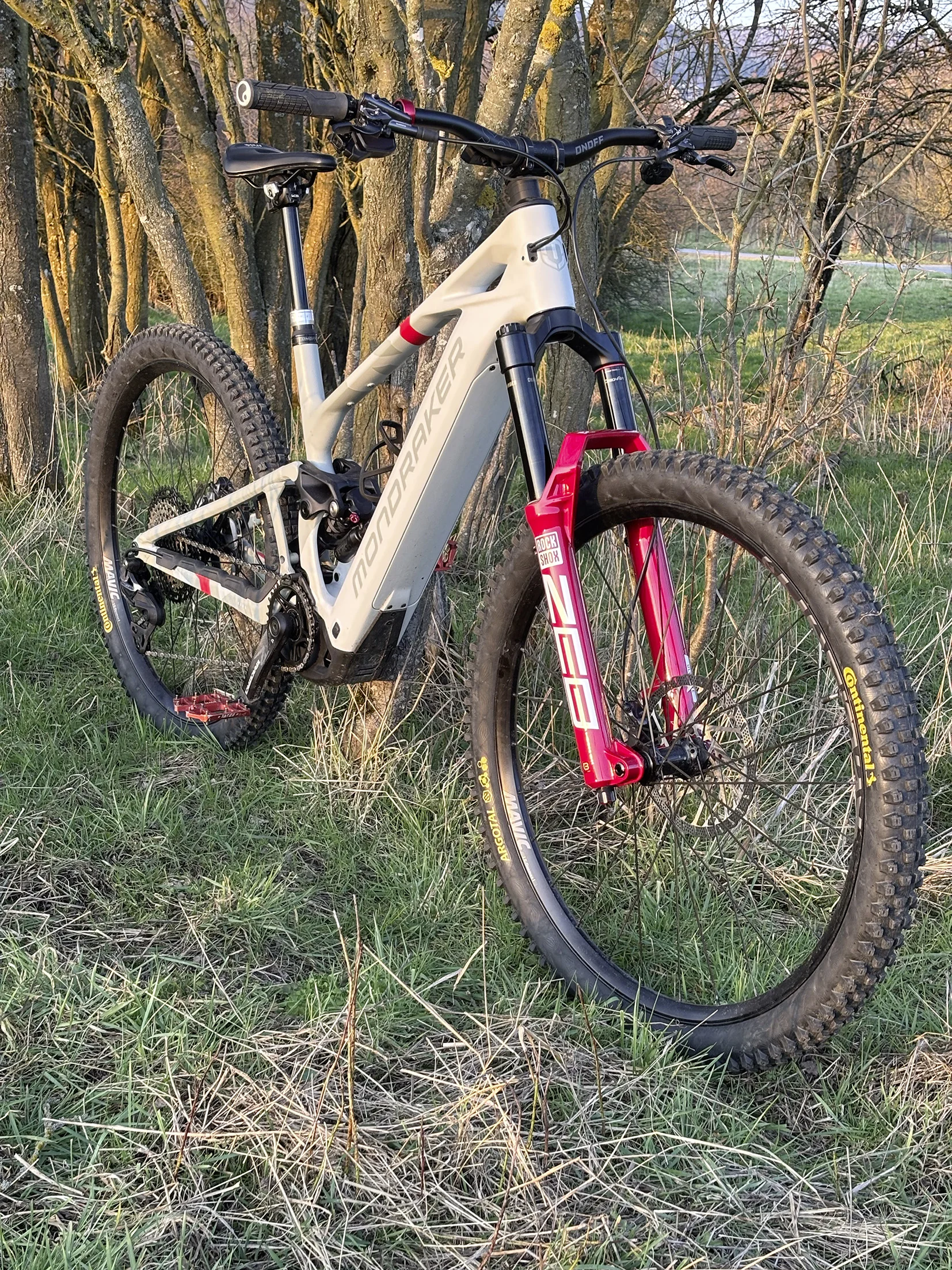

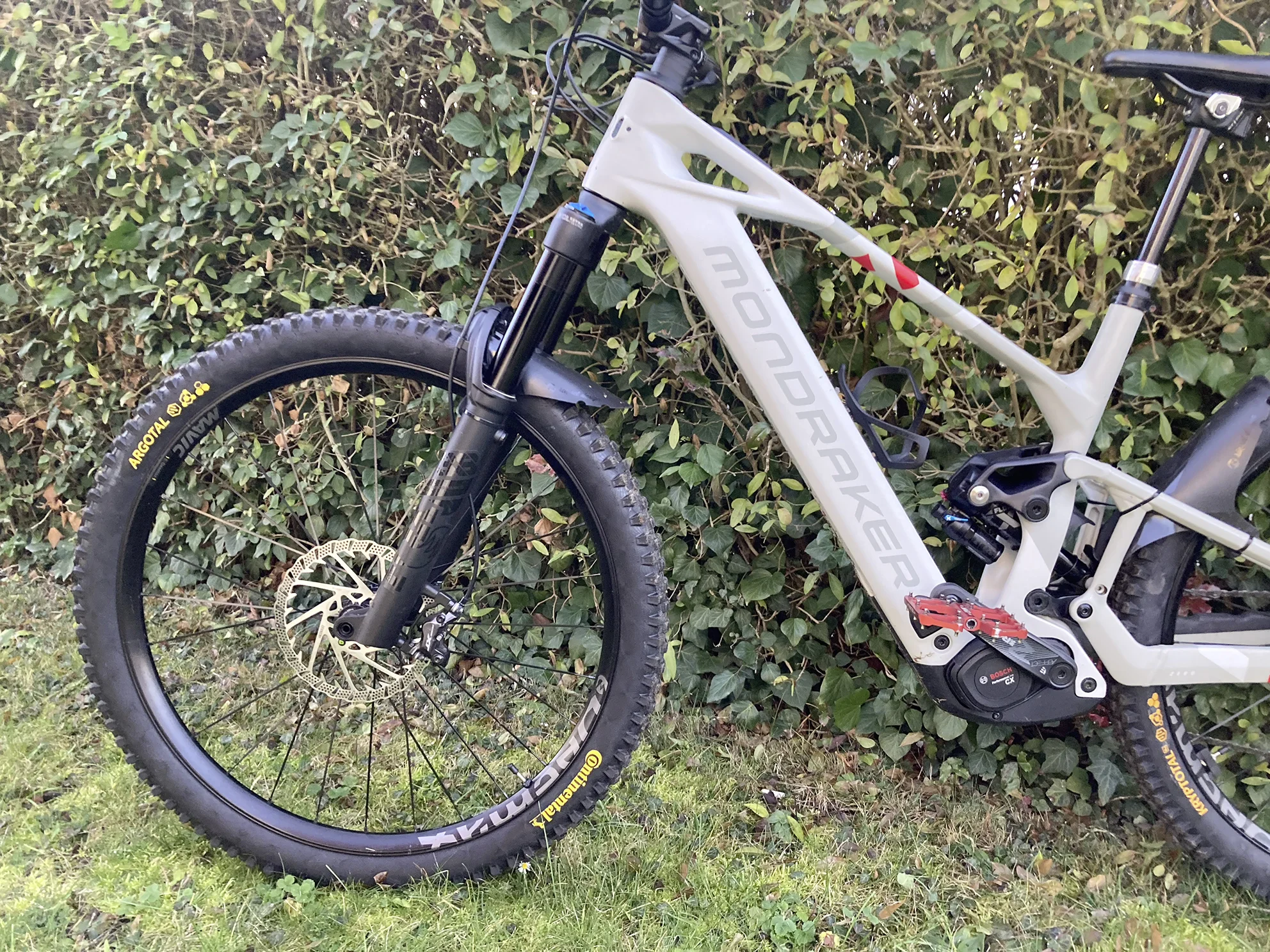

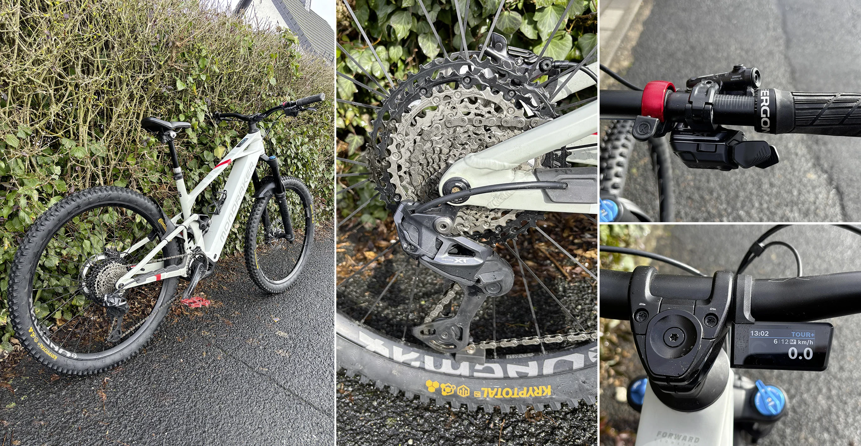

Hi guys,
this is my Mondraker Crafty R. I felt in love with this bike at first site 🥰
Modifications so far:
• Continental Kryptotal Fr Enduro S (only summer), Argotal Enduro SS/ Kryptotal Re DH S
• Tatze Link pedals
• Fizik Aidon X5 saddle
• KS Rage Circuit dropper post
• Front brake update to Galfer Shark/Sinter Green (Rear Brake will follow as soon as needed)
Recent Update last week: Shimano XT Di2 Upgrade Kit (8260) providing freeshift 😍 and autoshift 🤪
Only two Updates left (in my opinion):
I just ordered a RS Zeb ultimate red fork (160mm) and a RS super deluxe ultimate shock, will be installed asap. I‘ll keep the Fox suspension which works quite fine after servicing as a Backup suspension, just in case 😬
Greetings from germany,
Stefan

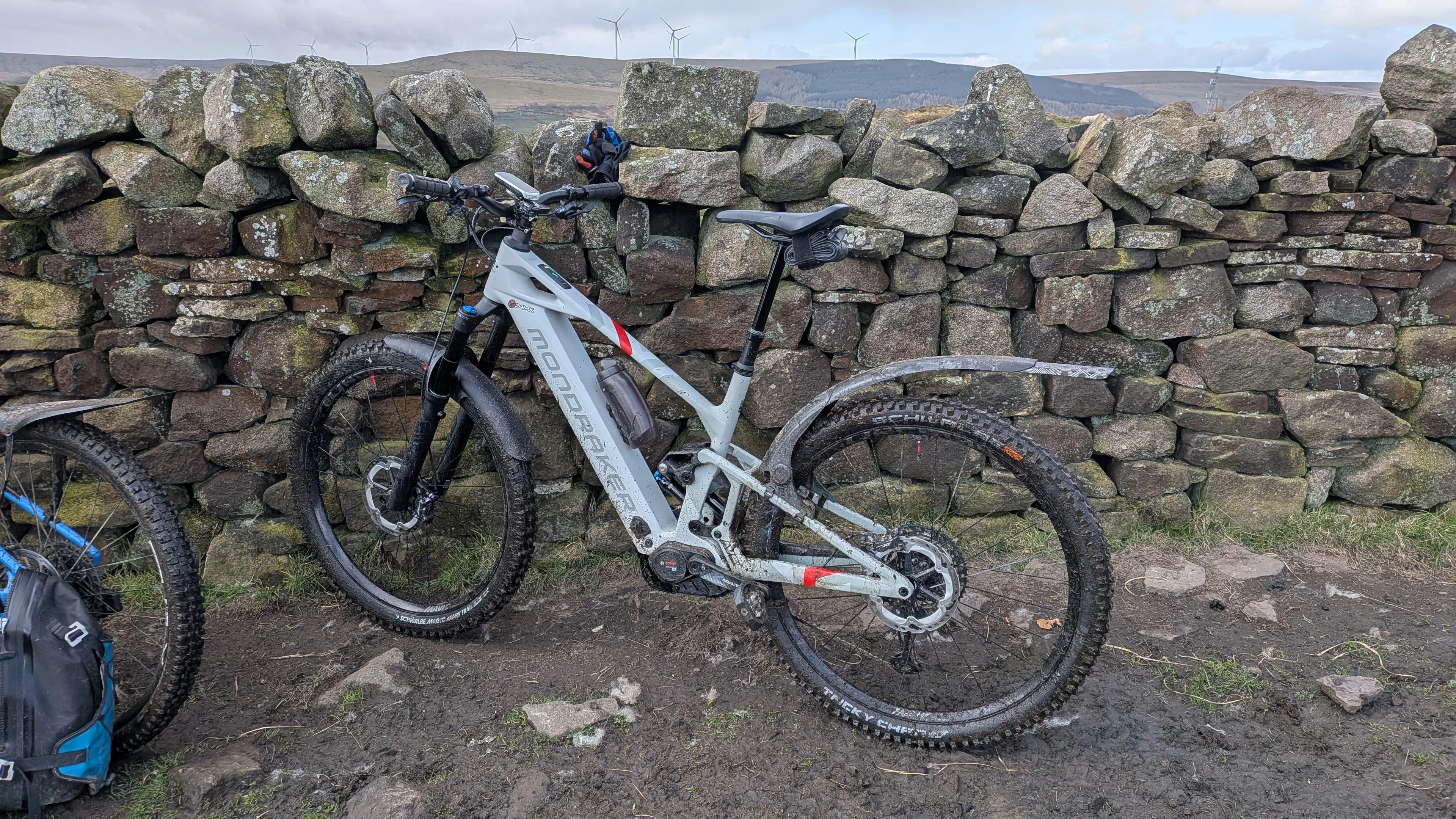

My name is Bond.... James Bond, and this is my "Mondraker"! Super Kool Blade!
I've made a few small changes to my 2025 Crafty
. Changed the stem to a 40mm Renthal Apex and cut down the bars
. Changed the dropper lever to a ispec Shimano XTR
. Swapped the tyres to Magic Mary radial/Tacky Chan combo
. Changed the plastic motor cover for a proper alloy bashguard
. Added the LSC knob to the rear shock

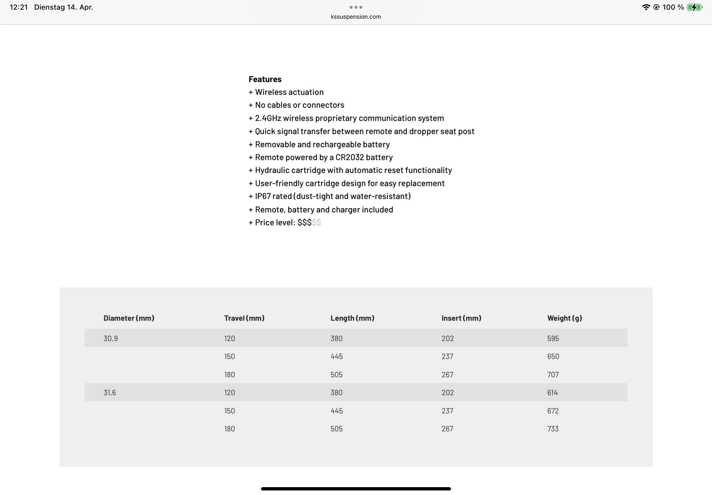

I would like a 200mm dropper but i'm not sure that there's enough insertion depth
What is the frame size of your Crafty?
I‘m with the 150mm Rage circuit which fits completely into the m/l frame despite Mondraker claims that it won’t fit (237 vs. 235 mm Insertion length) - but it does 🤗
These are Mondrakers specifications for the recommrned Insertion lengths of the 2025er Crafty:
M: 215 mm
ML: 235 mm
L: 255 mm
XL: 275 mm
KS Insertion lengths of the KS Rage Circuit:
Rockshox AXS Reverb Insertion lengths:
100 mm~ 185 mm~ 337 mm~ 35 mm
125 mm~ 210 mm~ 387 mm~ 35 mm
150 mm~ 235 mm~ 437 mm~ 35 mm
175 mm~ 261 mm~ 487 mm~ 35 mm
200 mm~ 285 mm - 290 mm~ 537 mm~ 35 mm
225 mm~ 310 mm - 311 mm~ 587 mm~ 35 mm
250 mm~ 335 mm - 346 mm~ 637 mm
OneUp Dropper Post V3 Insertion lengths:
90 mm~ 170 mm295 mm
120 mm~ 200 mm355 mm
150 mm~ 235 mm415 mm
180 mm~ 265 mm475 mm
210 mm~ 305 mm545 mm
240 mm~ 335 mm615 mm

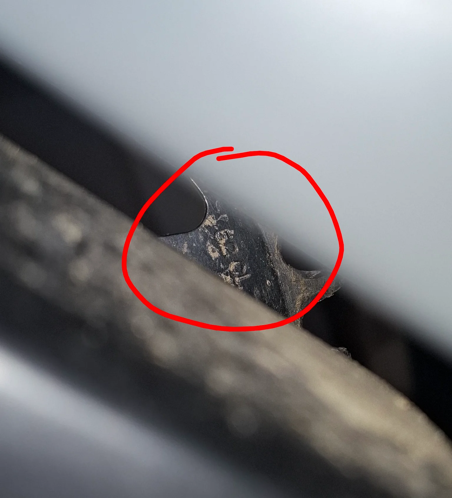

Hello, anybody knows which chainline has Crafty carbon R OEM Raceface direct mount 34t chainring?
52mm or 55?
I can't find this info anywhere.
Thanks.
