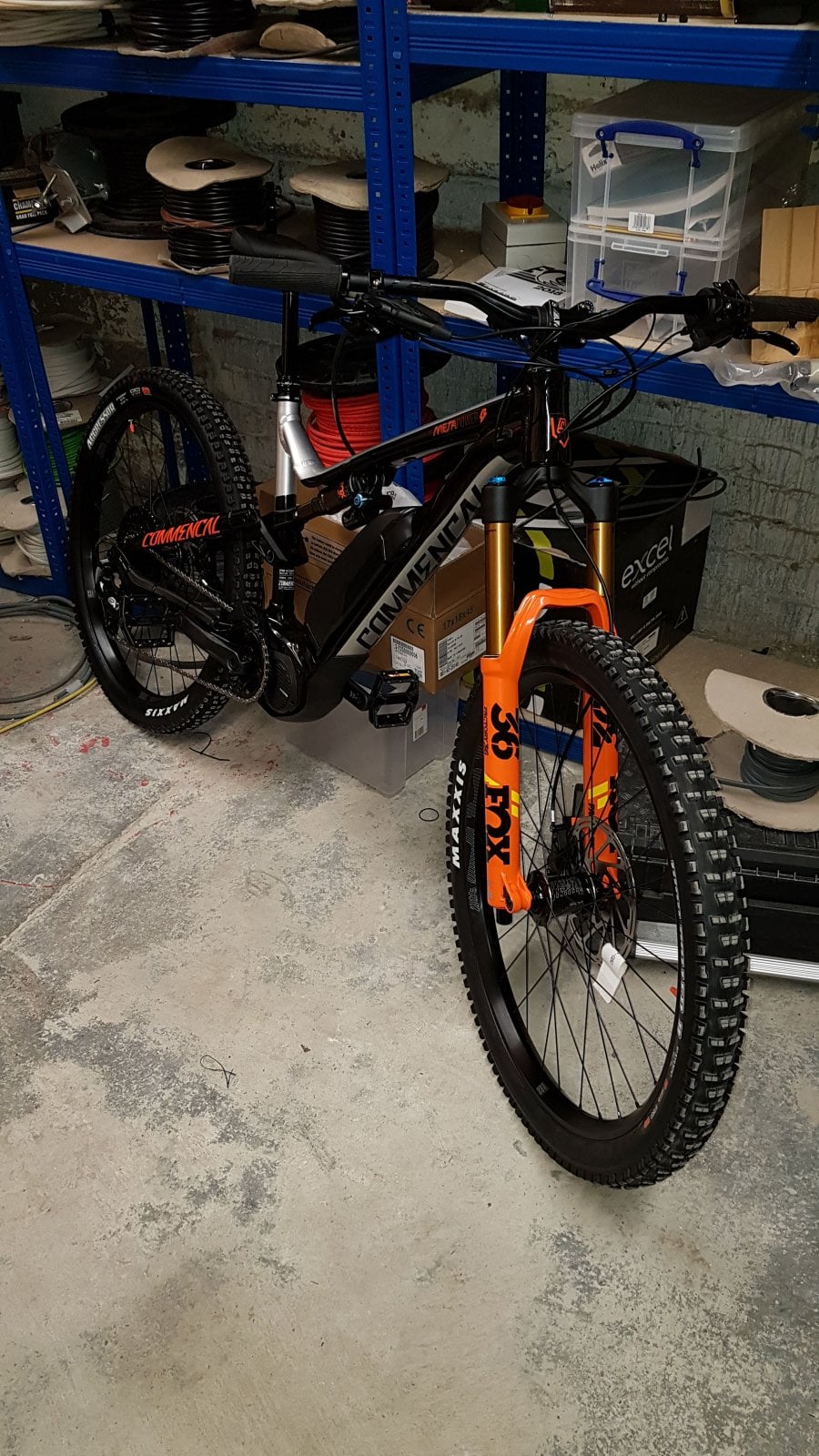

mines just landed today. Ordered last fri. Can't wait to get it set up properly and get off on it
