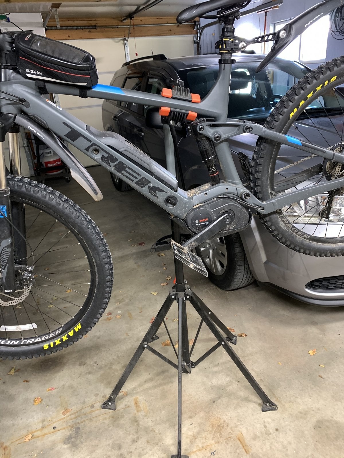

I got this stand from Aldi’s grocery store probably 4 years or more ago for about $30 and before I got my e bike. Works fine with my 60+ lbs bike on it. If your taking off wheels or other stuff you might need to readjust the balance point at times. In the picture I don’t even have the stand legs all the way out.

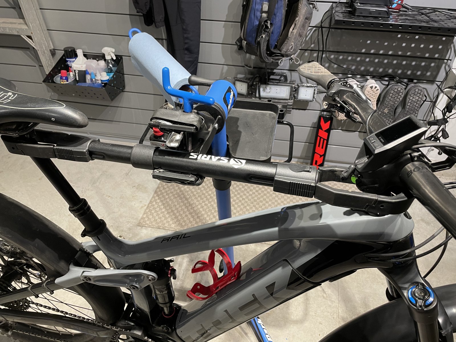

This method has probably been shown or described before but this is one way I hang the carbon eMTB. I also hang from the dropper when its fully extended. I sometimes want both wheels off the floor and this allows me to raise the work stand even higher while keeping the bike level. The Saris bar is strong, can be used for car racks and attachment is quick/easy. I just hang it on the tool caddy to keep it close by. ($55cdn). I only use it 40% of the time but it’s right there if I need it.
