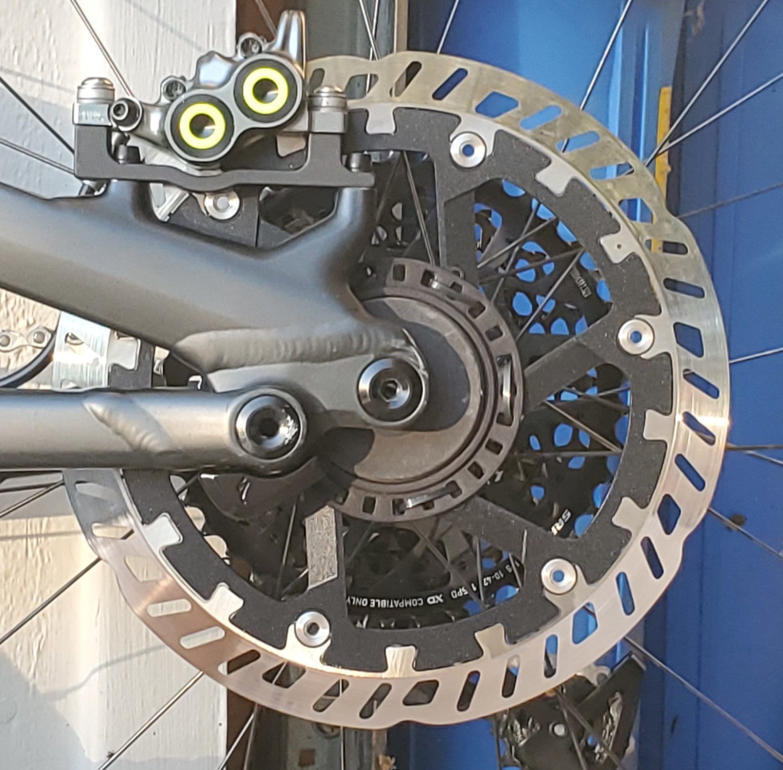

I've done MT7s with 220 ebike rotors front and rear. Very happy with the results. My local trails have long, steep descents that are shared with hikers (and their kids and dogs). The SRAMs weren't up to the task and would be howling hot when I reached the bottom.

My MT7 + MDR-P setup requires proper bedding to be silent. When the pads and rotors are properly bedded, there is no noise. The bedding process is a price I am happy to pay to get the amazing stopping power of these brakes.

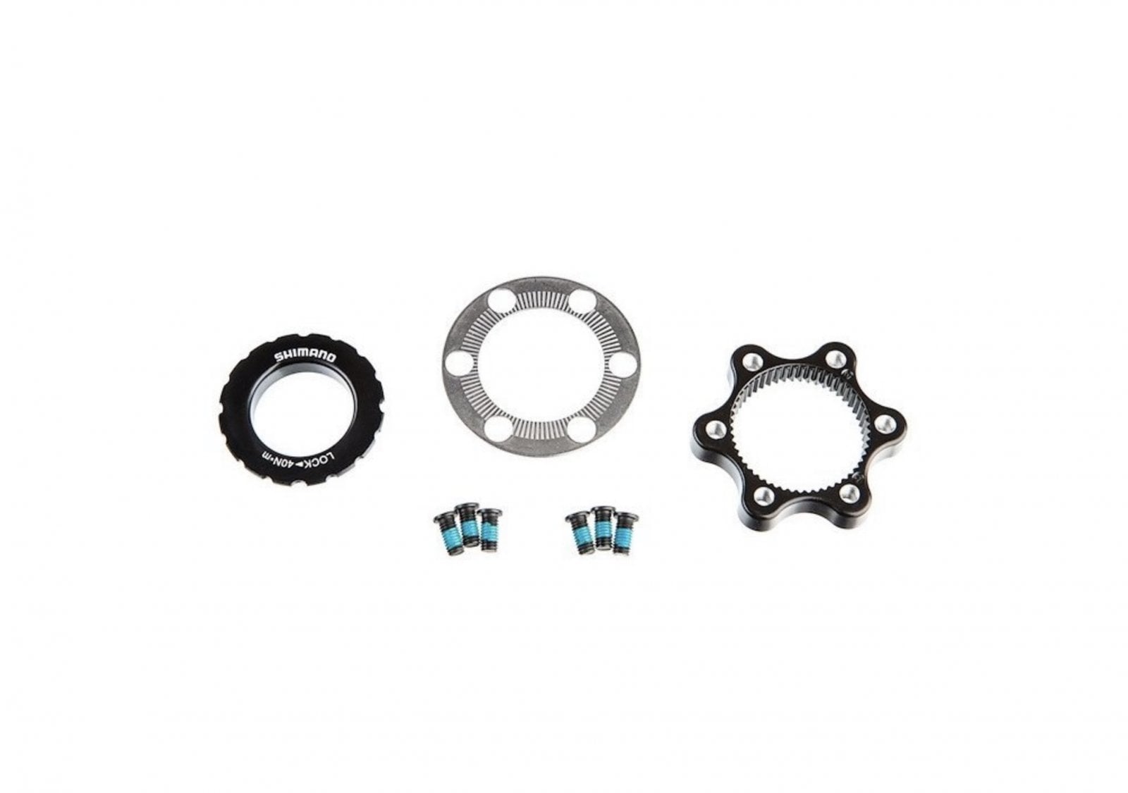

Seems i need this to make it work on a 21’ Levo
Magura advise specific against to use a adapter whit these discs
Any experience whit this?
I pretty sure all levo's are 6 bolt hubs, can't say for certain. Maybe the shimano spec'd models.....
Magura does have centerlock rotors, but they only go up to 160 or 180. However, you don't have to match rotor/caliper brand, but it is recommended as it may require a shim or two.

AFAIK all Shimano drivetrain 2021 Levos have centerlock hubs.
All good with my question on your other post answered now cheers. I have the sram level ts and they just don’t quite cope. I have been told to upgrade to the codes but I just can’t steer away from the MT7s with 220s.

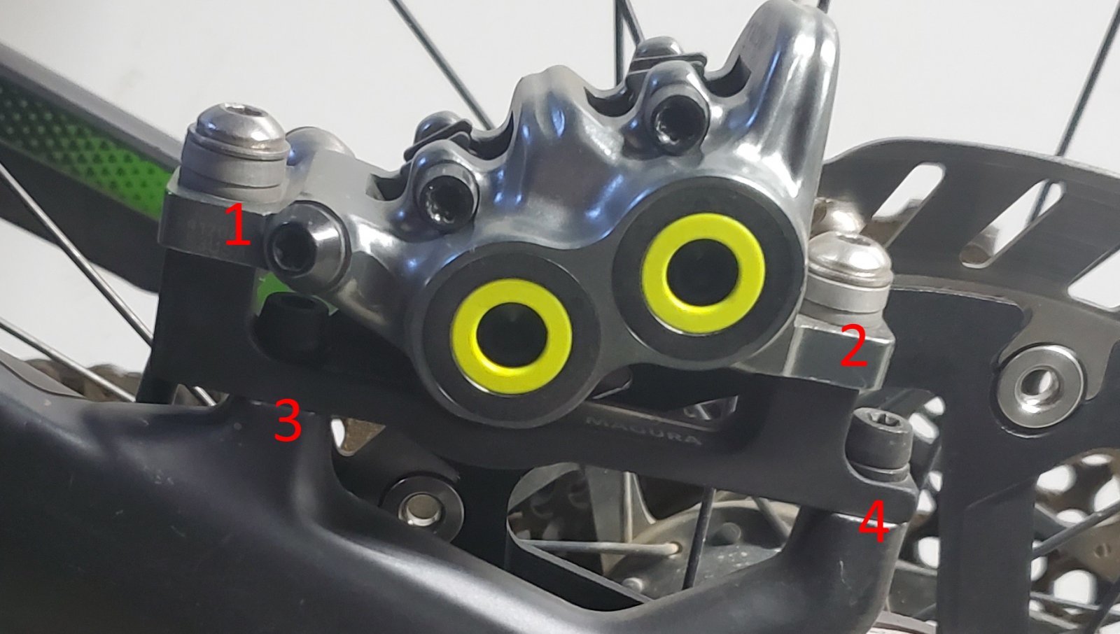

You'll need:
2 MDR-P Rotors 220mm
2 QM45 adapters
2 MT7 Pro brake sets
I bought this bleed kit from Amazon, but I see it's "currently unavailable", at least in the US.
You'll also need 4 more bolts for the calipers because Magura uses 2 bolts to attach each QM45 adapter to the bike, and 2 more bolts to attach the caliper to the adapter. SRAM uses the same bolts to attach caliper to the adapter and the adapter to the bike, which means those bolts will be too long for the Magura setup. If memory serves, Magura includes caliper to adapter bolts with the MT7 kit, but not adapter to bike bolts.

You need a total of 8 bolts to do both front and rear brakes. Magura supplies 2 bolts per MT7 kit, so that is 4 of the 8 you need. You can't use the 4 bolts from your SRAM brakes because they are too long. This means you need to get your hands on 4 more bolts.

Bumping this thread as I have the same question. I have a 2021 Levo Comp with the stock centerlock hubs and would like to go to 220mm rotors but cannot find 220mm centerlock rotors anywhere. Does anyone know why Magura warns against using an adapter to fit their rotors to centerlock hubs? Is it advisable to not do it with with other 220mm rotors, or just a Magura thing?
A lot of centerlock rotors do not even look like they were designed around the centerlock interface, but that the manufacturer simply took a 6-bolt rotor and bolted on an adapter, which leads me to conclude an adapter would be fine. Check out SRAM for example:
